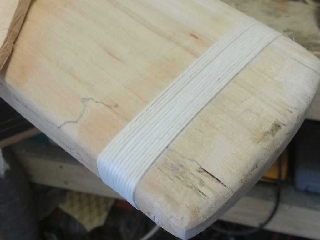

The wooden dowel works by holding the two pieces together and stopping the crack from getting any bigger. You basically drill a hole into the lowest point and then pour glue down the hole before hammering in the dowel. leave to dry then trim and sand.
Something like this...
Ryan

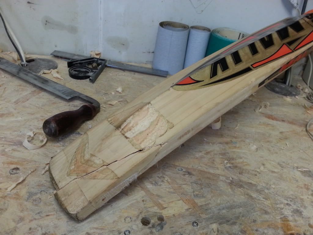

« Reply #6 on: July 05, 2013, 01:06:09 PM »
and the shoulder would look something like this.
