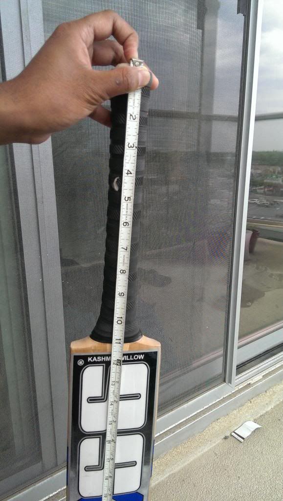

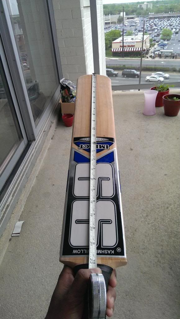

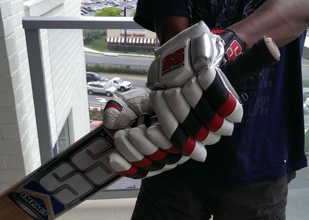

I have relatively smaller hands. The handle in the Kashmir willow that I have has handle length of 11 inch and blade length of 22 inch. I have never used this bat in practice or match as it is a dud but it feels quite right in my hands. I have posted a few pics here. I grip the bat at the very bottom and there is only a very small gap between my hands. Any suggestion on which handle I should go for ?

A thicker oval handle would aid you from gripping the bat that low. Sehwag, If I remember correctly saws off the handle and it looks like your grip is similar to his.
