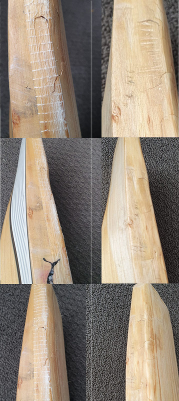

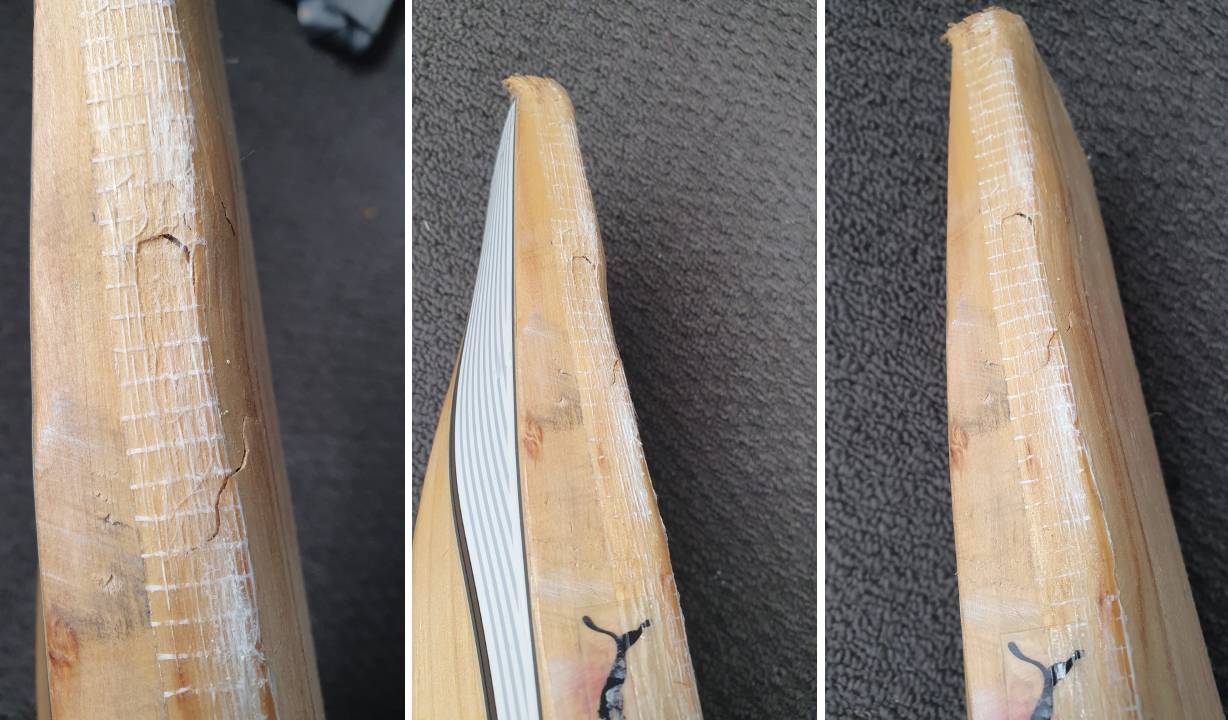

Hi there... bat lover and amateur bat repairer (been doing minor repairs and refurbishments for my teammates and club in Australia)
I wanted your thoughts and ideas on how to best repair what I think is a common way edges get damaged.
I'm talking about when a newish ball hits an edge flush and makes a dent plus cracks.
I don't want to start until I'm sure as I haven't had to do one of these yet, maybe some of you have?
Things I'm considering:
  • Steaming the dent out before gluing and sanding
  • Compressing the area around the dent so its more even, then gluing and sanding
  • Making a paste out of sawdust and PVA glue to apply to the dent, then sanding down
See pictures attached.

Thanks guys, helpful tips. Steaming did the trick. See after pictures below. I'm going to buy a pack of syringes. Assuming the PVA glue needs some diluting to use with the syringes.
Before on the left, after repair on the right.
« Last Edit: October 02, 2021, 10:49:33 AM by webmack »
