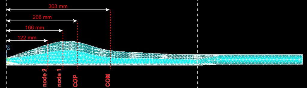

In case you're interested, I had a quick go at seeing how such a weird shape compares to other, more traditional shapes. It's not spot on, as I just had to go off your photo and specs, but the modelled weight came out at 2 lbs 5 oz, which isn't too far off.
This is the model shape, with the main vibration points marked on. I think that the shape isn't too far off the real one, although the area into the toe could do with being a bit smaller perhaps (also would reduce weight a little).

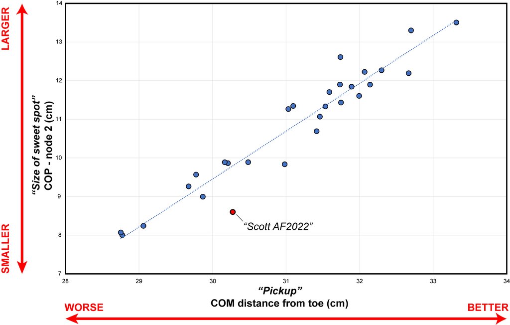

And in case you want to know how it compares to other bats, here's a graph (sorry everyone!) of some other real bats that I've modelled, and some theoretical ones. Basically, what it shows is that this bat has one of the smallest sweet spot areas of any bat (the only ones lower are the theoretical ones predicted by artificial intelligence), and pretty terrible pickup. Which I think is what you said it feels like, so that's reassuring!

Interesting. This pretty much backs up what was said really. The pick up isn't great and the sweet spot is tiny...so not much going for these shapes! 😂

It would be interesting if you could post pictures of the profile of bat with the largest sweet spot and best pickup vs the bat with the smallest sweet spot and worst pickup to see how they compare? Fascinating stuff really.

I think I kind of do that in another thread here, with an earlier version of the same graph (although with a related, but different parameter on the Y-axis).
http://custombats.co.uk/cbforum/index.php?topic=48259.msg785810#msg785810
Is that the sort of thing you were thinking of? If I had time I'd actually write all of this up properly, as I'm also about 3/4 of the way through measuring and analysing all B3 bats, which means I can split them into proper categories (and it's based on more accurate CAD data).
