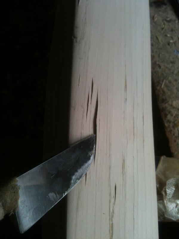

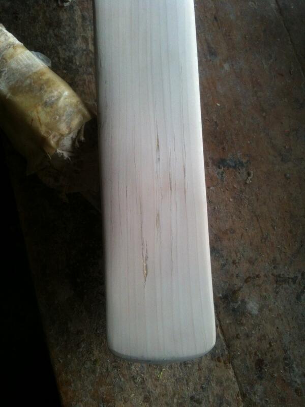

However, the majority of the time the delamination is on the face of the bat which is glued and clamped until dry - lots of tape/bat face. Think of it as a crack - my premonition is that it should be fixed the same way, so the bat will never be the same as such, but it'll be the best possible solution.
For example, GN posted some pics a while back.
Pictures taken from @TheBatWorkshop
