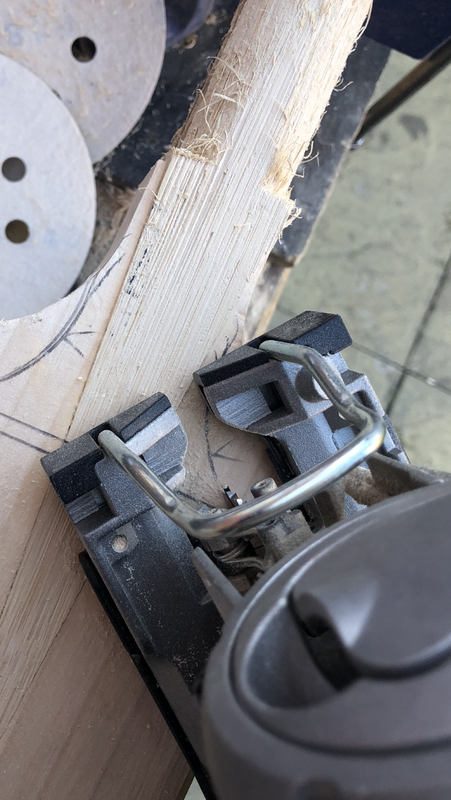

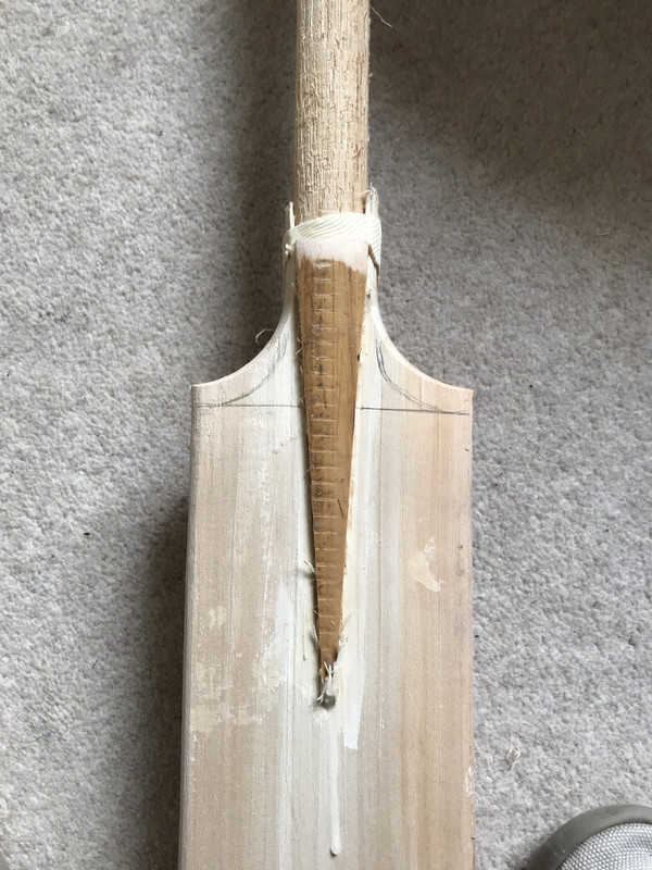

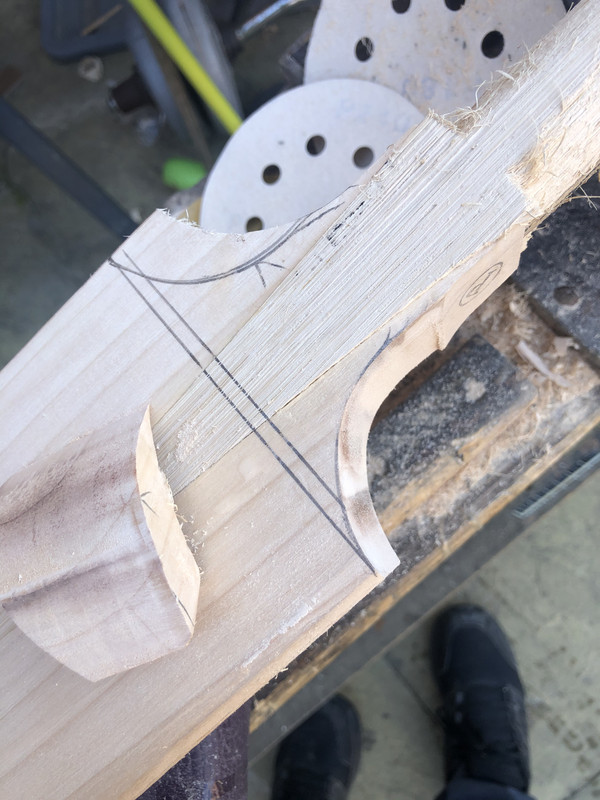

A question to the bat makers. How do you personally cut the shoulders down to the marks on the attached?
Thanks.

Spindle moulder is the best way.
Bandsaw will do if you’re accurate, coping saw will be good if you can use it properly.
Re: Shoulder work
« Reply #2 on: April 21, 2021, 08:04:33 AM »
For the home podshaver a jigsaw does the job pretty well.
e4sby
  • Posts: 1065
Re: Shoulder work
« Reply #3 on: April 21, 2021, 08:32:06 AM »
Coping saw is the way to go
Vulcan Cricket
  • Posts: 1909
Re: Shoulder work
« Reply #4 on: April 21, 2021, 09:46:32 AM »
Draw knife up side down  ;)
Re: Shoulder work
« Reply #5 on: April 21, 2021, 01:06:13 PM »
As Dean says Drawknife upside down, then a Curved spokeshave and then Sand
Re: Shoulder work
« Reply #6 on: April 21, 2021, 05:11:43 PM »
Jigsaw,,two minute job
