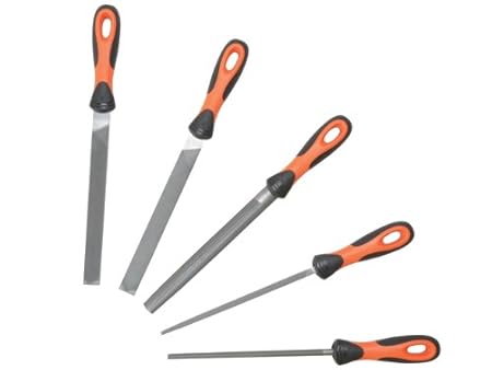

Re: A quick guide to making your first bat
« Reply #35 on: April 03, 2014, 06:41:55 PM »
Sorby - drawknife older the better
Spokes have - Stanley no 63 round and flat
Stanley hand plane no3
Rasp- bahco
No4 Travisher

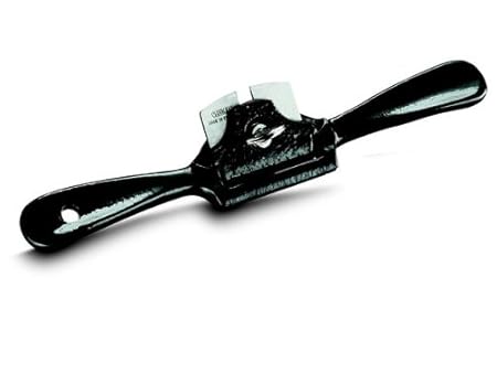

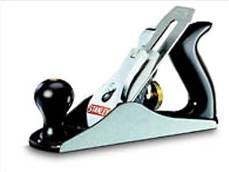

GarrettJ
  • Posts: 2512
« Reply #37 on: April 03, 2014, 07:42:31 PM »
are these the correct ones?
retired 2006
retired 2014
retired 2018
« Reply #38 on: April 03, 2014, 07:45:16 PM »
That's the spokeshave and plain I have going spare bud.

« Reply #39 on: April 04, 2014, 05:46:44 AM »
Them's the ones, Garret. No.3 planes are a wee bit smaller and lighter than No. 4's (as you might expect!) You can find them for around £20 if you keep your eyes open. Snell and Atherton heel shaves are the only tool missing on the list for me but they do the same job as travishers.
I'd agree that the older your spoke shave or drawer knife, the better. Something to do with the way steel was forged in the old days makes the blades super hard.
Another good rule of thumb when selecting planes is: The thicker the blade the better. Older, wooden planes normally have thicker irons that sail though stock and are less likely to 'chatter' as you work the timber. If you're lucky enough to find a Clifton, Lie Neilsen or Veritas plane for less than a million dollars (you won't!) then snap it up!
