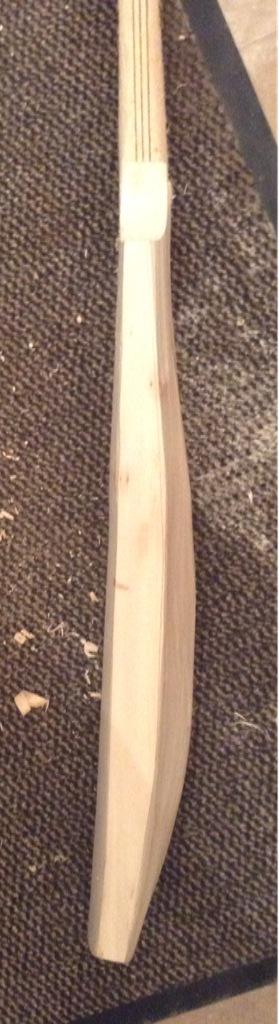

half of the bat is the untouched height of the cleft. still need to sand it andfinsih it off ready for battle

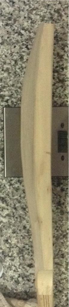

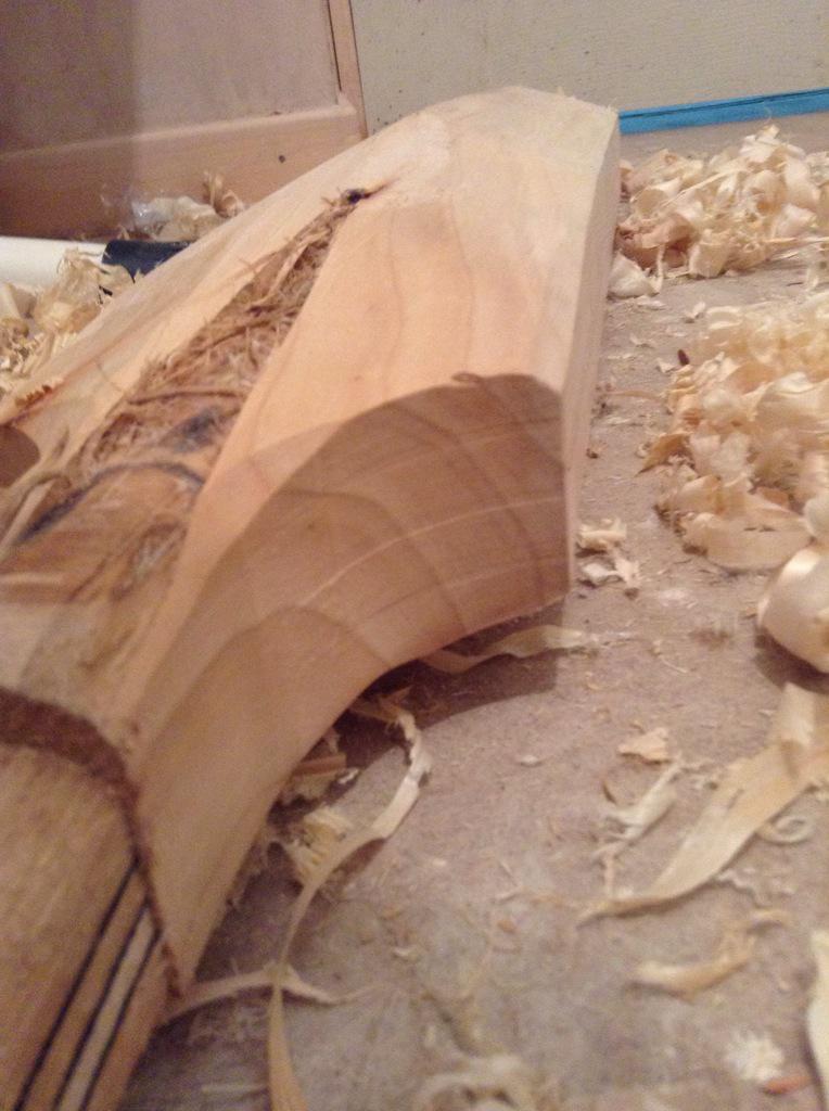

It's 75mm and goes that high for about 20cm up the bat. Thin edge though like the distinctions had but toe is a bit thicker
I do struggle to shape the handle though. Bottom hand feels a bit angular rather than oval. Will come with practice I suppose.

Some great work there Mate looks a belting profile

That is one mean looking bat.  How does it feel in the batting stance  and pick up

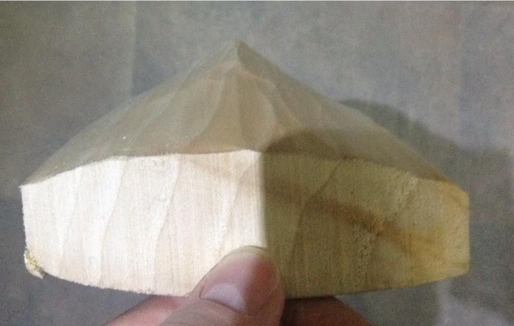

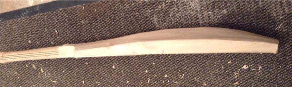

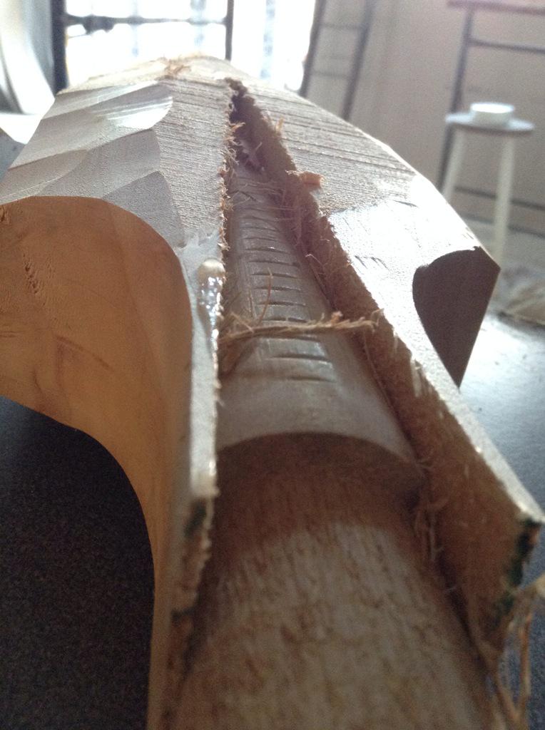

all done ............ created from a none machined handled and pressed cleft,literally a big block with 55mm edges adn 75mm spine

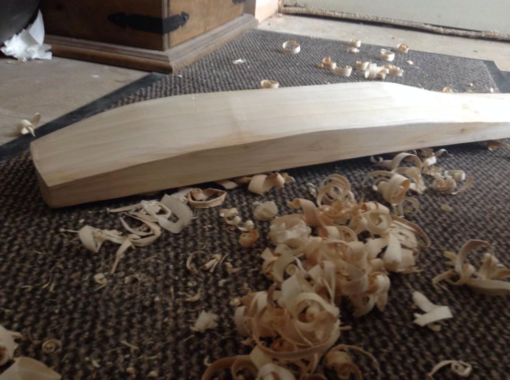

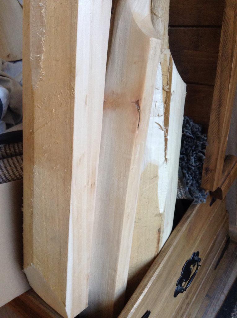

latest bat im doing .... with one tool and no vice .... back streets of karachi style!!!
40mm edge and 65mm spine, absolutely no concaving. Still a bit of weight to take out of the toe and shouldrs .... currently 3lb

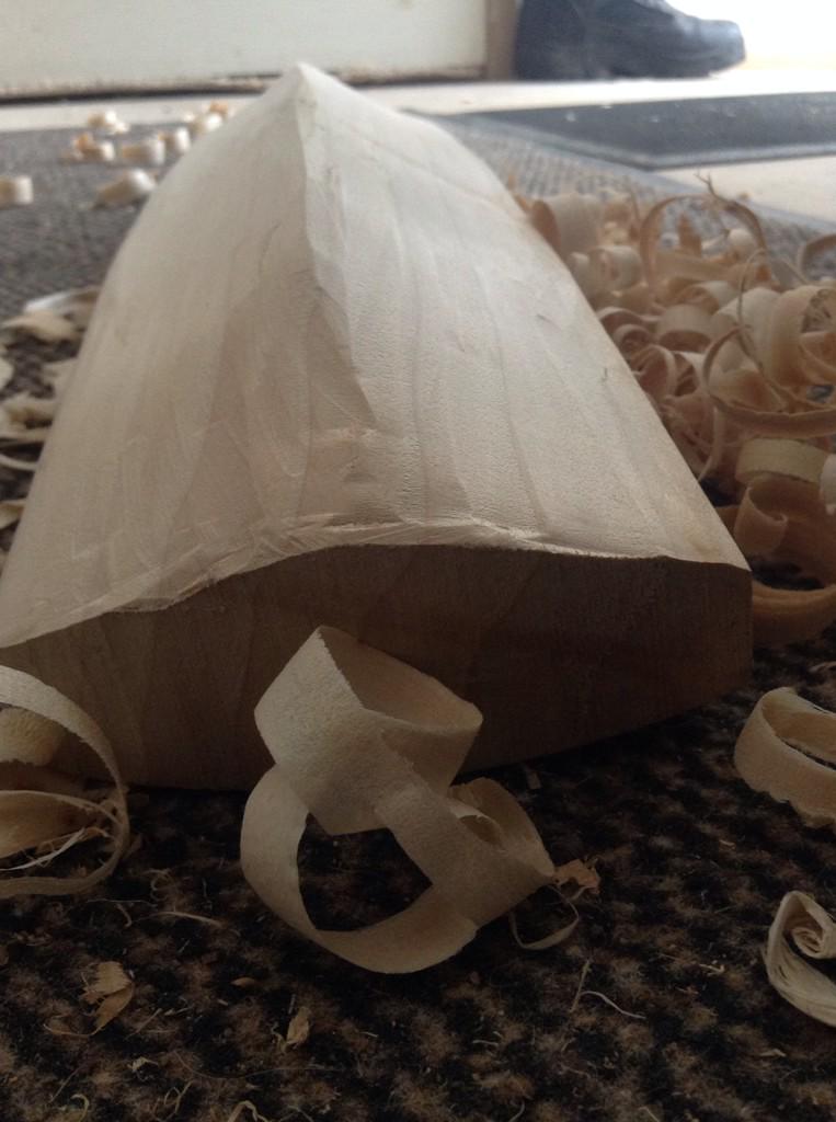

at the start .... a 50mm edged square block with no maching at all
after some shaping
10 mins later

You've got a good eye
The first bat looks very good, finished very well
Keep at it
If I'm being honest, the second bat would be what I'd shape!
Not a fan of huge spines, but the second shape looks perfect, looking forward to final pics
