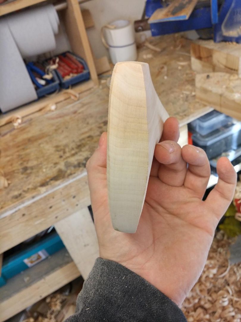

You can look at it two ways, a modern concaved bat Vs a duck bill toe (mxture of the two).
Modern profile - This will usually have more willow removed from the back which will extend into the toe area making it weaker.
Modern/ duck bill -  This can still can have a concaved back, however the concaving doesn't extend in to the toe, potentially making it stronger. See picture below after rough shaping.
Obviously the two examples about aren't an exact science as you can have a mixture of any profile.

IN some respects it is relative to the size of the edge. I'm guessing the edge profile is still 20-25mm without any concaving. 20 years ago that might of been viewed as a very big toe.
Obviously, but the point i was trying to make is that you could have a toe edge size of 50mm toe spine height of 50mm but wont give any added protection is the profile is concaved all the way down to the toe. Hope that makes sense.

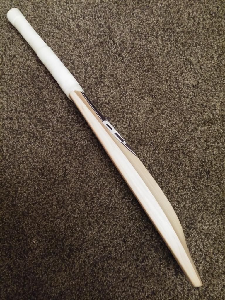

Re: Duck Billed Toes - pro's and con's
« Reply #13 on: February 06, 2015, 11:51:41 AM »
And where the duck has been moved up
