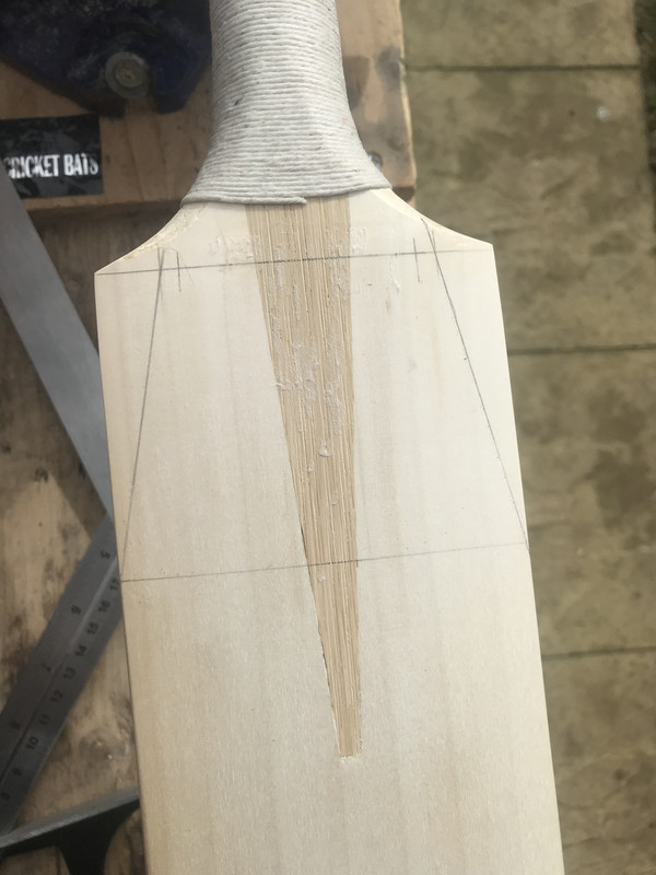

Let’s make a start
Re: Show us your Shoulderless numbers!
« Reply #4 on: March 18, 2019, 02:37:20 PM »
1st attempt

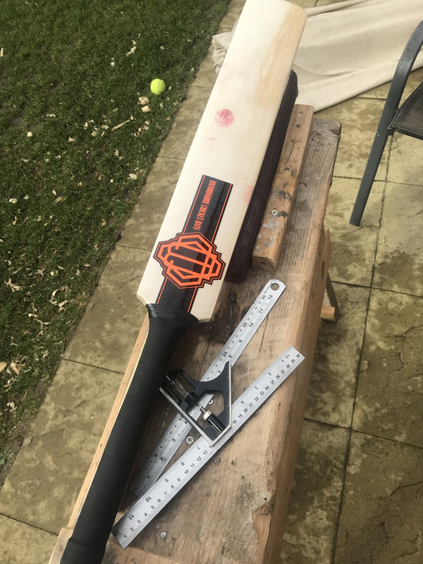

« Reply #5 on: March 18, 2019, 02:38:24 PM »
Second go
« Reply #6 on: March 18, 2019, 02:39:34 PM »
Better

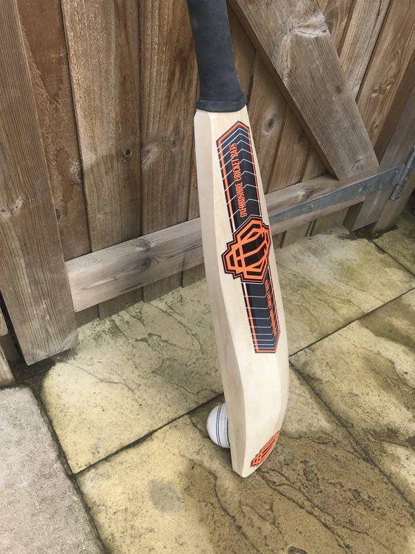

« Reply #7 on: March 18, 2019, 02:41:02 PM »
New sticker design needed

« Reply #8 on: March 18, 2019, 02:42:17 PM »
Weight difference is about an ounce and a half,,
I’ll leave it at that and have a net with it first, before working on removing more weight

I need to work on the handle as I’m really not a fan of big thick handles, and I’d originally left it very thick at the bottom for some reason.
I reckon there’s a fair bit of work to be done on that to get it comfortable for me
I have a 2-13.4 Amplus that I want to bring down to 2-11. Where else do you think I can take the weight off? I'd happy with the balance point moving down to mid/mid-low on that bat.
« Reply #11 on: March 18, 2019, 03:30:11 PM »
Can you take some off the spine?
And drop the edges/across the back
55mm peak spine is more than enough

« Reply #12 on: March 18, 2019, 03:32:00 PM »
The bat at the top has about 30mm edges and a bit of concaving
Totally different to that thing above
