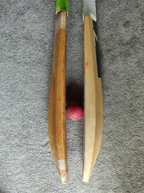

Here's an example of my own - the first bat I picked out for myself when I was 15, and my current favourite. Both are close in weight (2lb11), and the old stick has perhaps a smidge more concaving. Loads of wood in both but the new one is definitely bigger.

@edge does the older bat have a longer blade, are they the same width?
Even so, those bats allow for natural variations in willow moisture content.
Re: What if the idea of big bats is a myth?
« Reply #41 on: December 30, 2019, 10:44:25 AM »
Longer blade but slightly narrower width, so about even on that regard. Do agree I can't account for natural variation with only two bats, but I think it's a good example - both are very big bats for their time but the size difference is still clear.
