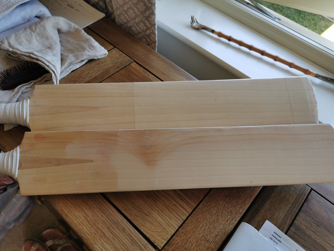

Personaly I think this stain will not soften up but other butterfly stain which doesn't have hard bar will soften up by oiling and knocking in with mallet many a time.
Anyways best of luck with it
Re: Softening a hard bar on a bat
« Reply #16 on: May 28, 2020, 03:53:22 PM »
So phase one is to remove the scuff sheet and clean it up. Which I have done (and gave my other bats a clean up too as I had the kit out.)
Phase two will be to give the bat an oil, putting extra over the stain.
I have had to order some oil as I have only used Lord Sheriton for ages, then I will leave it for a day or so and clean off the excess and give it a smash with the mallet.
Then repeat the process of I need to.
The fact is I really like the bat and it is a top performer, so I think it will be worth the effort.
My suspicion is that these efforts will a waste of time and it will be impossible to soften it but I will let you know.

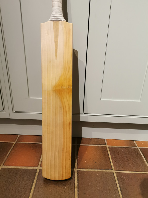

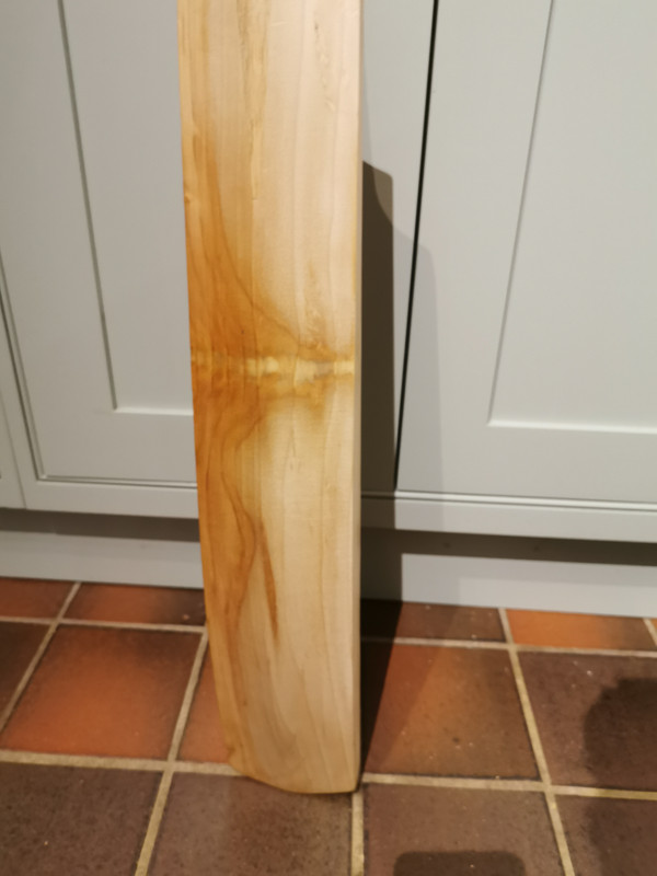

This isn't about performance, the stain is high up the bat, it is about stopping the vibrations when the ball hits higher up the bat.
I don't see why linseed oil won't help soften the fibres.
Some bat that for 60! Is the actuall stain itself softer than the area under?
The stain is hard, as is the willow upto about an inch below, after that it is perfect.
And yes for the price I paid i am very happy with the bat.

OK. Here is an update..
The oil has worked. The bat has softened up by the stain.
I just need to bash it a bit and put a new scuff sheet on.
Oh and glue and clamp the crack I put in the edge before I put the scuff sheet on.
I am not saying the bat is perfect, but it is going to be a good bat.
