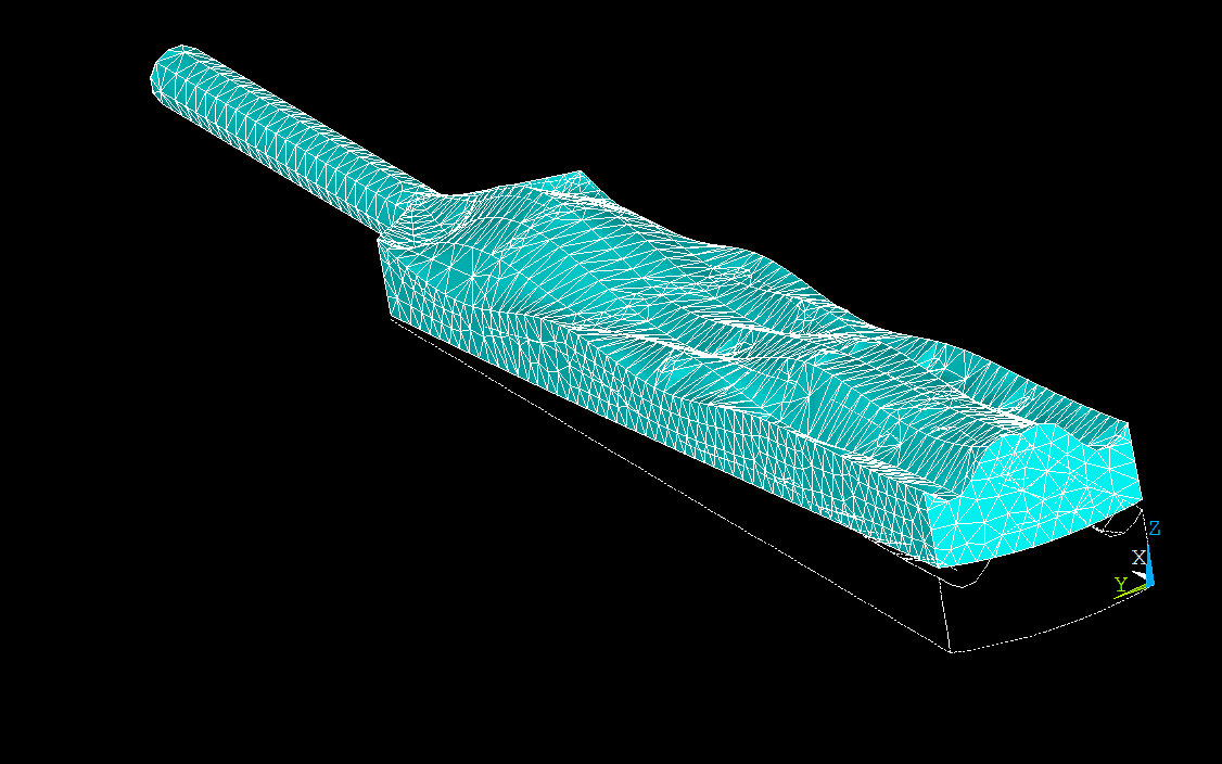

Hi. Sorry for bumping such an old thread, hope it is ok, but I thought it best here as it follows on from my original post. Although this might end up being a bit niche, so apologies in advance.
Since I posted about making my first bat, I have spent the last 12 months reading every (yes, really!) thread on bat making, figured out how to carry out structural modelling of bats, and generally feeding an unhealthy obsession with bat making.
Sticking to the original post, where the design of the bat I made was based on artificial intelligence – anybody can now access the full Masters thesis where the method is described in loads of detail: https://open.library.ubc.ca/soa/cIRcle/collections/ubctheses/24/items/1.0392675

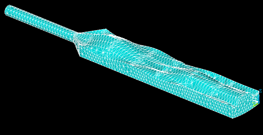

I got in touch with the author, who was very kind and helped me out in recreating part of his work. Long story short, I managed to run his (slightly modified) code in Ansys, an engineering simulation software package. The result is that I can use it to predict quite a few things of interest for bats of almost any shape, like mass and volume, centres of mass and percussion, location of vibration nodes, etc… My main interest is in seeing how the different shapes of bats change these parameters, concentrating on their effect on things that most people are familiar with, like pickup and sweetspot.
The modelling is not perfect, as the shape of the back of the bat is estimated from 50 points. Overall this is actually pretty good at recreating most shapes, but if there is some feature that is a bit small in one direction (looking at you Dynadrive) then it can be missed. Those 50 points are meshed together, along with edges, toe, face and handle, in Ansys for the modelling, allowing you to come up with ridiculous shapes like this
free photo upload
You then carry out the structural analysis, which means you can deform the bat like this:
image share
Back to the original bat. I have used it twice, and it feels ok. There is a nice butterfly stain running pretty much across the middle, which might help things a little. Here are a few photos to remind you of the slightly odd shape, taken after I learnt how to polish bats a bit better.
The bat weighs 2 lbs 10.8 oz in real life, and looks like it should have a low sweetspot. The modelling does a pretty good job in this case, with the predicted weight being 2 lbs 11.5 oz (I did not play around with the modelled density, just used a constant one, so could improve), and the shape matching the real one quite nicely.
So trying to show some of the results on the bat itself, with COM = centre of mass, COP = centre of percussion, node 1 and node 2 = nodal points (of interest) for 1st and 2nd vibration modes. I think the definition of these have been covered a lot on this forum, but just in case…the COP is where the batter will feel no recoil of the bat, instead just a perfect rotation about the pivot point between the two hands. The nodal points are locations where the bat will not vibrate, instead transmitting more energy into the ball. The sweetspot is often defined as an area consisting of some combination of these points. In the thesis (page 48), an “objective function” is defined, that basically looks at how close together these 3 points are – the lower the value, the better the middle, at least according to that work. The centre of mass will, to a large extent, help define the pickup of the bat (i.e. the higher the centre of mass, the better the pickup will feel).
I marked the location of these features on my bat, to see how they compare with the shape, and the results are what you expect: the sweetspot defined by this method is pretty much where there is the most wood. It is still satisfying to see where exactly I should be aiming for (not that I often manage to!)

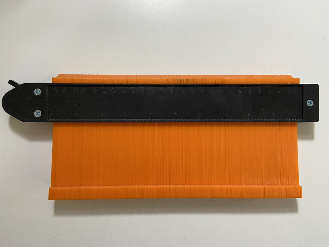

I could probably give it a go with the usual dimensions (toe, maximum edge and swell, shoulders) and a good side profile. But it would be guessing.
Ideally, what I do is use one of these flooring gizmos to take a profile, and then measure off that.

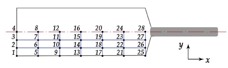

The code I run needs points measuring according to the grid below (taken from the thesis)

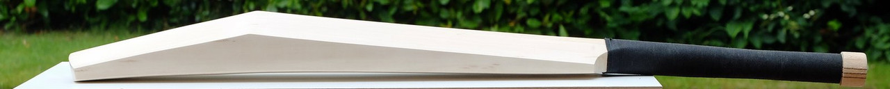

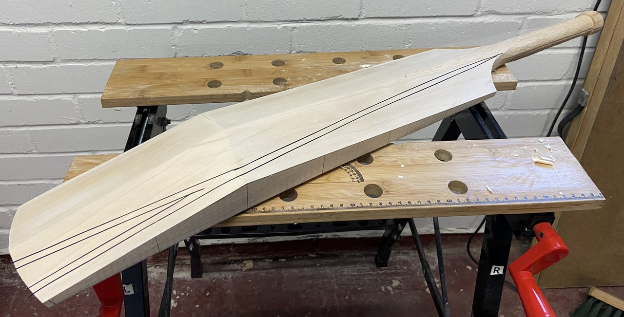

I got 2 part mades from Hell4Leather – 1 x grade 2, 1 x grade 3 – to slowly keep working my way up from butterfly as I practise more. Annoyingly, I cannot for the life of me find the pictures I took of them in that state, which is annoying. Sorry.

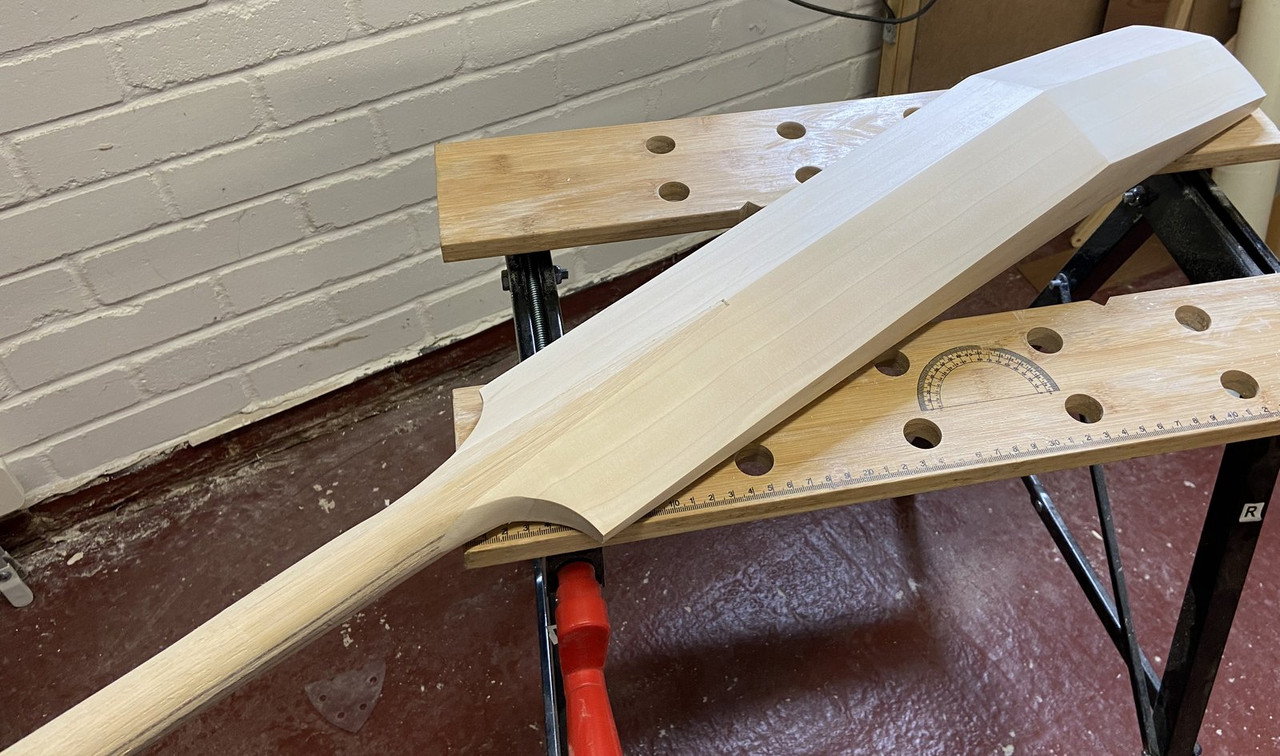

So I don’t have many in progress photos for this one, but the idea was to carry on making shapes that are not really possible to buy. I sketched up this shape first, with the idea that it would be kind of like the Tesla Cyber Truck of bats. I wanted straight lines everywhere, totally unnatural. But not like the mid-1990s GM Diamond, which for some reason I never liked the look of. I used the grade 3 for this one, as I was worried it was going to go very wrong.
I assumed that this would be a bit heavy, and so I was going to try to take an ounce or two out by routing out some geometric lines about 3-4 mm wide, and maybe the same deep. One of the patterns I was thinking about is in this image, but as it turned out, the weight was ok and my fingers were safe from routing without a jig.
toast hampstead
Final measurements:
Toe: 14 – 28 mm
Edge: 40 mm
Swell: 62 mm
Shoulder: 10 mm
Weight: 2 lbs 9.5 oz
I am kind of surprised a bit, but the pickup on this shape just feels fantastic, at least to me. I guess that is because of having a lot less wood towards the toe (I hope I never have to face a yorker with it!).
I still had an old setup for making this one, so the backbreaking workmate (I do not recommend it – far too low) and mostly a plane. It was obviously fairly easy to stick to the dimensions I wanted because of the straight lines, but the point where the 4 lines join is not quite perfect, which will annoy me forever.

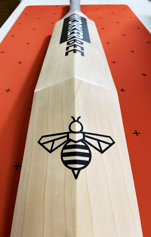

As with all the bats I have made recently, I like the idea of them being a little bit different. So I went with black twine on the handle, and even hid the exposed top part with a little black kinesiology tape.
I also came up with some new stickers for this lot of bats. On the handle there is a metallic sticker, which can be seen under the silicone grip. And on the bat, not being able to afford embossing on a small run, I went with textured matt vinyl, which I think matches the fairly simple design quite nicely. For some of the stickers I went with pretty complicated cut lines, and so had to apply those with tweezers and transfer tape for vinyl. It can be a bit fiddly, but ok once you do it once or twice.

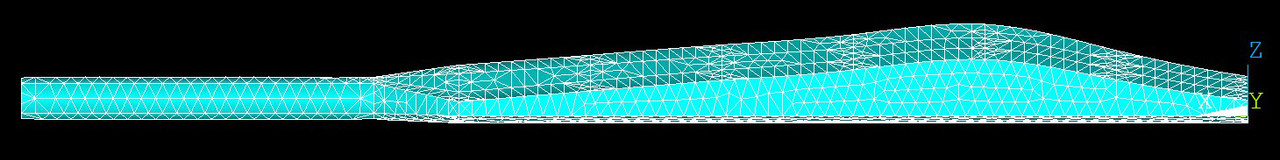

And for the modelling side of things. Well, because of the easy shape I think it did a good job. Modelled weight was almost spot on at 2 lbs 9.6 oz. And the shape was pretty good too, although not all lines stayed as straight as I wanted.
For this bat, from the toe:
COM: 315 mm
COP: 225 mm
Node 1: 180 mm
Node 2: 115 mm
