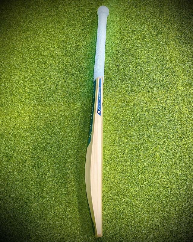

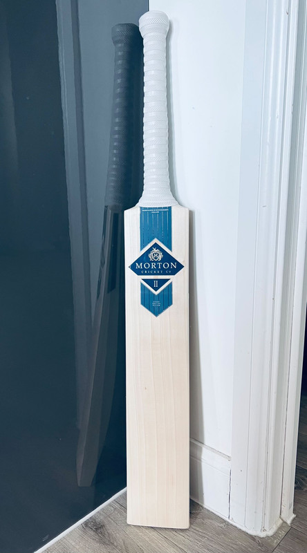

Latest stick was dropped off to a lad over in Bedfordshire. As much as the hour long journey would seem like a farce for many, I’ve always found that being able to have a chat in person far outweighs the commute. Specs on it are as follows:
Weight: 2lb 13oz
Edges: 42mm
Spine: 66mm
Width: 108.4mm
Thick oval handle with double grip and counterbalanced knob.
I showed off my ridiculous blade for the year and it’s come with a lot of interest from customers, seems like the regulations on bat specs isn’t so much of an issue for many!
The lad tapped it up with both the mallet and league ball and gave me a little run down of what he thought the day after which was flattering to say the most!
With every pro though there are cons, running ‘sales’ aka reasonable bat prices has peaked interest significantly and it’s become quite difficult to manage messages and comms while working throughout the day. But fortunately everyone is understanding of my situation

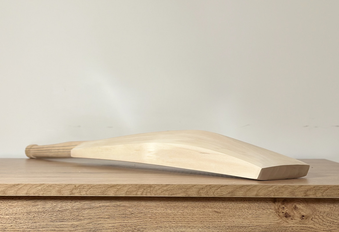

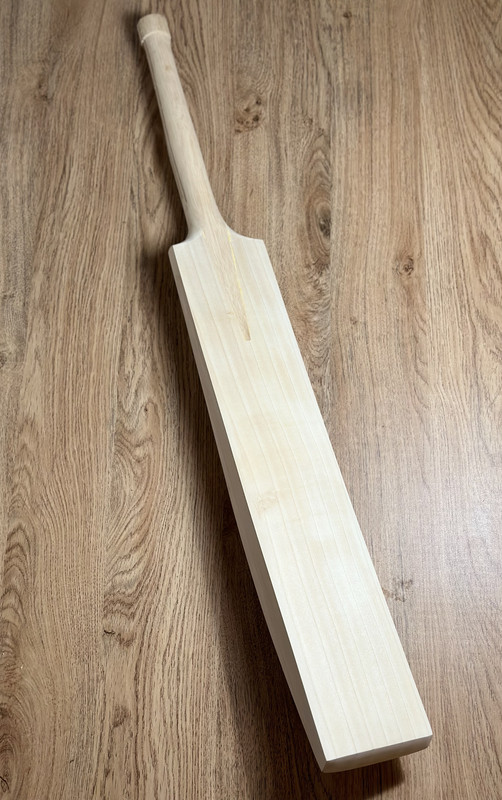

Because I work in education, most of the spare time is spent using the workshop at the school in the evenings to have a little play around with some shapes. It’s been a pleasure making up this one that was won in a charity raffle, a win for the cricketer and for the local hospice  :D
I shall just leave these here…
Please note: in its current state of rough sanding, the bat weighs 2lb 9.6oz so will probably end up having a dead weigh closer to the 3lb mark after the stickers, binding, grip and other additions (grips & toe guard) the owner wants on it. Hoping the pick-up is going to remain as delightful as it is currently!

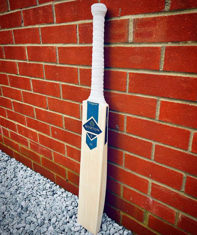

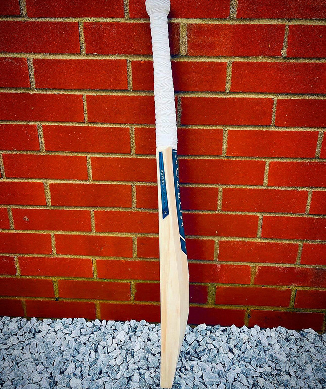

So finally in the process of “releasing” the “range” for this (and future) years. Slowly worked away at a couple of shapes that I’m happy with that can also be consistently made.
Before I get started, I want to apologise about following stupid words and such in Latin. If I’m honest I just thought it would frill up things a bit but also try to match the approach I’ve taken with the bats…
First is the Imperium. (Supposedly based on the Latin word for control) it’s all about having a large (mid middle) sweet spot with the characteristics that help with manoeuvring the ball ie a tapered oval handle and a relatively nice pick up/feel. The one in the pictures is up for grabs at the not-so princely sum of £170 (inc U.K. postage) as a little promo to get the bats out into the wild for validation.
Basically it’s an average edge sized, higher-spined bat that runs all the way to the toe. With a little bit of concaving to allow for lighter weights to be achieved. Oval handle and nothing exotic other than its name.
Anyhoo, enjoy the pics of my first Imperium:
Comments and thoughts are always welcome  :D
