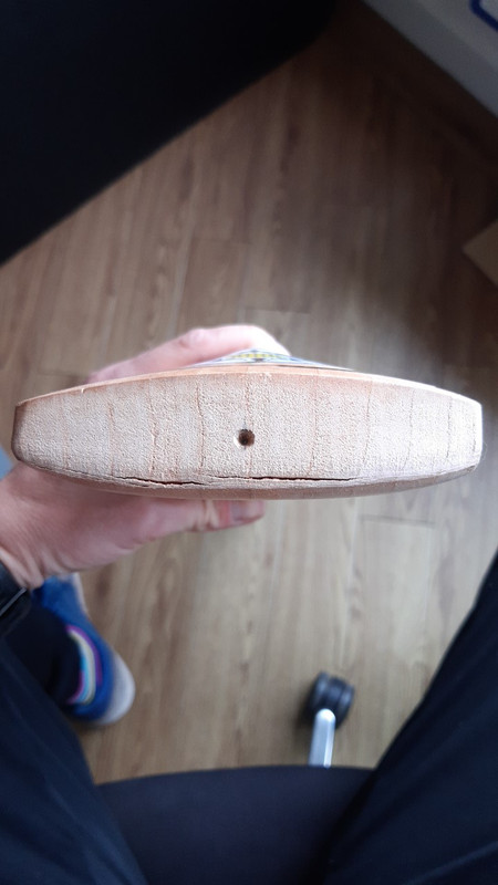

Hi guys,
I recently helped a guy at our club buy a new bat and he's been busy knocking it in whilst I was on holiday.
He dropped in today as he had concern about cracks on the toe.
Looking closer it looks and feels (spongy/springy) like it's delaminated for the first 15mm up the bat and pretty much across the whole face.
I'm thinking PVA/wood glue then clamp/tape over night to try to re-laminate it and seal up the worst of the cracks.
I was going to shoe goo glue a toe for him, but wondering whether something for robust may be required now?
In terms of knocking in, do you think he should fix first then continue, or do a bit more knocking then fix later?
Not an expert at bat repairs but always willing to give things a go, appreciate your guidance.

Has he knocked in the toe at an angle? Looks like it's been knocked incorrectly - the toe should be knocked in flush with the face - the way the fibres run down the bat means that any compression done at an angle on the toe will potentially be forcing the fibres apart. I'd recommend getting glue in there and carefully compressing it before progressing with knocking. A good quality wood glue will do the trick. (Gorilla Wood Glue or Titebond II for example)

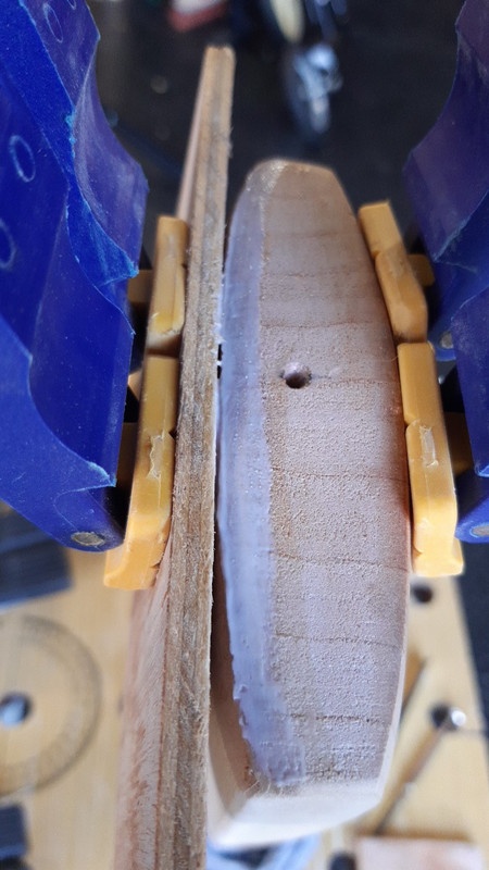

I've popped a bit of Gorilla wood glue in as best as I could, without opening up the de-lamination/crack any further. Hopefully it's just consigned to the first 15mm and hasn't propagated any further up.
Then just put some hand operated clamps so comfortably clamping but not toooooooo tight. Will lightly sand off any glue tomorrow PM.
I may have to give it another glue after he's finished knocking in but let's see how that goes.
