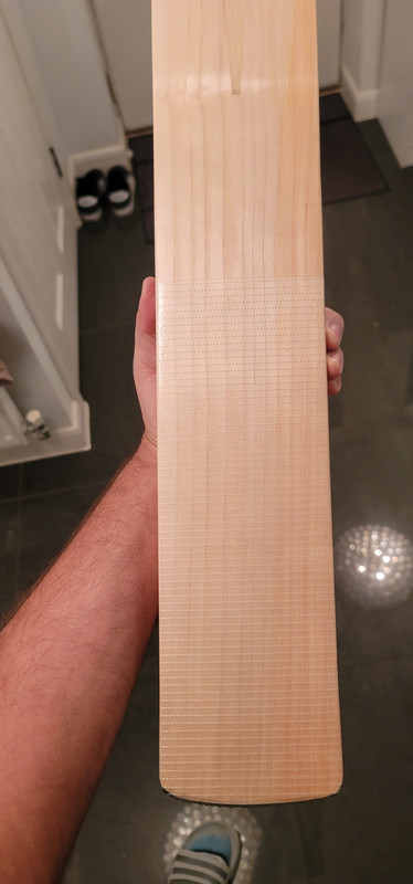

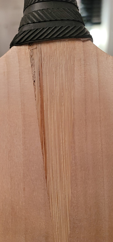

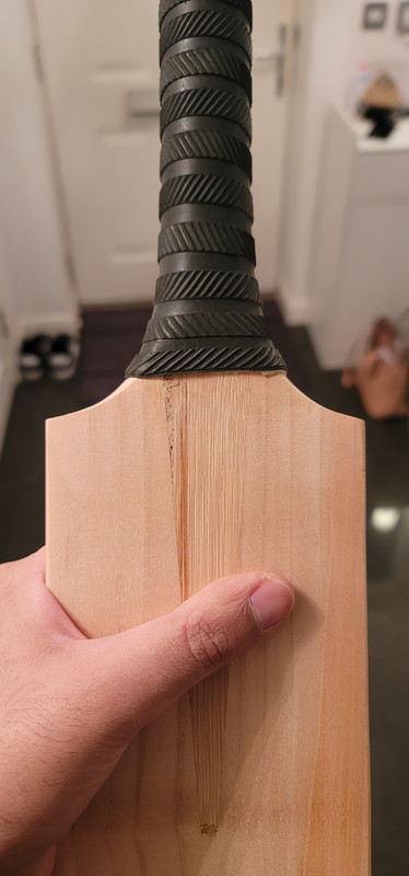

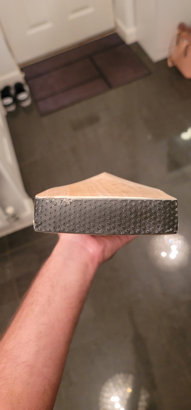

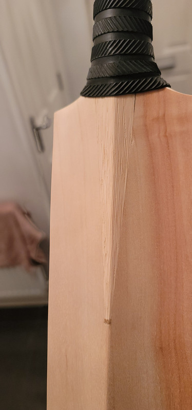

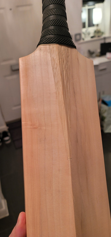

Hey everyone. Thank you for your responses. The bats arrived last week and I have been wanting to put up images and a video but the website has been down. Was anyone else getting the server limit error or just me? Anyhow here are the bats. I made a video and took some photos in question. Please let me know what you guys think!
I personally think the workmanship is not the best. There seem to be voids where the handle fits the bat that look to have been filled in! Is it just me of does the handle itself looks have really thin rubber stripes? Too thin? Apart from that I think I was expecting the ping to be better. Please check the video links, they are only short. I was expecting the ball to bounce higher! I asked for one bat with a mid middle and another for a low middle for our low bouncing pitches. What grade would you put this willow at? I know both have the fibreglass sheets but I am keen to hear your insights!

Ping tests like the video (although I've done them myself on socials etc) are pretty pointless. You can make a ball hit the ceiling off a piece of plywood. I feel that gently tapping a mallet gives me a better feel on the response, but playing with it is there only way of truly knowing if you're 100% happy with it and it will need playing in. Are there any indentations if you hit with a mallet? Does the mallet respond well?
In terms of the handle, I wouldn't expect this to be the greatest quality. These bats are made to a price point and I wouldn't have thought a handle is a consideration for many buying them, with a decision based more on price v's reported grade of willow. Although it's obviously to tell from pictures obviously. Be interesting to get it in a vice to see how much twist / flex there is and to take the binding up to see if there's anything lurking under there. The filled in parts could maybe just be where the willow has splintered slightly when cutting the splice, so maybe just superficial. This shouldn't t cause an issue in my experience.
Do they weigh as requested?
May as well use them and see how they go mate. You might like them!

Thanks for sharing the photos, I'm glad your bats arrived.
For me, if I were to see them in the store I'd probably pass on them due to the handles - a personal preference thing I guess. But if you like them, they pick up how you want and perform how you expected then you should be happy.
Good luck with them, let us know what you think when you've had a net.
