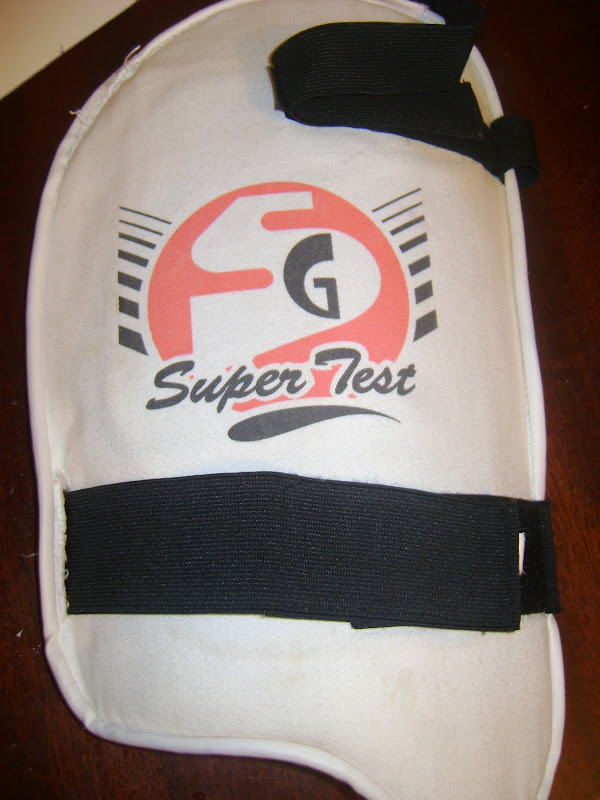

Looking to make my won set of thighs pads, anybody have any ideas of what you would need to do and materials you would need to create them ????

Memory foam, elastic, cotton sheets, sewing kit, Velcro fastening.
That'd be a basic one.

1) HD foam / UDHD foam
2) Thin plastic sheet to protect if you are using the HD softer foam.
3) Casing (faux leather type outer and a towel type inner )
4) Straps
5) Velcro
6) Glue , I struggled to find the right one as some types of glue melt the foam.
It depends what you are trying to achieve. If it's a custom fit then you are better off buying a larger thigh pad, get the padding out ,cut it to required shape and put back into the casing.
I have adapted a couple of thigh pads to requirements being a shorty.
