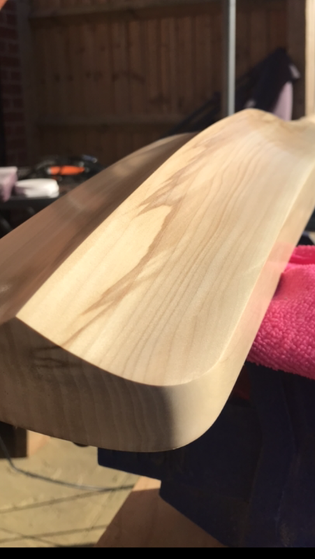

Re: Sandpaper
« Reply #20 on: September 30, 2018, 09:19:35 AM »
SAFC2403
  • Posts: 176
Re: Sandpaper
« Reply #21 on: October 01, 2018, 11:07:56 AM »
That looks quality and that grain marking looks brilliant!!
Grubby
  • Posts: 237
Re: Sandpaper
« Reply #22 on: October 01, 2018, 11:18:07 AM »
Looks Good. What's your process to get the finish to this stage?
Thanks.
Re: Sandpaper
« Reply #23 on: October 01, 2018, 04:42:21 PM »
Looks good?? Looks amazing yeah?
Process,,, as I wrote above
Go through the sandpaper grades, 80,120,150,220,300,400,600
Might miss a couple depending on how it looks
Remove all the dust before starting a new grade,(stiff brush)
Then buff it
Job done,,,, hopefully I made that sound a lot easier than it actually is
