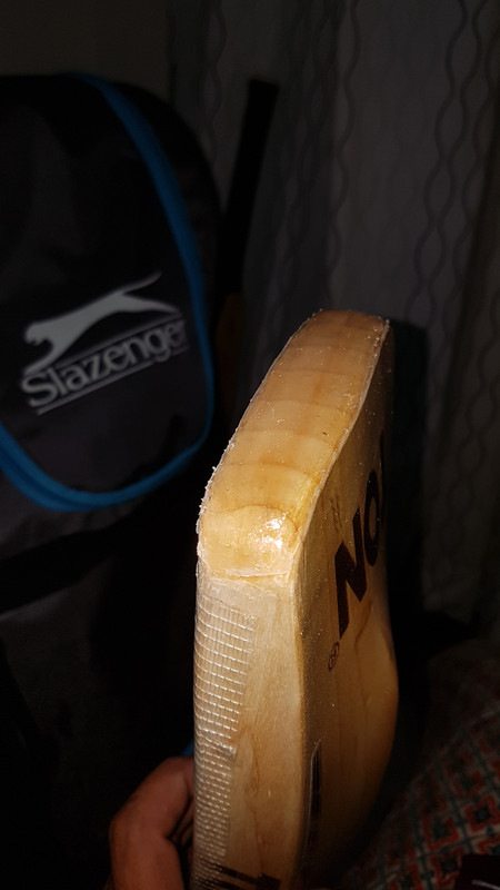

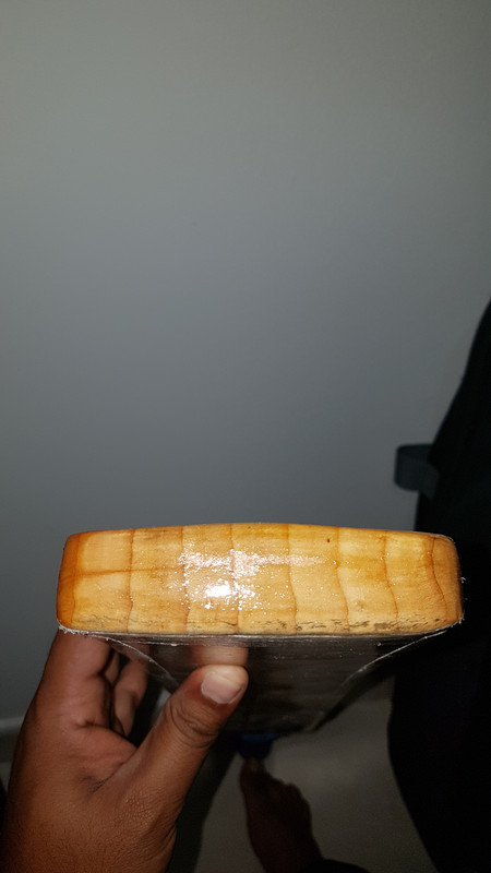

Not bad for my first attempt. Very pleased with the results. As suggested, 2 light coats of oil, 1 coat of varnish and then shoe goo. Letting everything dry completely.
Varnish layer
Shoe goo
Been drying for 12 hours. Gona leave it upright for another 24
