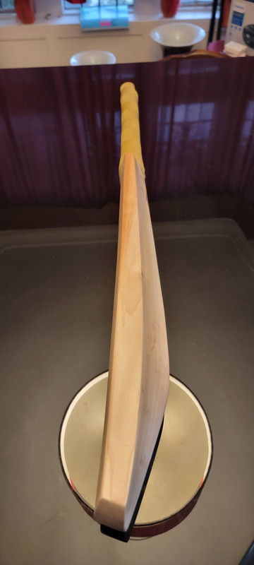

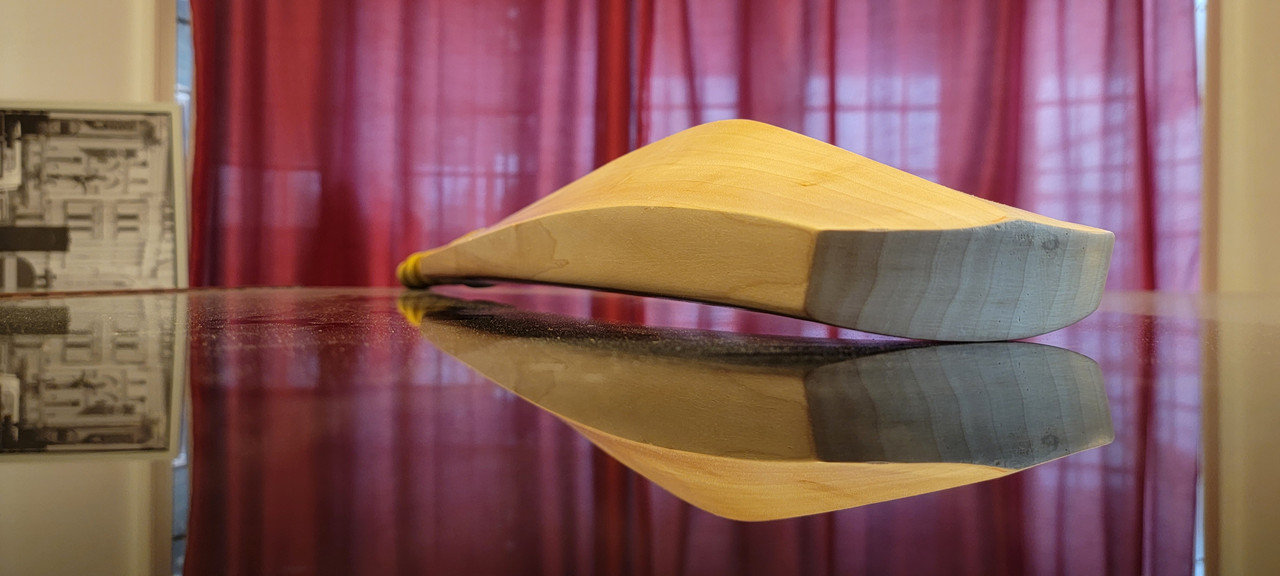

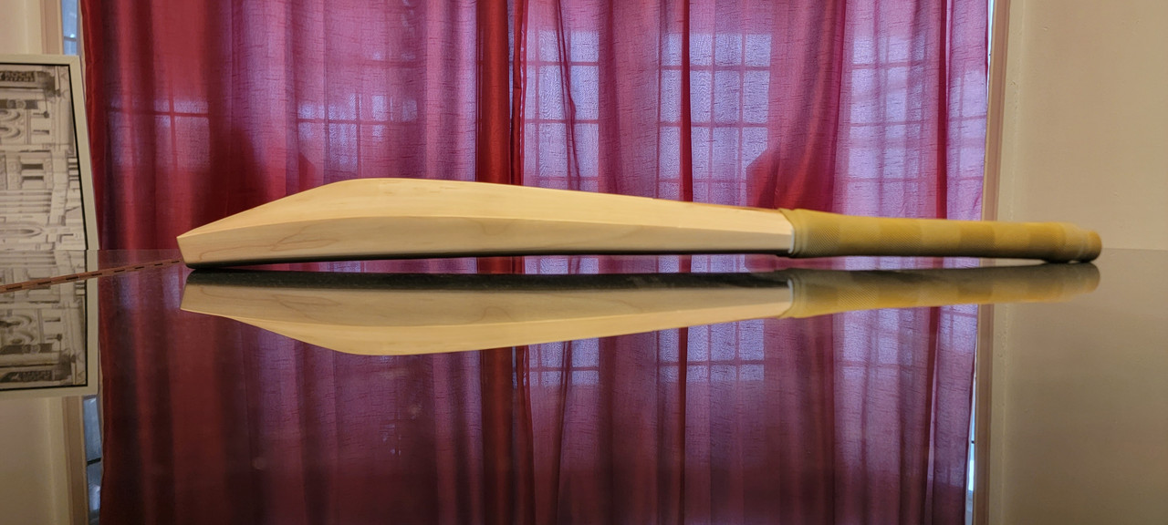

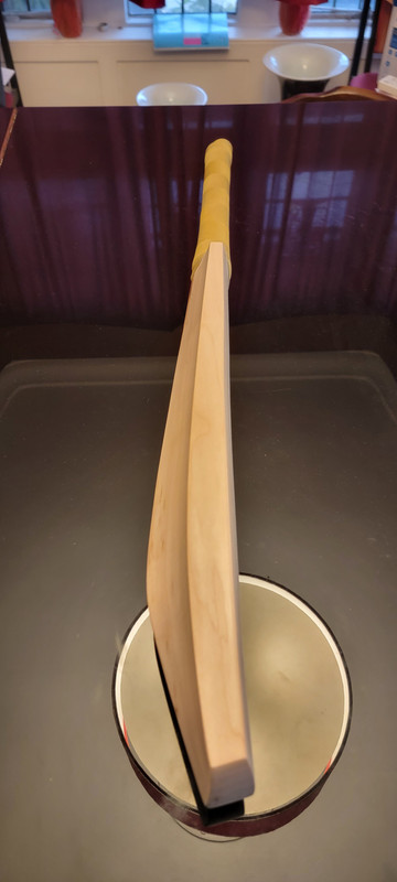

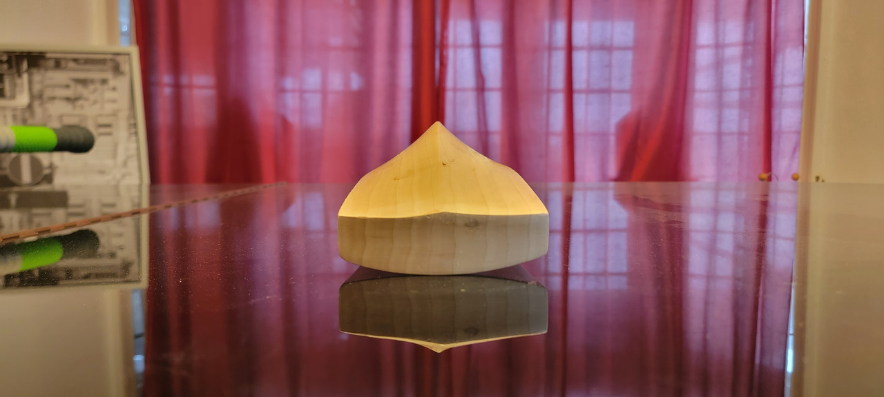

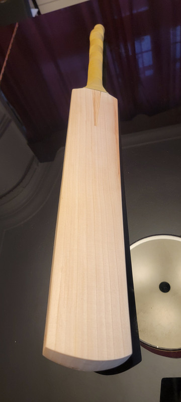

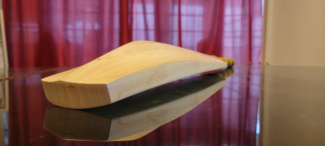

I'll be honest and say in all liklihood, you'll probably not be too happy with it. If you really want a proper distinction, go for the 2lb 11-2lb 14 range. Here's one I had custom make from an oversized cleft by @Perkins17 - it's 3lb with a double thick chevron, and has a 77mm spine and 33mm edge. If you want a bit of fun and nostalgia, don't be afraid to go a bit heavier
