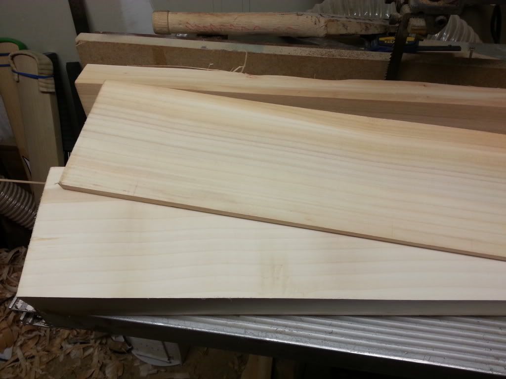

I'm planning on cutting the face of the donor bats and laminating them onto the other blades once they've been planed then they will be pressed and spliced/ shaped and finished.

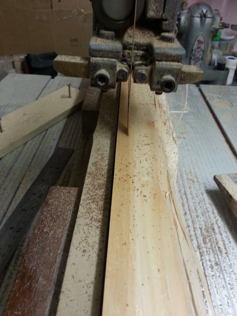

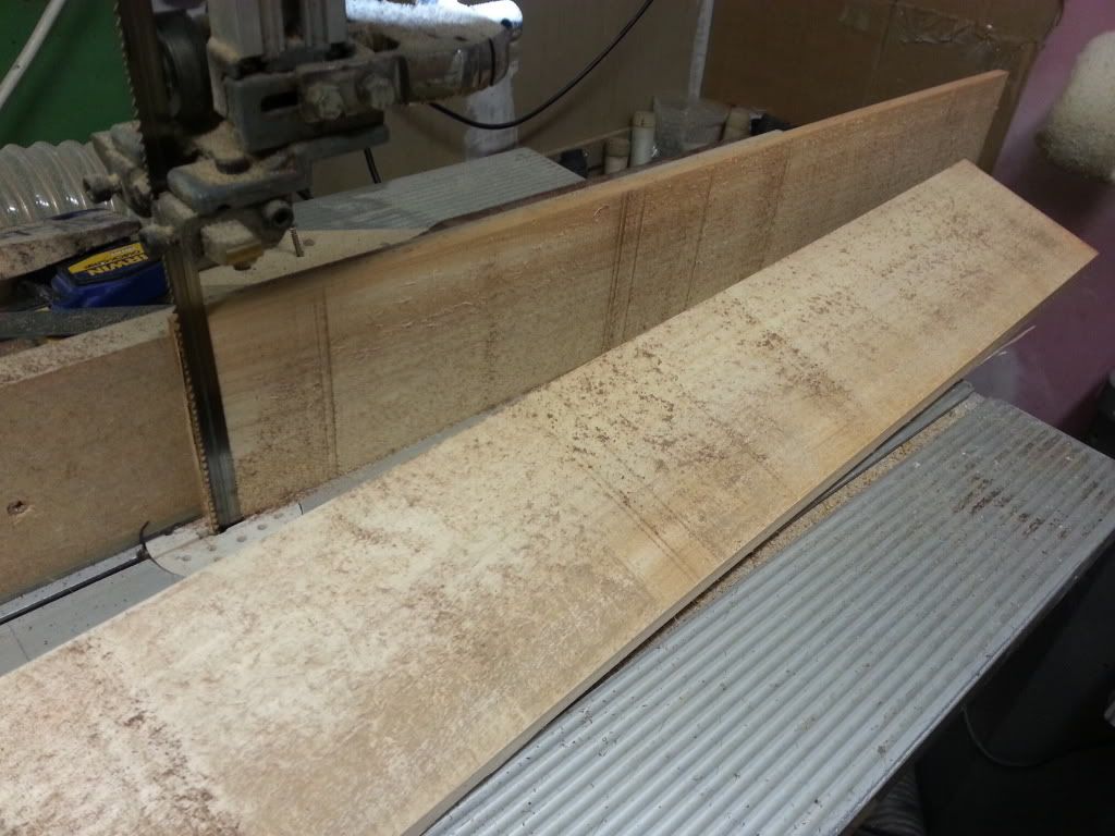

That's not a problem. I'm using my bandsaw to cut a thin veneer of willow then I need to plane the face of the lower grade bat before gluing together.

And so it begins.  The first one has been glued and clamped.  On with the second one now.
