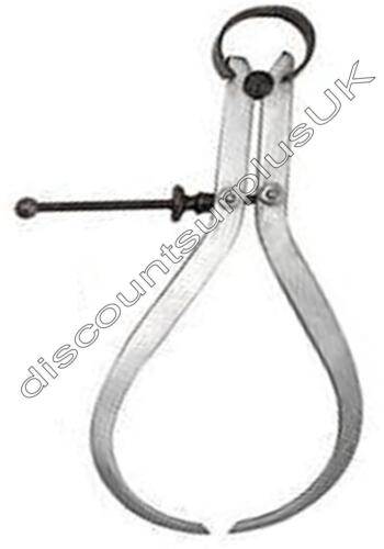

http://www.ebay.co.uk/itm/OUTSIDE-ADJUSTABLE-SPRING-CALIPERS-7-180mm-NEW-Lathe-Metalwork-Woodwork-RR24-/141128356204?pt=UK_Measuring_Tools_Levels&hash=item20dbe7d16c
plus a ruler which you have already.

Ideally when you use  outside calipers ( shown in picture ) you need inside calipers for point  to point accuracy when you measure with a ruler.
