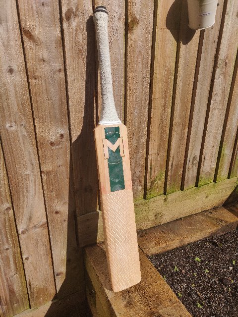

Been a while since I posted in here! Handed over a lovely grainy butterfly today, to a clubmate who wanted a slightly modified version of his old bat - nice long middle fading away at the toe to keep the pickup light, just a smidge over 2lb 8oz. Hopeful that at some stage this season I'll get to walk out as part of of opening pair both using my bats!

Looks great. Do you always play with your own bats? How do you find other makes compare?

@Psi the majority of the time I use my own sticks yeah, the exception being a Puma I rebalanced that I usually carry as a spare, or if I fancy getting the Mongoose out! I'm obviously biased haha, but I prefer my own to mainstream brands - I get my part mades from the best suppliers I can so the performance isn't in doubt, and being able to shape them to your own preference is great.
Re. the toes, yeah it's durability - I like a flat toe, but round the corners so they're less susceptible to damage. Not a massive difference but prefer to to a traditional toe. Laver & Wood are the only well known brand who do them that way I think.

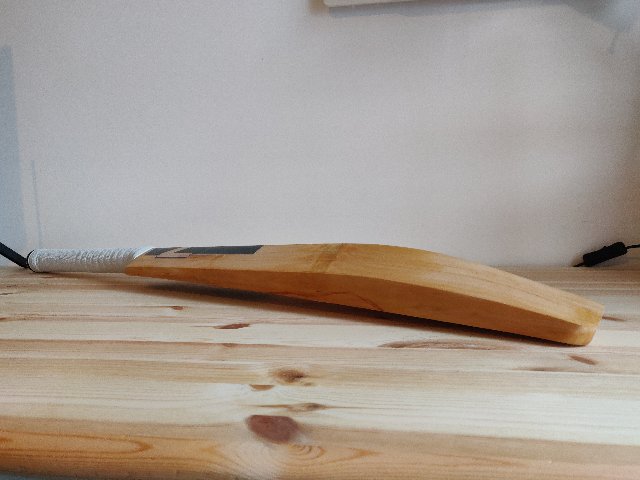

Another for a clubmate, lovely straight grains on this cleft with a massive butterfly stain quite high on it. Nice and easy request this one - "I like the one you made for our opener, but I don't really like big edges and could you make it quite heavy". So it's a little more traditional than the last few I've made - convex back, fairly long flowy middle and sensible edge size. 2lb12, hopefully he'll be happy with it!

I like the underlying grain structure under the butterfly on that. Could you tell from the cleft that it would be like that or does that emerge during making?

Little bit of both, you can always get a good idea from the cleft but it shows much better when finished.

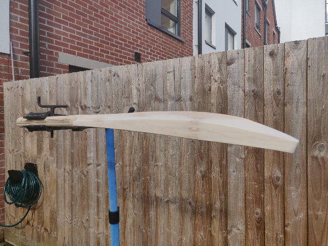

Rare combo of day off and sunny morning so made time for a refurb of the first bat I made, which had been looking a bit sorry for itself, plus some sanding work on a new weapon for me as I haven't made myself one in a while. Can't wait to get this one done!
