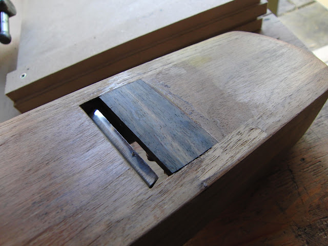

This is on the blog, plus a piece I wrote about my views on Pod Shaving
From the blog:

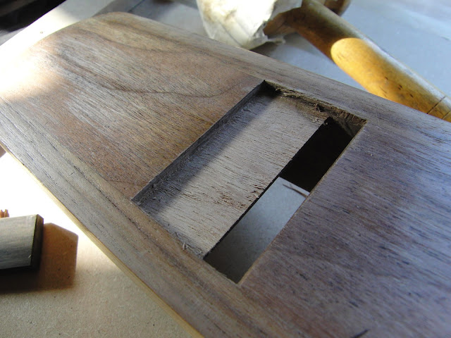

Since I'll shortly be tackling some figured maple for the making of a hand plane, I thought it would be a good idea for me to close the mouth on a wooden plane I already made. Whilst it functions admirably, there is room for improvement. I had a couple of ebony offcuts that were tidied up on the shooting board (already worth its in Gold) and set about removing some wood from the sole.

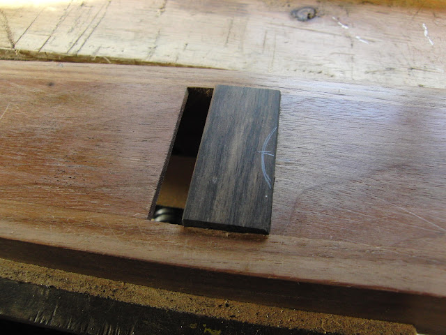

Using the projected blade to rest the ebony block against, I mark out the area with a knife

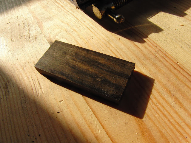

The piece of ebony in question, all squared up.
Cleaned up and flattened.
I probably should have had the grain running down the sole, but it may prove to be a nice contrast once cleaned up.

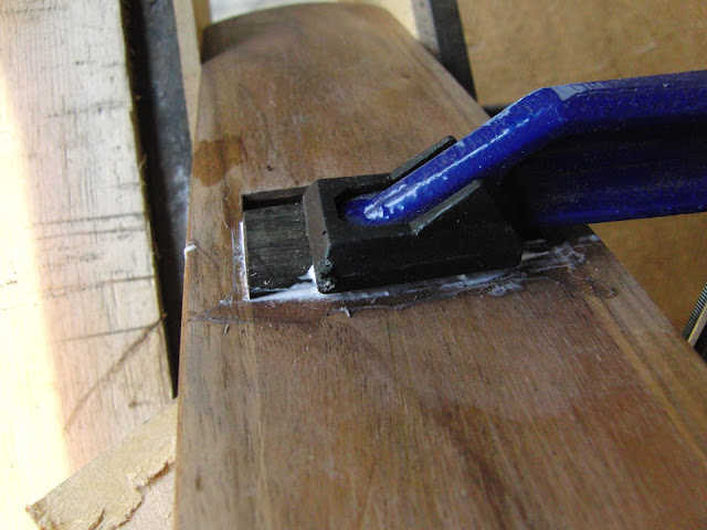

Glued and clamped
I'll see what it looks like in the morning.

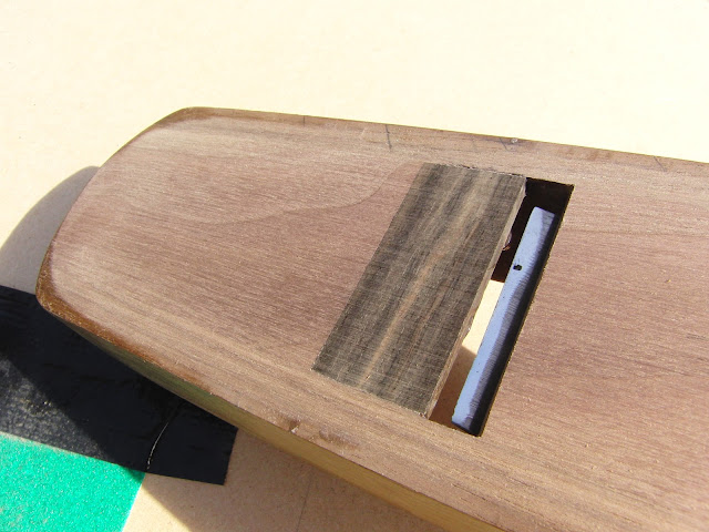

« Reply #134 on: March 31, 2012, 08:02:05 PM »

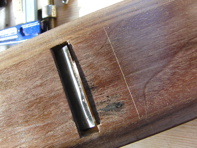

A quick look this morning revealed that the ebony block had glued in nicely. So I set about cleaning up the sole.
A block plane worked perfectly but I went on stroke too far as can be seen by the gap. Ooops!
Some 60 grit sandpaper stuck to a piece of MDF works perfectly to quickly remove the bulk of the waste on the sole.
A few areas around the edges remain untouched but the majority is nice and flat.

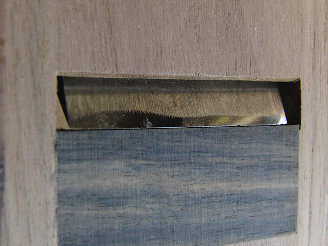

A vast improvement
The small chips you can see in the blade are incredibly frustrating. I have spent hours trying to get a uniform edge but the blade continues to flake when I start to sharpen or use it. I don't have a grinder and I do my sharpening by hand so the blade has never been overheated. The grinding marks are from when I first bought the iron, so as you can see it's barely been used.
Edit: Now sorted the edge, I needed to increase the bevel angle on the tip. Thanks to Phil from Philly Planes.
