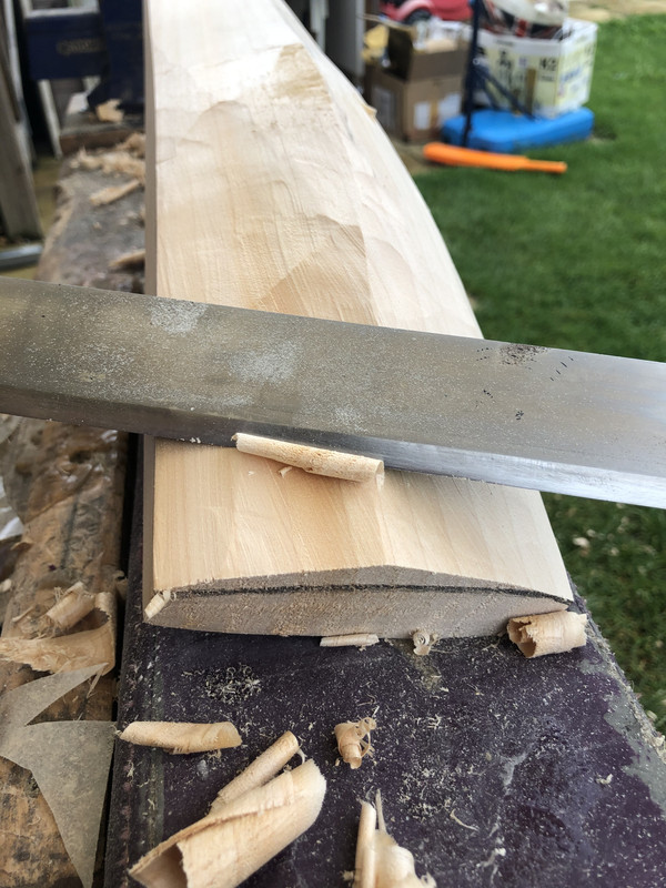

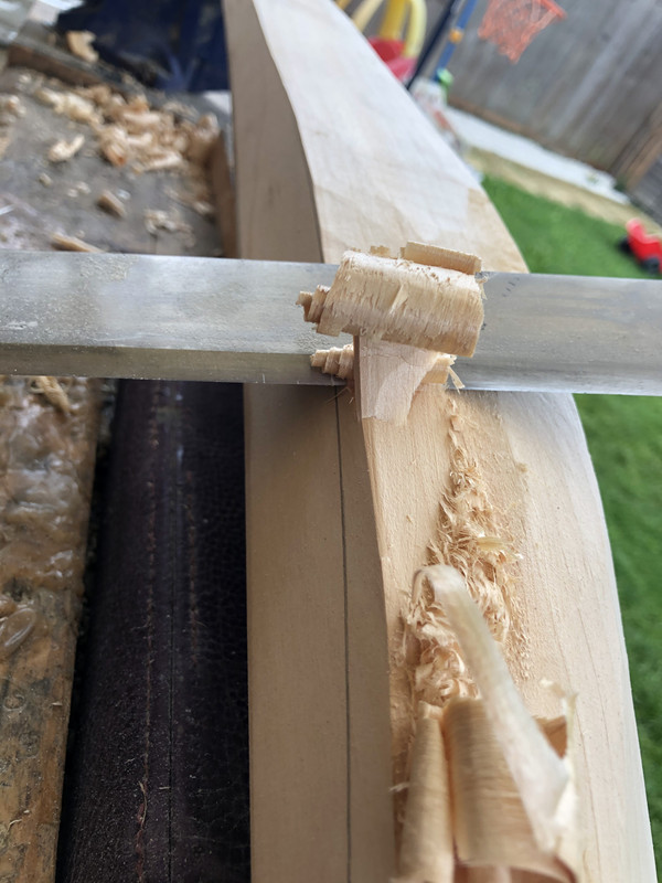

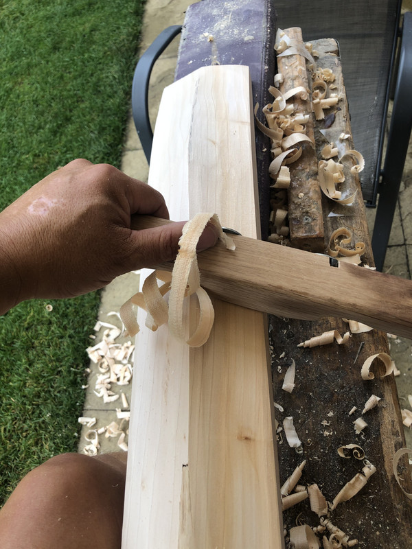

Using the new drawknife to remove wood, trying to get as close to the marked lines as possible to limit sanding time etc

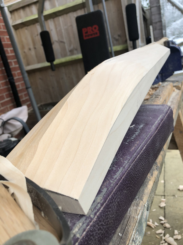

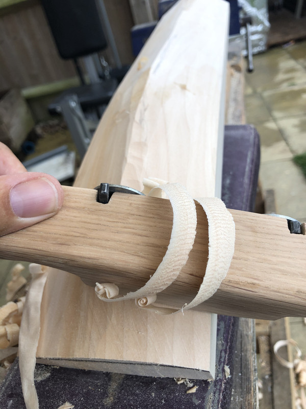

Now the travisher can be used to form the spine and remove wood from as much of the blade as possible,, I love this tool and actually draw it towards me as opposed to away as traditionally used.
I can get a pretty good finish using this tool and remove a huge amount of willow, it really is a perfect tool for shaping bats

I use it all along the profile

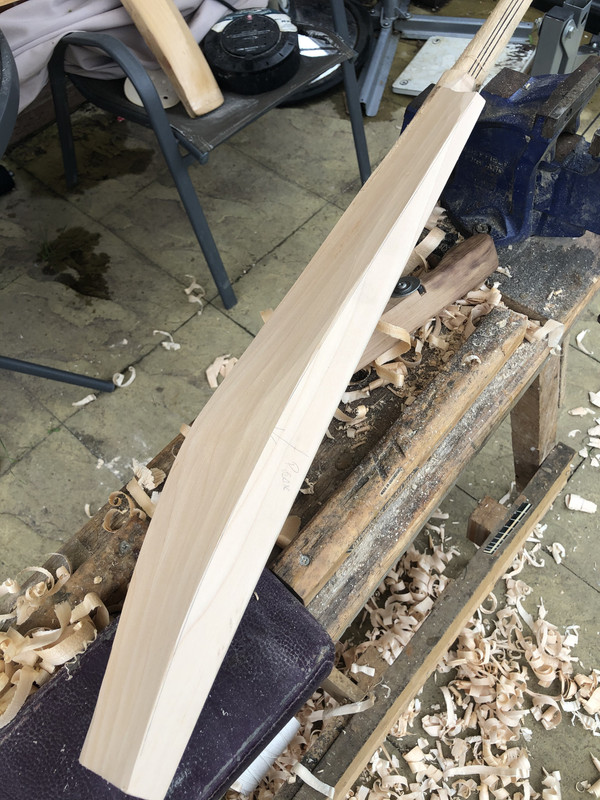

« Reply #816 on: August 14, 2020, 05:06:57 PM »
Taking shape now,,, I’m leaning more towards the scat featured on ijc years ago, so slightly bigger edges and higher spine,,, I may drop the spine height a little, but for now, I’ll keep as much of it as possible,,, the bats picking up amazing at this point, and after weighing it, I’m surprised it’s at 2.9 or so, as it picks up so nice

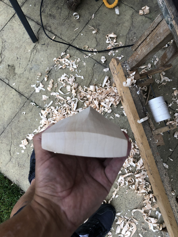

Toe needs a little work

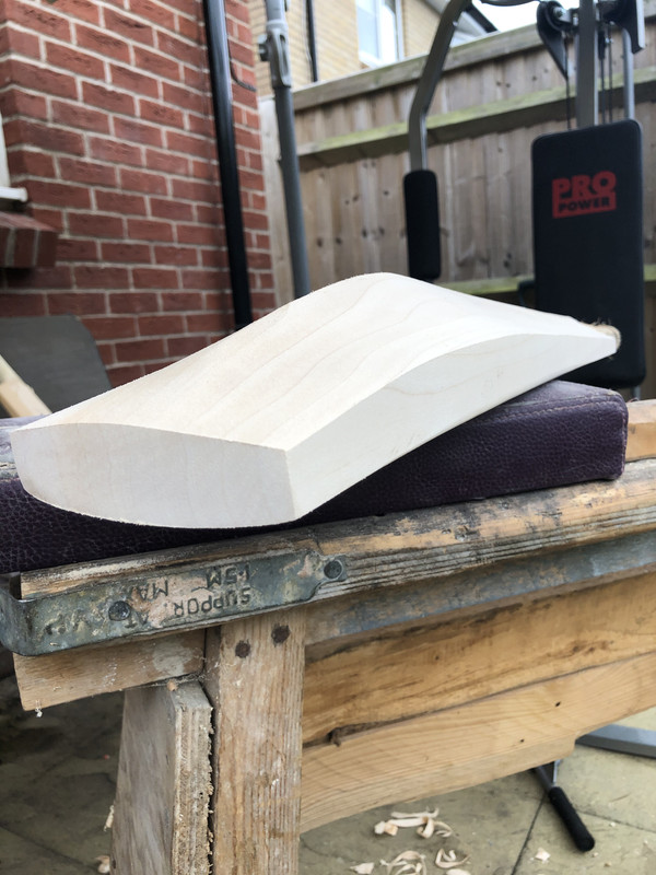

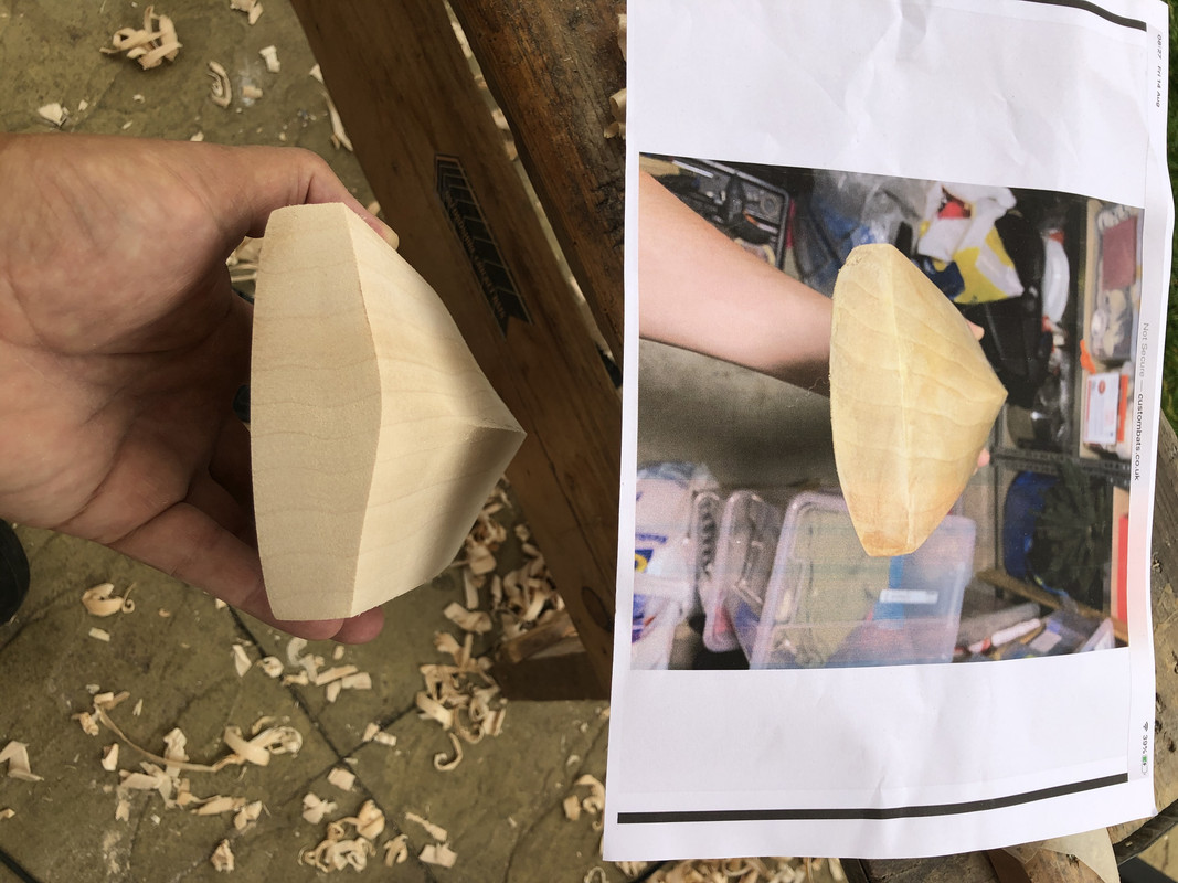

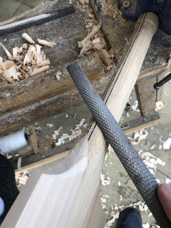

Bit of work on the handle and shoulders, I’ll get a nice oval on the bottom hand.
Re: Northern monkey batmaking
« Reply #821 on: August 14, 2020, 05:19:03 PM »
I’ve not worked to a weight with this, just gone off approx size to the scat pictures and pick up.
I’ll probably drop the edges and spine a little as they are at 36 and 65 at the min, so there’s plenty to  remove if it needs it.
Only scat I’ve picked up, was Simon Mays, and that was a lovely bat, so hopefully I can get this to pick up as nice as that did

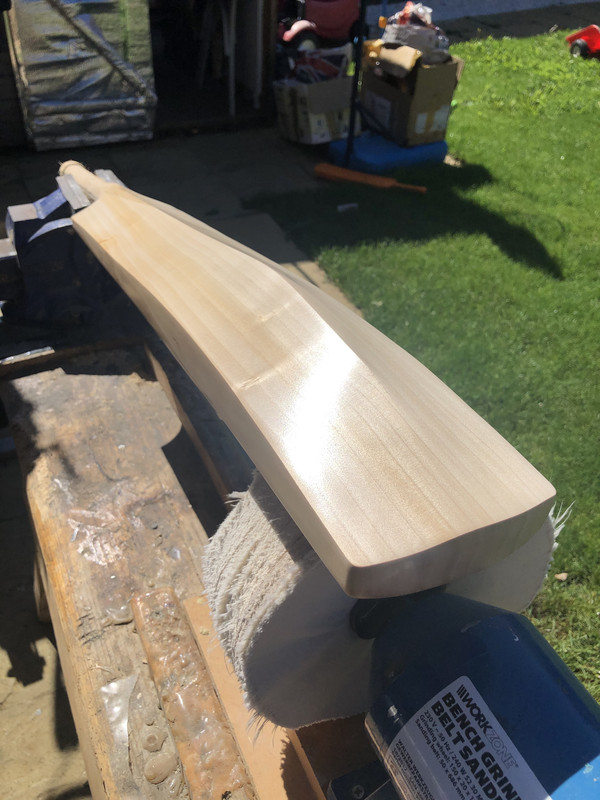

Managed to give the scat bat a little sand and polish
Love this shape
