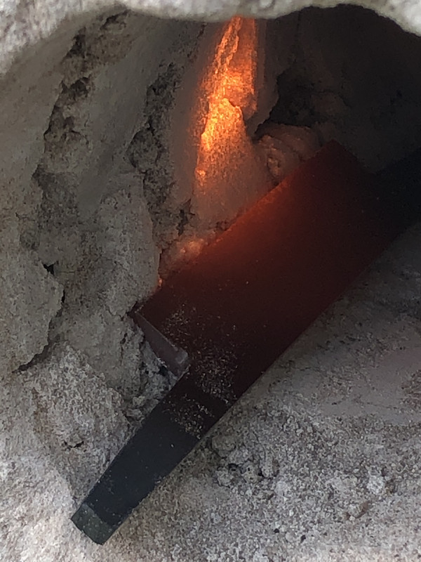

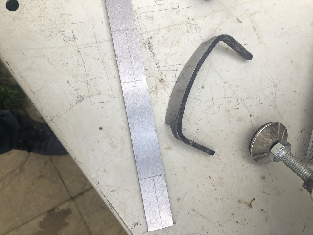

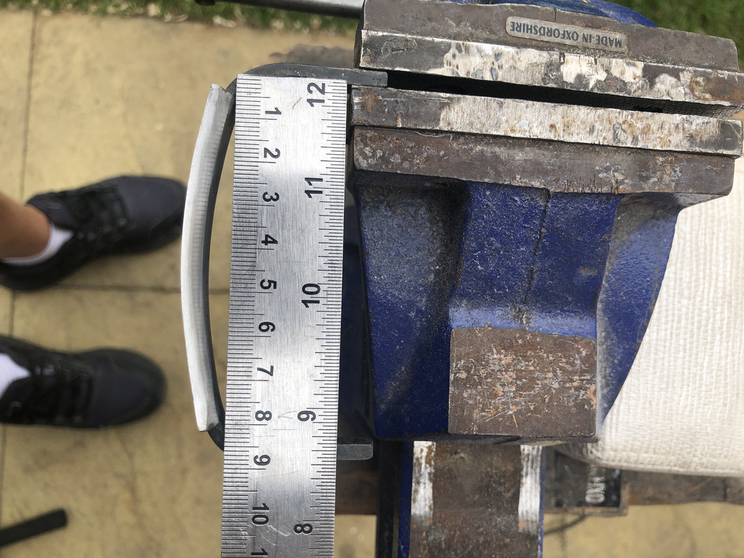

I used 01 tool steel.
I made a little coffee can forge,(you tube)
I forged the curve as per my existing travisher,(bought off here), and forged it around my lathe chuck and my vice, very easy to do tbh
The cutting angle is a challenge to grind and get perfect as it’s a very sharp angle, but tbh I enjoy sharpening them so no worries really

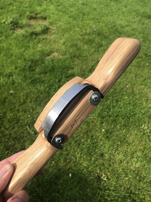

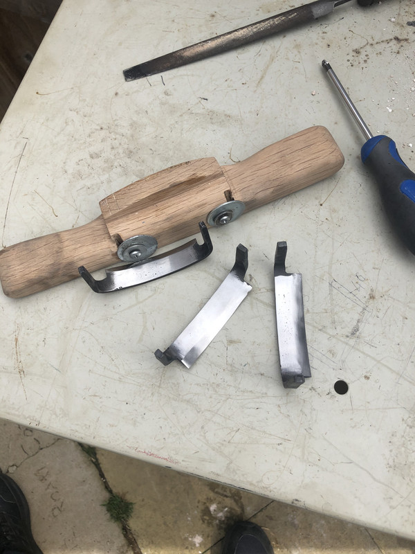

I’ve made one wood body out of oak, and that is shaped to my hands and to the way I use it,(I pull the travisher towards me).
These other ones, I’m going to make a couple of different design bodies, just to try them out.

Hope the pics give you a little idea of the process

« Reply #849 on: September 04, 2020, 10:31:03 AM »
Grubby
  • Posts: 237
Re: Northern monkey batmaking
« Reply #850 on: September 04, 2020, 10:34:03 AM »
That's a thing of beauty.
Are they for sale?
« Reply #851 on: September 04, 2020, 10:40:07 AM »
Thank you
And yes eventually

If you don't mind, what are the measurements of the curve for your typical blade - specifically, the distance between the outer edges of the blade, and the depth of the curve between those points?

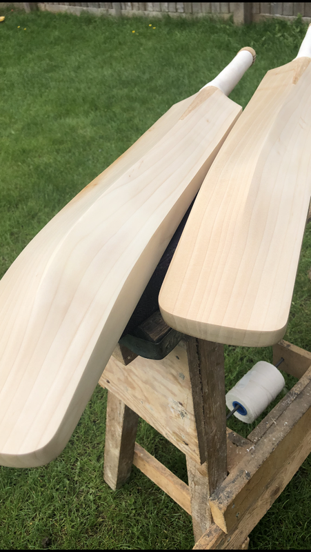

A couple of stunners I’ve just finished off, both gauge busting full profile bats
