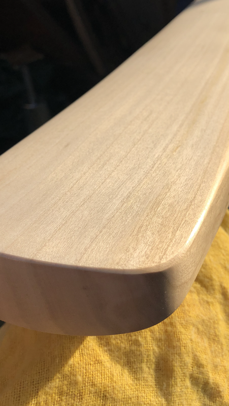

Really pleased to get this under 2.9

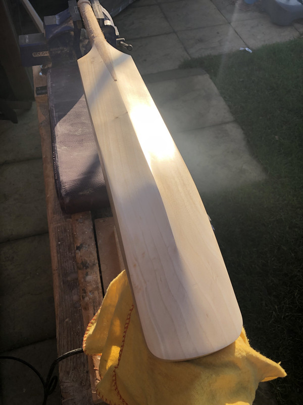

2.9 finished
JB
  • Posts: 2123
Re: Northern monkey batmaking
« Reply #547 on: November 29, 2019, 02:34:34 PM »
The finish on that is perfect!!
« Reply #548 on: November 29, 2019, 02:48:09 PM »
Cheers jb,,,,it’s a lovely cleft tbh, makes it a lot easier when the willows as nice as that
« Reply #549 on: November 29, 2019, 03:44:49 PM »
2.9 finished
Exquisite finish!

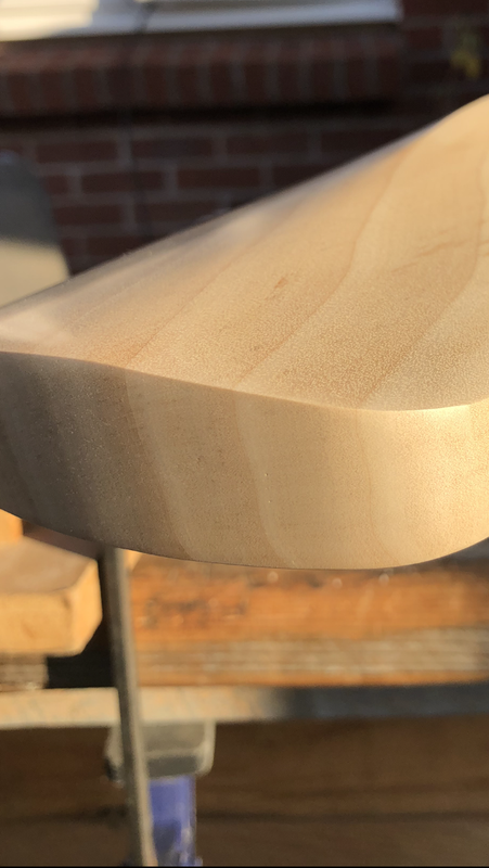

So, you made a thick toe but scalloped it from the back side to reduce weight?
« Reply #550 on: November 29, 2019, 03:54:28 PM »
Cheers internal,,,,,it’s a thickish toe yeah,,,there’s no scallopping as such, as I try to get the toe area rounded, almost domelike.
It could just be the camera angle,,,
The toe tapers down from the highest part of the spine, then it’s rounded off,,it’s easier to do than scalloping it out, but hard to get an even profile across the toe..
For the weight it’s a very very full profile, that spines 62mm

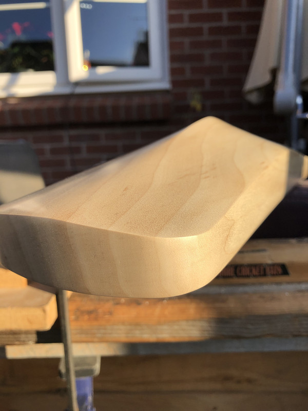

Does that show it better?
« Reply #552 on: November 29, 2019, 04:18:56 PM »
^ Got it. Must be the camera angle.
