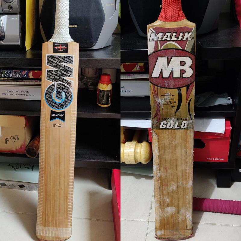

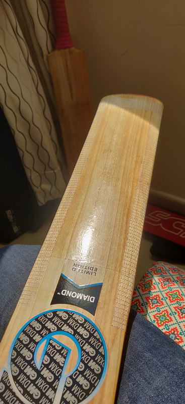

Just did a refurb on a teammate's near 10 year old MB laminate. Removed the old stickers and edge tape, used thinner to get the gunk of. Superglued some edge cracks, hand sanded the entire thing using 80 grit, then used an electric sander with 80 grit. Finished off with 300 grit on the sander. Applied a light coat of linseed oil to the entire thing and let it rest for 2 days, finished off with some batwax and new stickers and grip (that he provided) and scuffed it up. Think it came off pretty well and my friend is losing his mind cause its his favorite bat.

Nice work, those GM stickers look smart.

FTFY  ;) Good job on the refurb though. Always satisfying to make an old bat shine again 👍
Well offcourse they're fake lol. Dont know where he got them from but he wanted them on

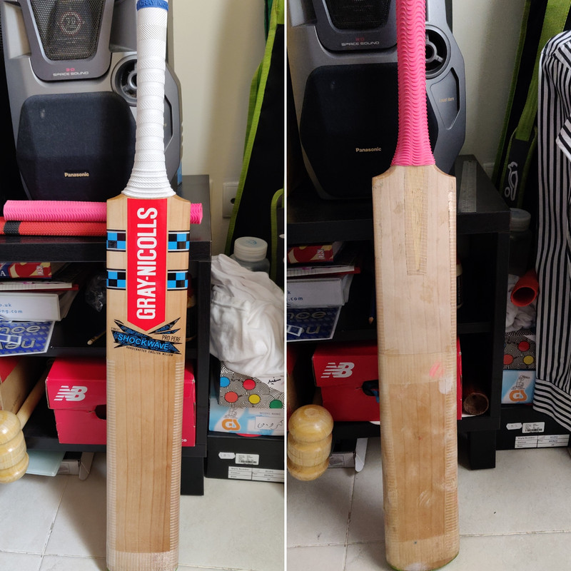

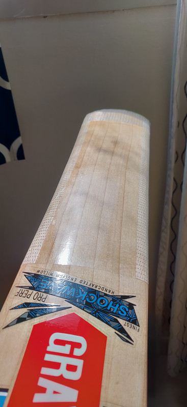

Another one done on a teammates old 90s traditional puma. This one was a much easier job. Just removed the old scuff and edge tape, sanded down using 100 grit first and finished with 320 grit for a smooth finish. Oiled and rested for a day. New stickers and grip, batwax and new scuff sheet and edge tape. Owner was really happy with this and so was i.
