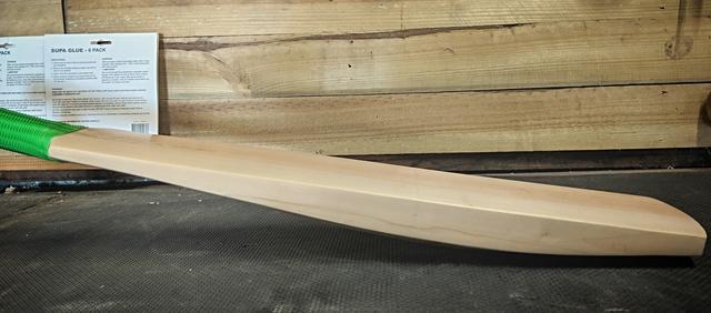

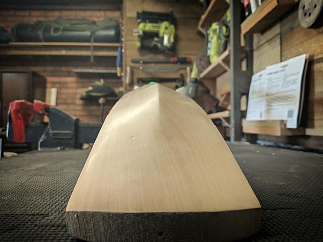

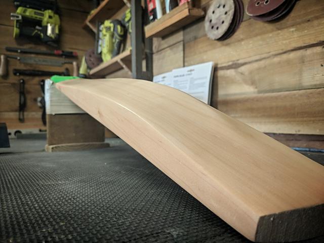

I've always wanted to make my own bat, and after a chance EBay encounter last week, I was able to make this dream come true. Last week I noticed a few handled clefts for sale on eBay and After umm'ing and ahh'ing for all of 30 seconds I decided to take the plunge!
Here are the results..
I thoroughly loved the whole process and cant wait to do it again! My goal was to create something that was entirely useable and that I would be proud of walking out to the middle with and personally I feel that I've achieved that with the bat feeling great and weighing in at 2lbs9.5oz with the edges peaking at a modest 30mm and the spine at 51mm (very much a bat for the traditionalists)
The tools I used were as follows.
. Straight drawknife
. Block Plane
. Orbital Sander
. Rasp
The things I feel I could do better next time would be to leave more wood in the toe, and spend more time shaping the handle (although I was limited as the handle on this was already cut very thin towards the bottom and I didn't want to risk taking too much off) also, I would really love to find a plane with a rounded bottom to not rely on the drawknife so much in the final shaping. Please do note that I still need to do a finishing sand and a buffing, I just didn't have a few things available at the time of finishing.
Please share any thoughts or constructive advice for my future endeavours!

Re: The first of (hopefully) many
« Reply #8 on: February 15, 2019, 06:00:33 PM »
Cracking job
Get yourself a travisher

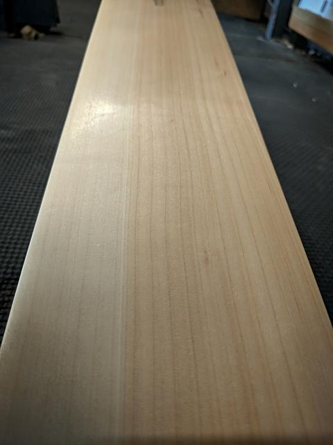

« Reply #14 on: April 14, 2019, 06:30:26 AM »
Number 2!
A big thanks to John at @Red Ink Cricket for sorting some lovely clefts out for me, and answering all the questions I had along the way.
Specs:
EDGES: 38mm
SPINE: 62mm
HANDLE: Medium Semi-oval
PROFILE: Full
MIDDLE: Mid (shape is based loosely on an Aus GN legend)
WEIGHT: 2lbs9.5oz (picks up 2lbs8oz)
