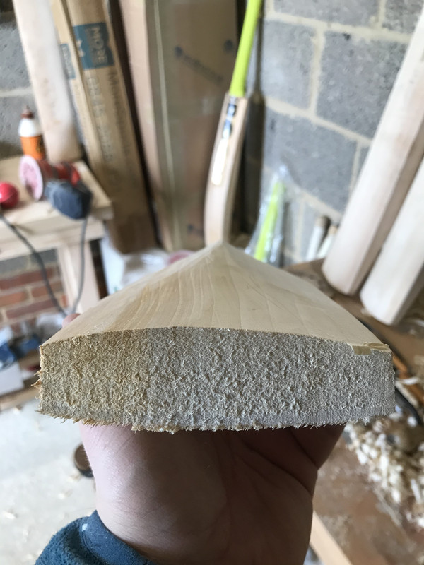

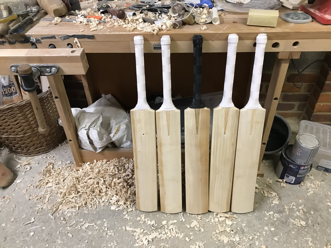

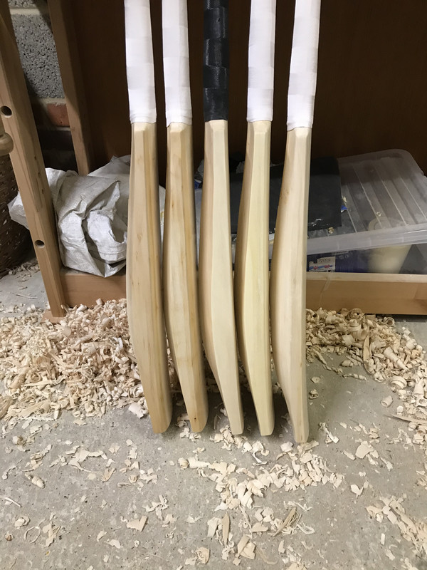

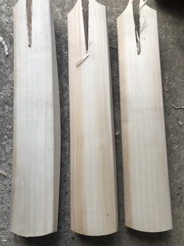

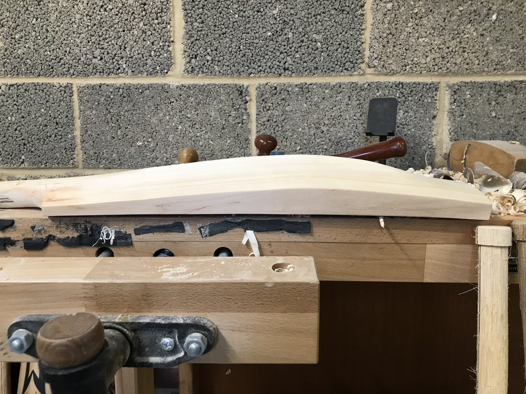

Clean up of the workshop and shaping of 5 SL06 profile orders with various requests for swell position. Also an arty pic kind of
Profile pics of the said 5 x SL06 shapes after initial shaping stage.

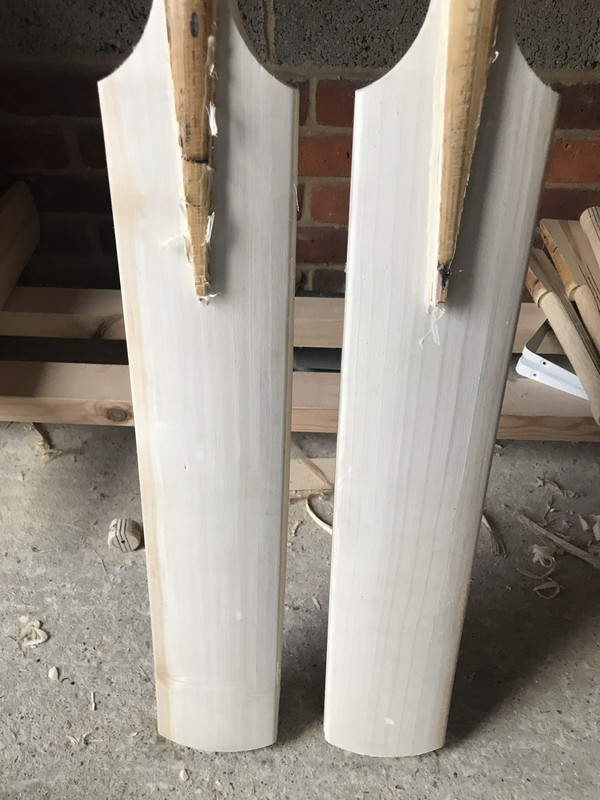

A couple of available clefts that Iv now takes to sanding the face prior to grading to allow a more accurate identification of what will sand out and what’s in the playing area. This is a lovely clean G2 all sapwood

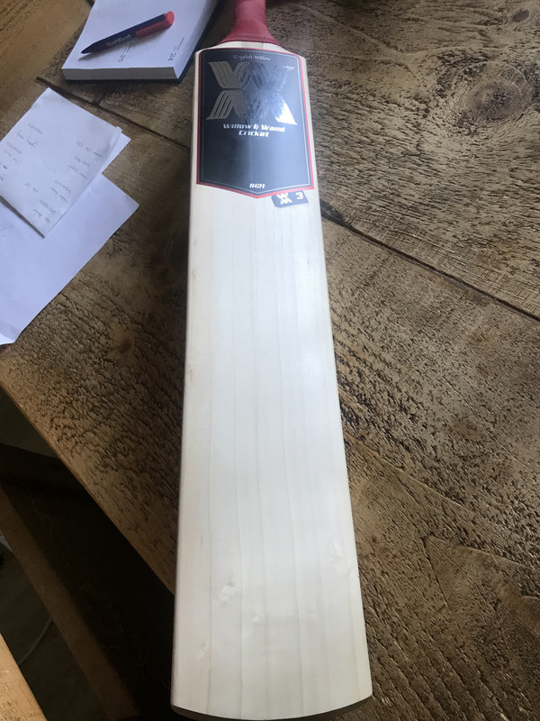

Some new sample stickers on the G1 that I finished earlier this week.

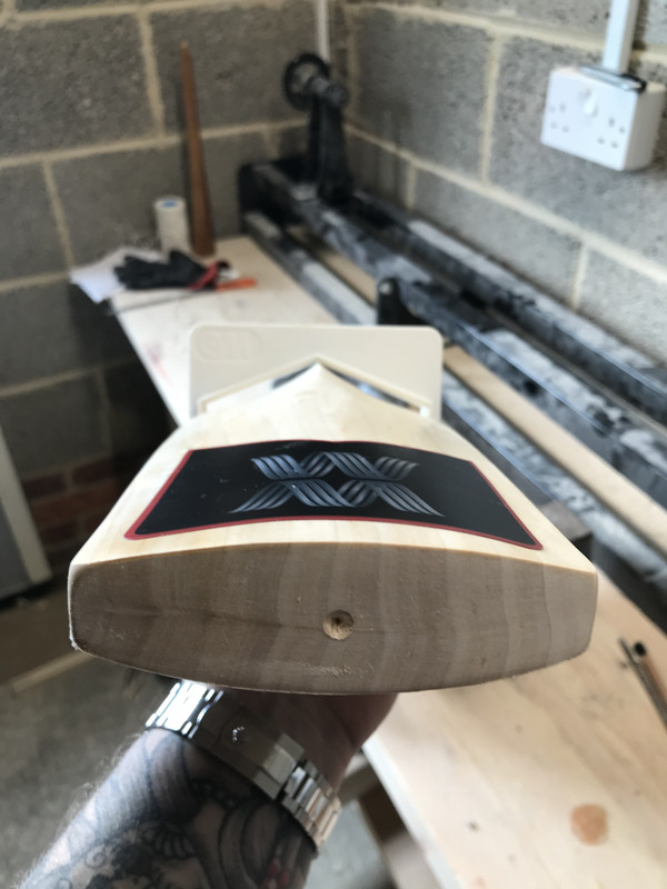

My new match bat for this season Sanded, polished and fits comfortably through the gauge.

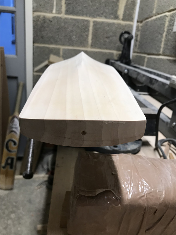

Trying to show the attention to detail that probably quote often gets overlooked, how the toe is rounded into the edge to allow the bat to slide in when running between the wickets and also how the blade is hand sanded into the toe to ease feathering of the toe.

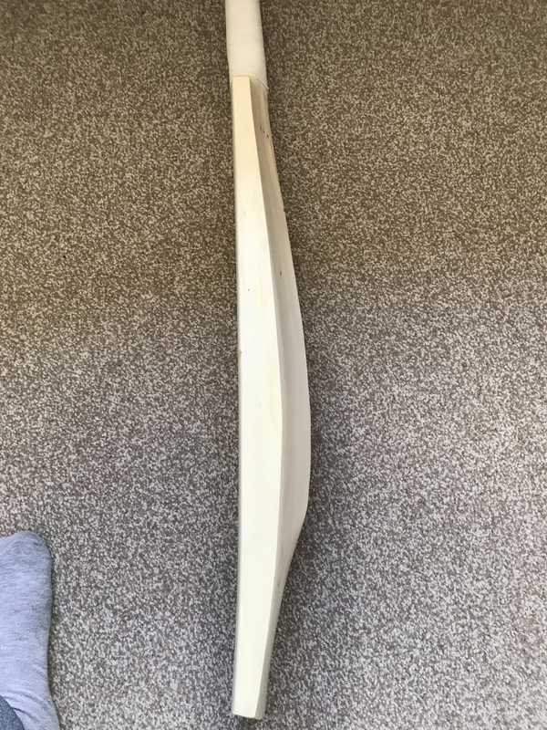

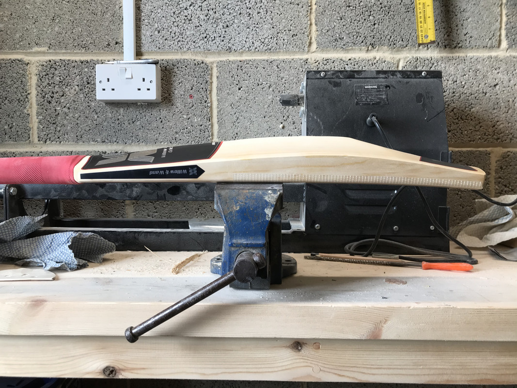

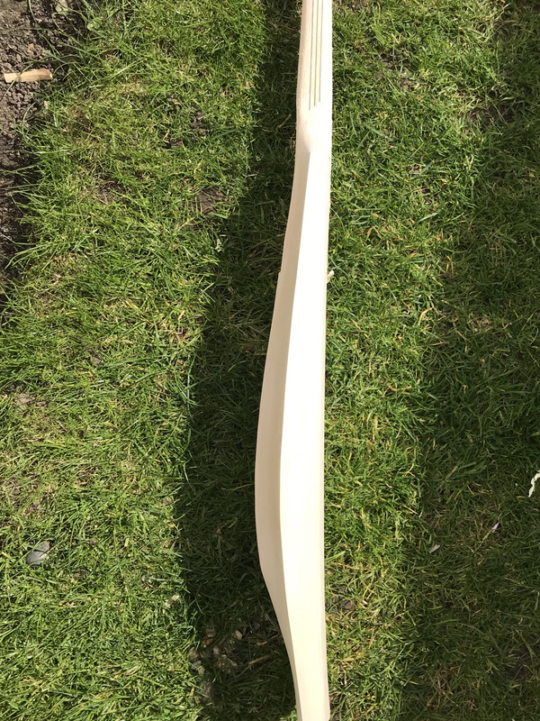

Finally been playing around with the new profile shape I’m adding to my range and this one will also likely end up as a special offer on the bases of getting some feedback from those that use or have considered a higher swell position.

Nice looking shapes, Chris I like be the higher middle position shape
Dave is correct and the article he linked is a very interesting read from Streaky - what he says makes a lot of sense
You should get a higher middle position shaped bat Dave, you have been striking the ball higher up and you are always wanting to add to your collection...

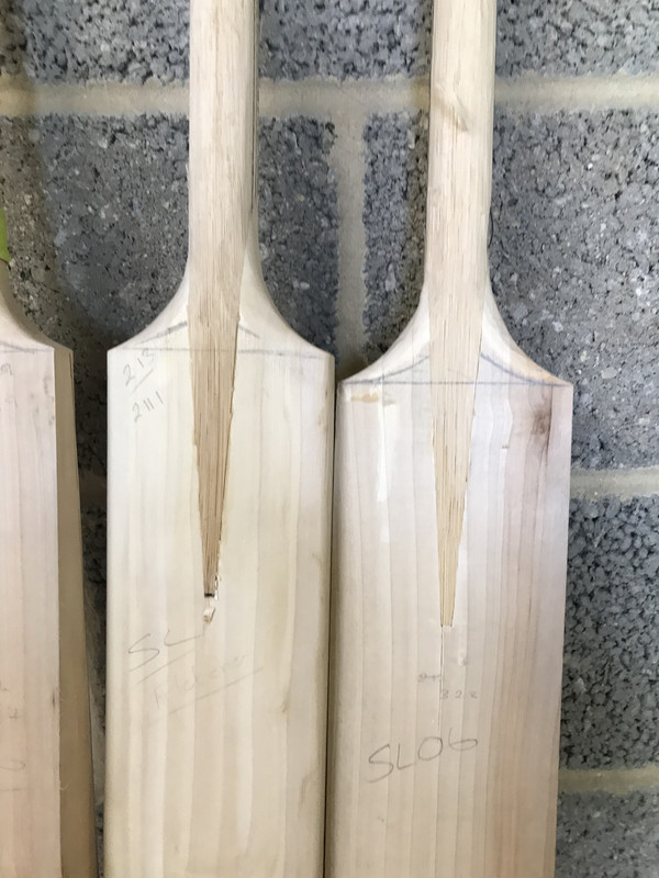

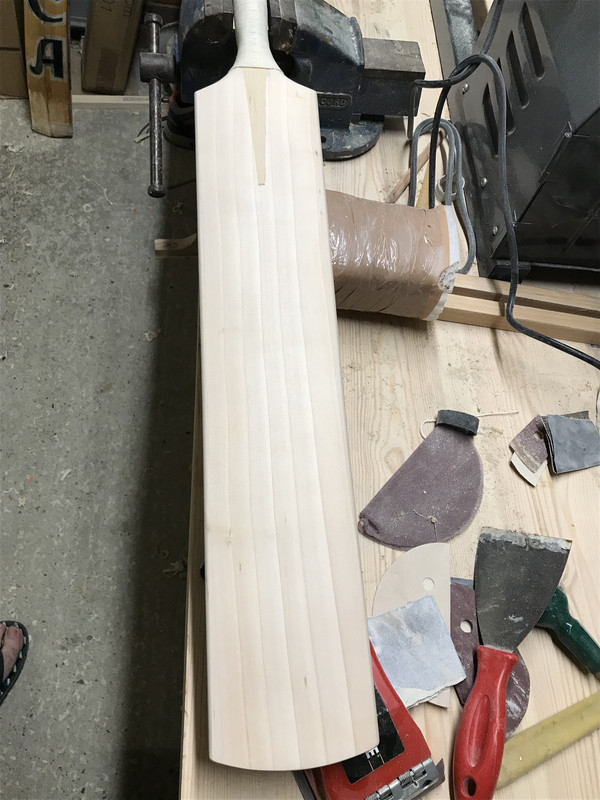

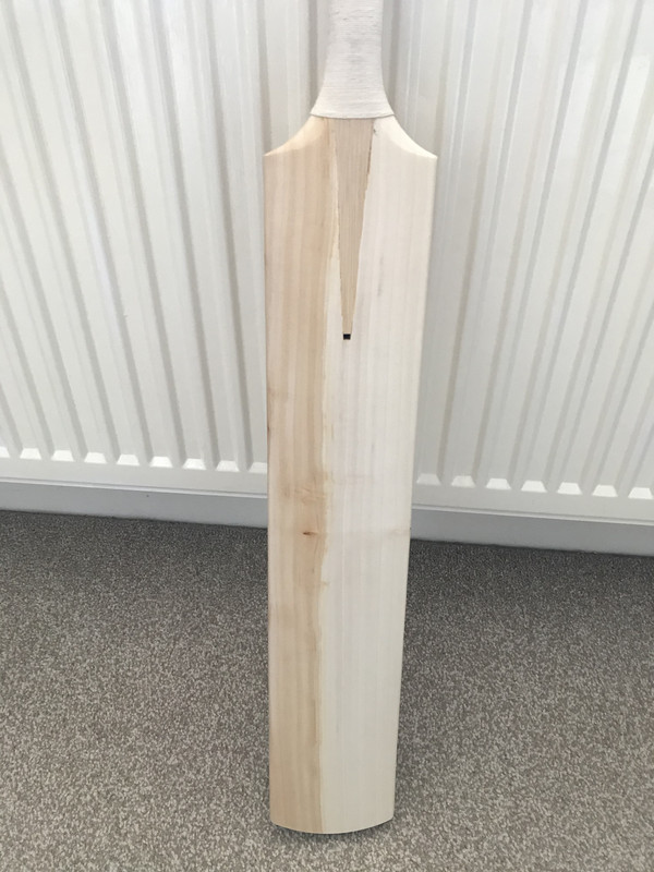

So here is the bat I originally made for myself for this coming season, slightly higher swell than I make in the stock SL06 shape as that’s just my personal preference. Weight is a shade under 2.10 and specs are modest with 35mm edges and a fairly full profile.

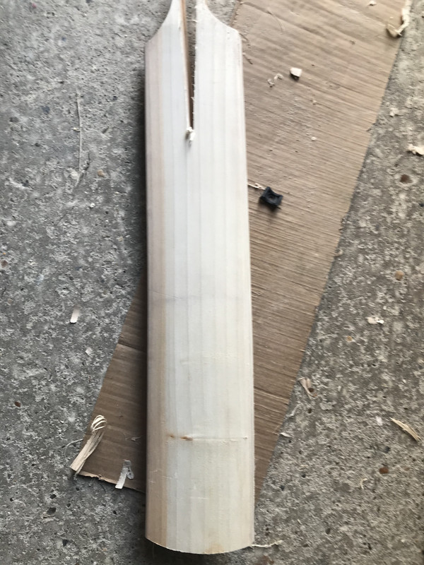

However the cleft I had on offer with the knot in the back that I put up for an offer price last week I managed to split slightly when fitting the handle. Spit is jut down from the splice on the front of the bat.  Totally my fault in that I took a bit off the handle as was quite snug and then went in doors to put the kettle on and picked up the wrong handle I guess from the bench. Fitted the handle clamped over night and then the next day started shaping it and noticed. This poor cleft isn’t having the best of times. Anyway shaped it into an AM18 profile. Will be some quite big specs on this once finished.
This will just end up being my bat for this season along with the other one as this may not last long! Fingers crossed as it’s as pingy as it is grainy.
