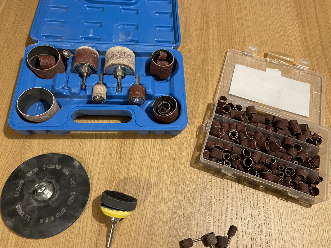

How did you create those templates? Also, can you add pictures of the drill sanders you used?

@InternalTraining Here are the things I used. Mostly the ones in the blue case, but they’re coarse so had to be careful. The discs were pretty good too, especially with the foam as it was more forgiving. The tiny cylinders are meant for Dremels and weren’t much use for this bat in the end. For the templates I drew the shapes to scale in Adobe Illustrator and printed them out, stuck them on cardboard and cut them out.
And other things used that I forgot to mention:
Stickers - Diginate. Really good service, stickers are nice, colours came out bright, and were much cheaper than the reverse printed ones. Not sure yet if they’ll smudge when hit. The stickers on this bat have metallic parts, which look great, but I also got a set with transparent background and the colours are a bit brighter I think. https://diginate.com/
Oil - Salix linseed wax. Really nice to use compared to the mess I used to leave with the oil. Just one coat.
