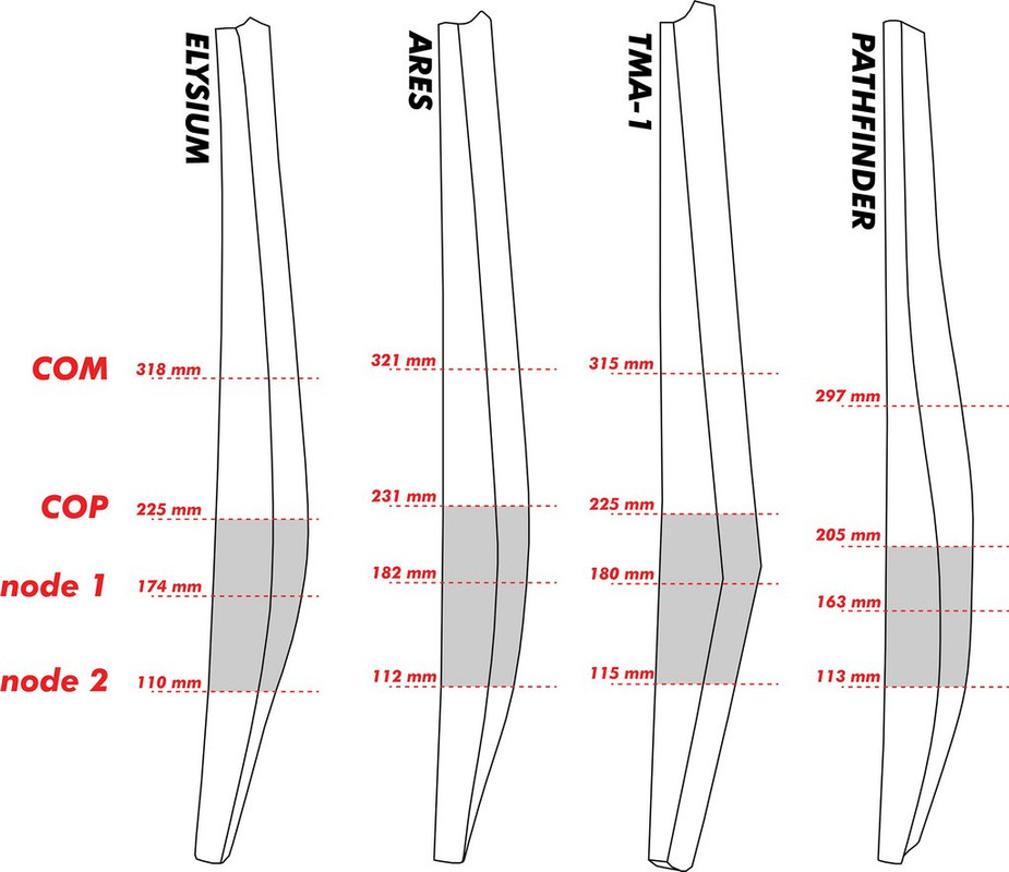

Hopefully not labouring a point here, but one reason I tried to simulate the bats I made was to be able to compare them quantitatively, to try to put numbers on how a bat 'feels'. I don't know if I've achieved that, but in the future I should be able to simulate any bat I can get the measurements of, so if anybody knows of any strange or interesting shaped bats then please do let me know. I'd love to try to figure how differently they perform.
In the meantime, I've seen variations of this image by Gray-Nichols in a few places over the years. It shows where the maximum edge and spine are, and also where the middle should be in each bat. I quite like it for being a quick way of comparing the different shapes.
So I combined the results for all 4 of the bats I made and put them in a single, similar sort of image. Again, the shaded region is just the area between the Centre of Percussion (COP) and the lowest vibration node that is relevant (node 2); this area is just one definition of the middle, and performance (however you measure it) would drop off gradually like in the GN image, rather than stop abruptly.
The first bat I made, which was based on an artificial intelligence design, is the Pathfinder on the right. It does have a noticeably lower middle than the others, which is reflected in how the pickup feels to me, but I would never be able to say by how much just through handling it.

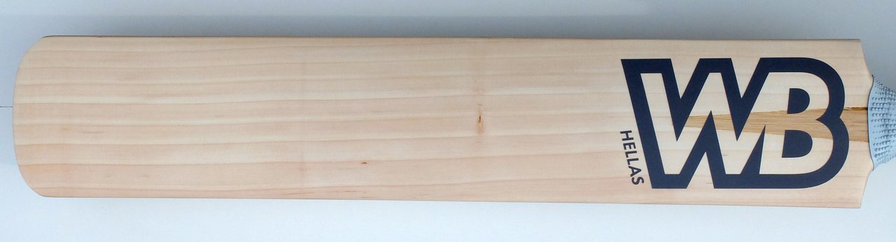

It started with a grade 2 part-made from Hell 4 Leather again. One of the main reasons that I couldn't quite follow the design I wanted was that there had just been a bit too much wood already removed when I got it. Wouldn't be a problem for a normal bat, but for the intended short and fat one I had in mind, it meant that I had to scale it back a bit.
If you look about 3/4 of the way down the blade, you can see a bit of a knot. It worried me at the time as you can see how the pressing hadn't managed to push the face down there. It was probably raised by about 2-3 mm right across the face. More on that later.

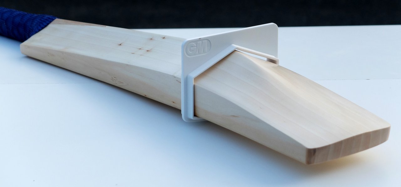

Here are the dropped shoulders. I tried to make the bottom part of the handle a bit more oval, as it feels more comfortable to me, and you can see it's a bit skinnier there.

And that knot. What a pain that was. As I tried to sand the face level, more and more of the knot revealed itself, and it was a bit nasty. Some real dark, dead wood in places, so I really spent a fair bit of time sanding as much of it away as possible. It's not ideal, but it's only for me.

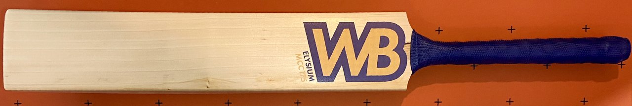

Anyway, the final profile. It ended up being a little different to my planned design, just because the part-made didn't have enough wood in the edges or middle to get what I wanted. But I still quite like it, and can't wait to try it out in the nets soon.
Final measurements:
toe: 12 - 27 mm
edge: 37 mm
swell: 63 mm
shoulder: 16 mm
weight: 2 lbs 10.4 oz
blade length: 530 mm

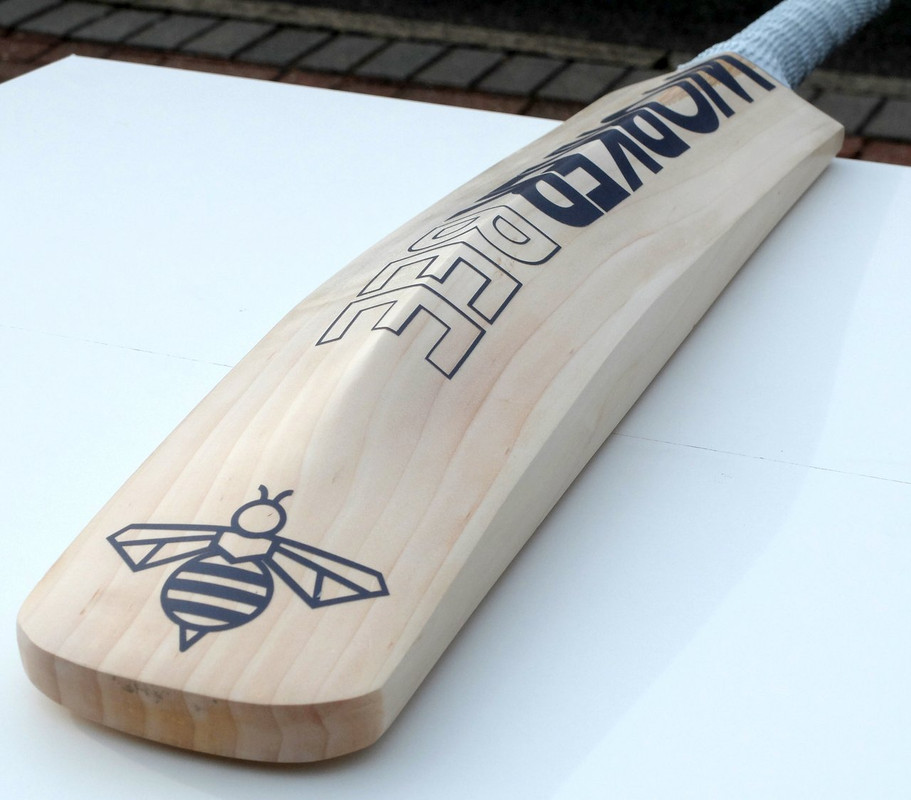

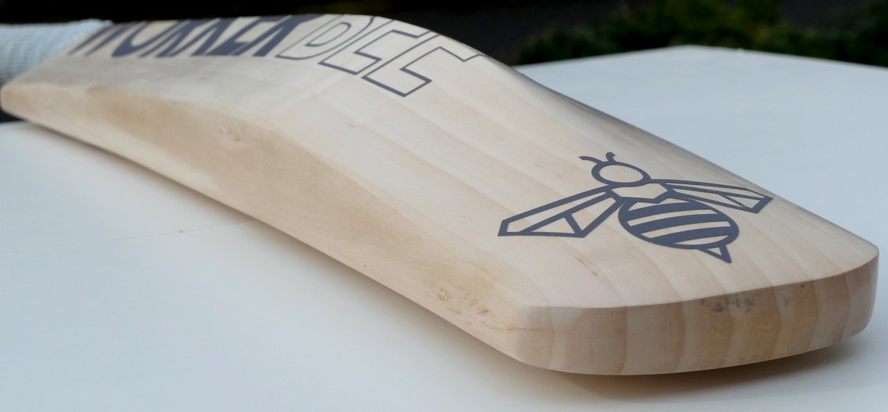

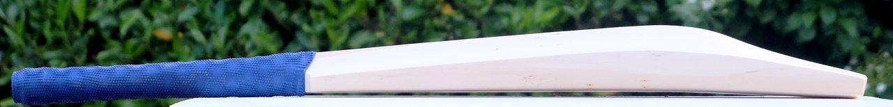

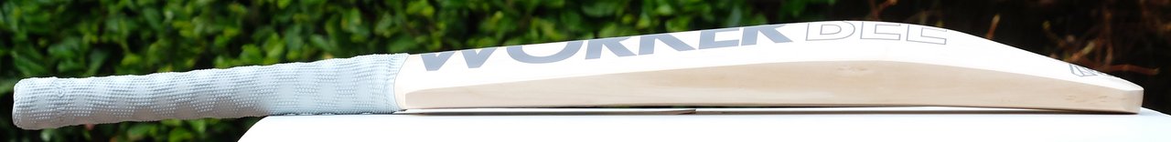

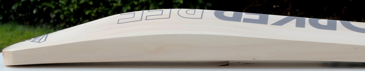

Not a new bat as such, but an updated one. I thought that there was no point in having a bat shape that I didn't like and would never actually use. So I attacked my bat from this post (http://custombats.co.uk/cbforum/index.php?topic=48259.msg785936#msg785936) with a spokeshave, with the aim of making it look a bit better and maybe losing a little weight.
I managed to take the weight down from 2 lbs 10.8 oz to 2 lbs 8.2 oz, by removing the weirdness from the toe, and reducing the maximum edge size from 35 to 32 mm. There's no concaving at all in the lower half, and maybe 1-2 mm in the upper half.
I MUCH prefer the new shape! And I gave the stickers a rebrand, which helps it feel new.

As much as I loved the weird precursor, that is a lovely profile. Old school with a little modern twist on it, I'd be happy with that any day.

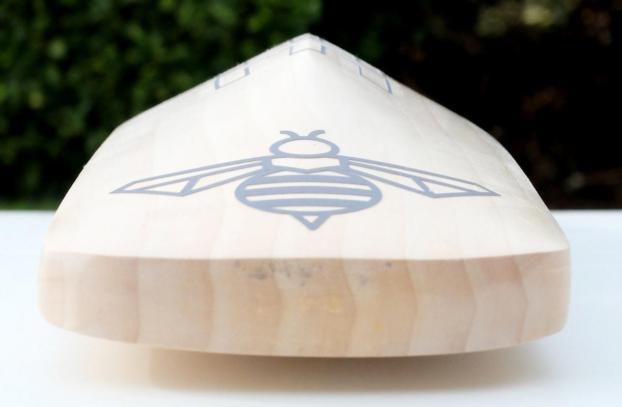

« Reply #69 on: March 11, 2022, 12:49:04 PM »
Fantastic pictures, love the one of it looking down the back of the bat. Great work

Ah it's nice that you say that, as I was looking at my old Mjolnir as a guide, but I just couldn't get close to its profile because of what I'd already done before. Maybe next time...

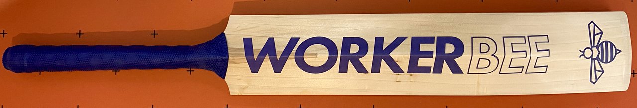

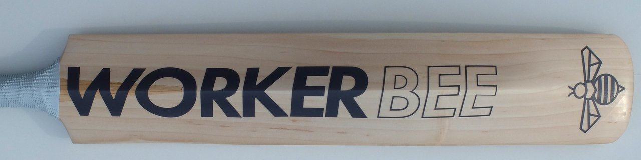

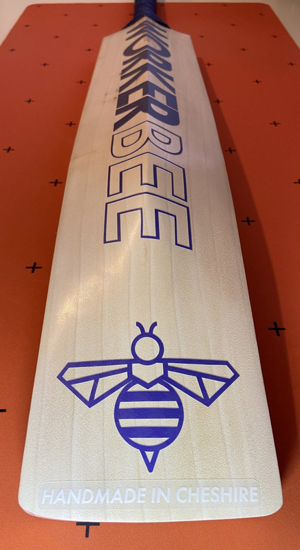

I found an exuse to make another bat! This one is to be given away in a raffle for my club's anniversary, and I think I've accidentally made a @jonny77 profile!
Again, part-made from H4L, this time a Grade 1. As it'll be for somebody else, I thought I'd make it as big as possible! Very noticeable duckbill toe, comes in at 2 lbs 10 before grip and stickers. I'm hoping it should be a good 'un for someone.
