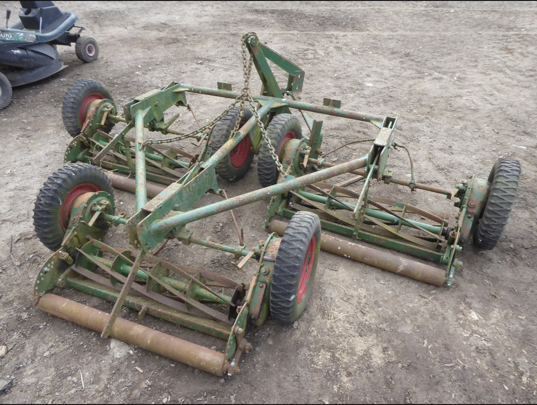

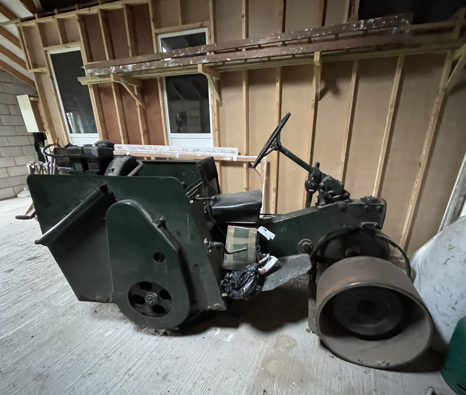

Yes mate - both need slightly more than a service
That’s the actual roller & it’s this type of gangs (even I don’t have a picture of the actual gangs)
I need restoration contacts not service contacts pls.

Thanks for the roller tip - that’s the best two from what I can see as well. Roller needs a full refit - it’s not safe currently

The gang mowers won't be a specialist fix, they're trailed so no motor.
Bearings will need to be checked or replaced and make sure everything is free, lubricated. Then the blades will need to be sharpened.
See if you can find a construction plant mechanic for them.
I've got a fitter at work that fixes all our construction plant but he also does our groundcare equipment.
Roller will just be engine, hydraulic pump and motors. Hardest thing will be getting the spare parts
