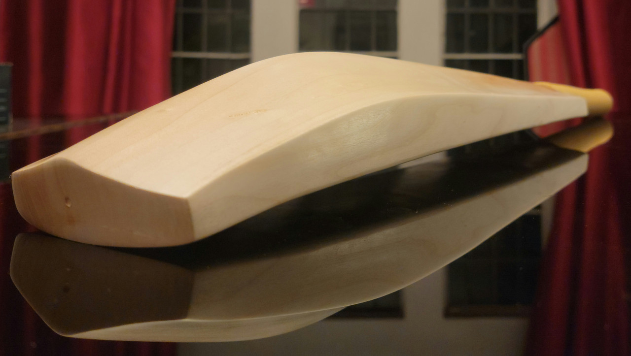

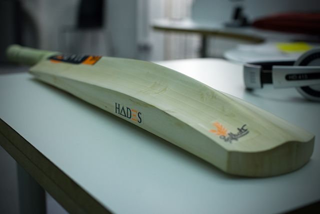

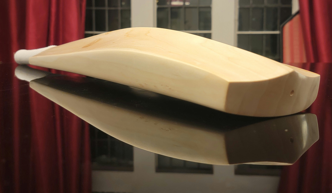

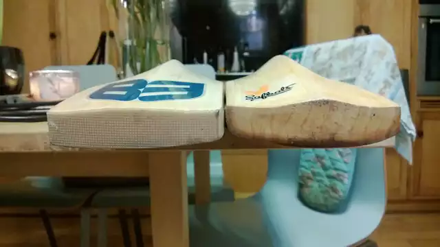

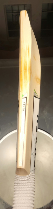

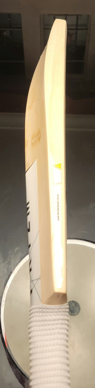

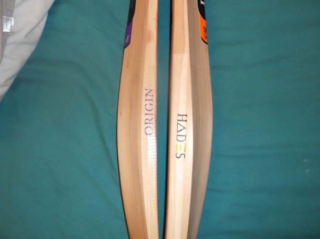

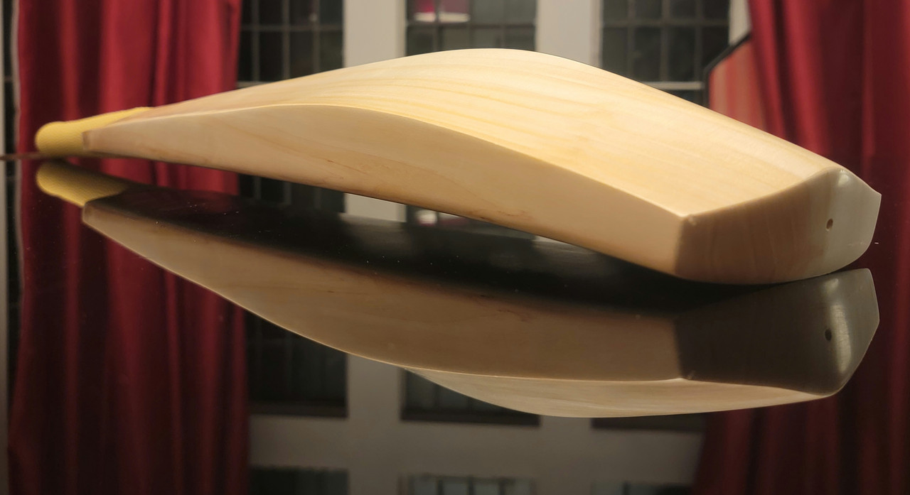

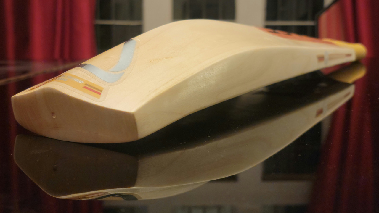

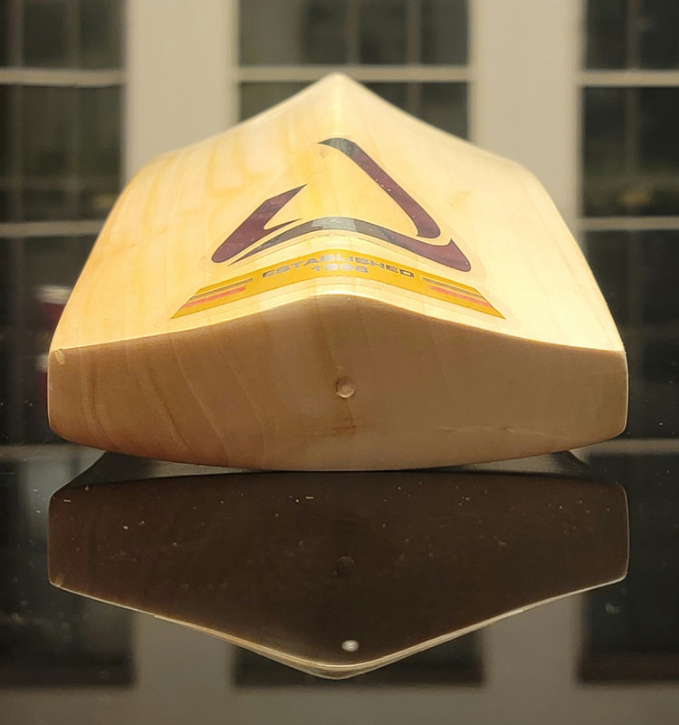

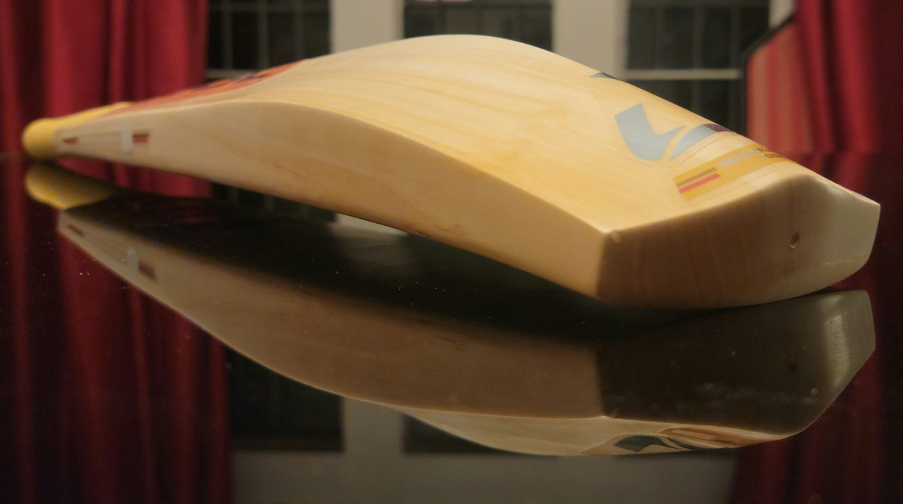

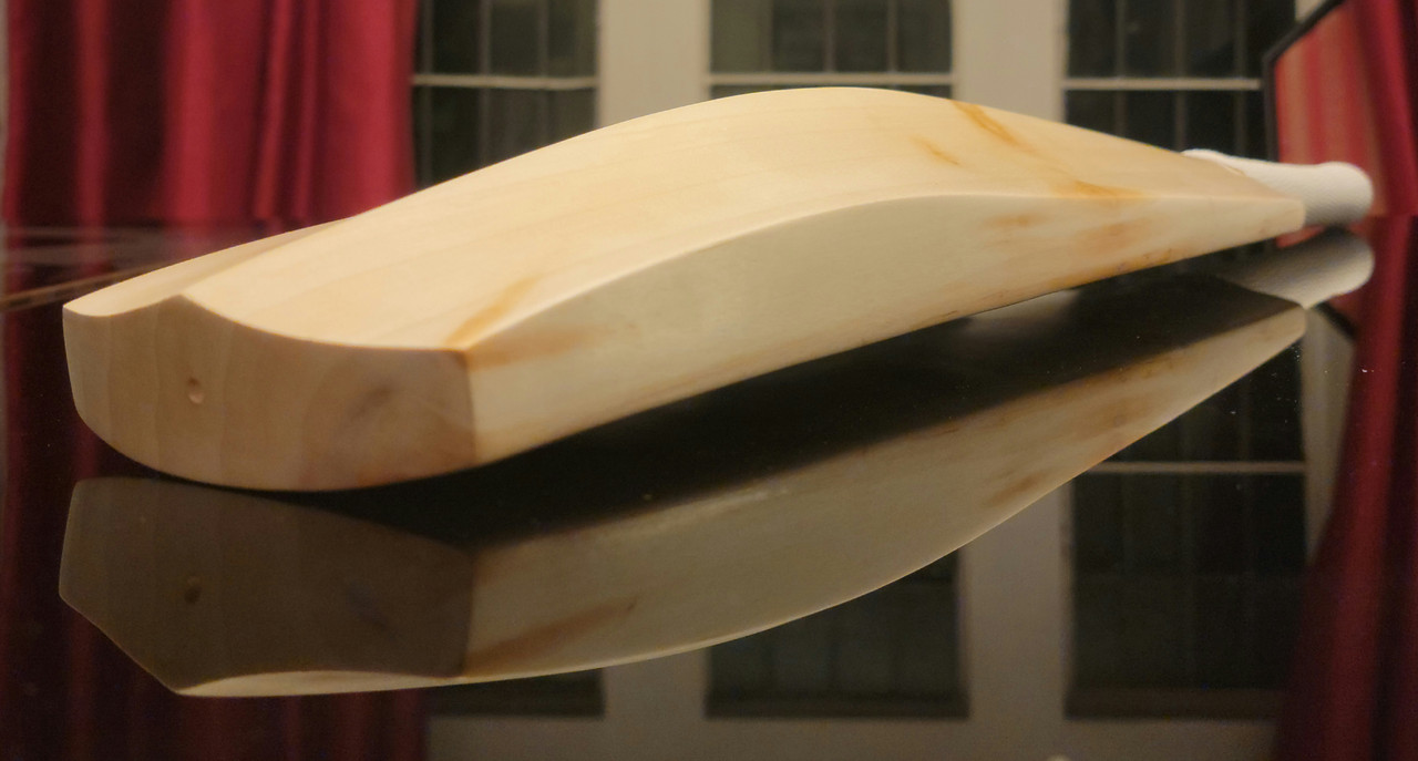

Right, so after getting over being a diva and being annoyed with myself, I brought myself to rectify the dent somewhat, and just finish the bat. I'm not happy with it, there are definitely areas where I really messed up, but here goes...
Bat number 22 (? - lost track)

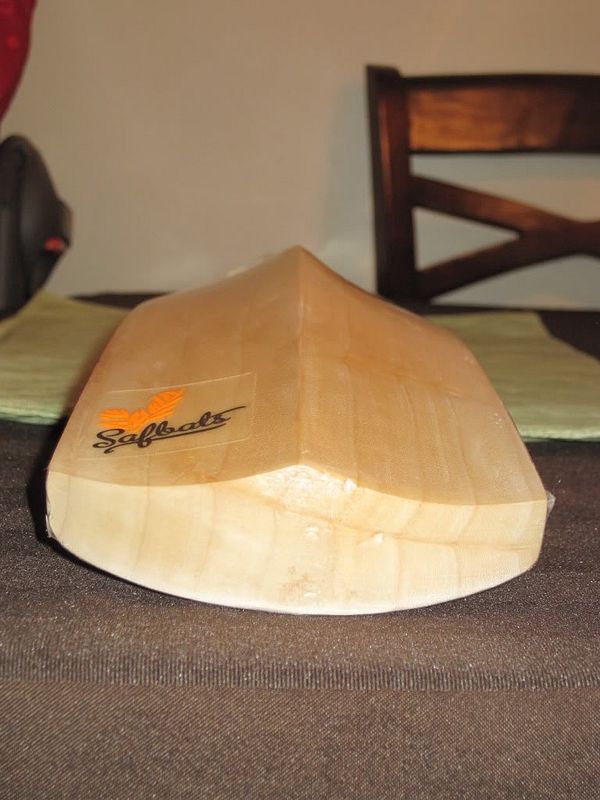

Decided to try make a SAF Hades, or at least try take into account the theories behind the profile and whatever ideas about batmaking Andy had, etc etc. Also to try use up some of the heavier clefts I had...
Images I worked with...
Aims/Learning Points
  • Had messed up 2 previous attempts by shaving too much off - going to try keep as much on and slowly whittle away
  • Sometimes edges offset naturally - with this profile, I was wanting to intentionally exaggerate this
  • Keep a high spine
  • Try to attempt a C-V profile (convex up towards the splice, and concave at the lower half of the bat to aid with balance/pick up
  • None of the pictures I used were really that consistent - they all varied enough to make them look quite different, so was up to me to try interpret it
And lastly, dressed with some Pryzm stickers:
Things I could have done but didn't
  • Finger tapping as I made the bat. to try test for rebound quality as I shaped. (Dunno if this worked, and would just be me being pretentious if I did it)
  • Put the bat in a vice when adjusting anything (Still bitter about the drop)
  • Rounded the spine more rather than keeping it sharp (I had it rounded initially I think, but needed to concave more to balance)
Difficulties Encountered
  • Not an easy profile to sand or shape - the high spine and the offset in the edge made it a bit awkward
  • Keeping the spine high was a little difficult, and curving it into the toe while keeping a nice flow to the profile was a bit of a challenge. (Not quite sure I've nailed it)
  • Having to resand and refinish numerous times was a pain
Conclusions
All in all I feel the attempt was a fair one - not an easy one for a novice like me to make, but I think I tried to keep as faithful as possible with things like face camber, high spine etc. Maybe I ran the spine too much into the toe, and needed to exaggerate the curve a little more into it, but I didn't want to make it a straight line by mistake. I do think the pick up is decent for the weight. The spine doesn't quite run flush with the middle of the bat if I look and measure carefully, but it's off by a little - this was probably because I had it more rounded prior to the slight rebalance. I may try another attempt with another cleft at some point, but for now - I think I've scratched my itch for attempting this 'cult classic' profile.

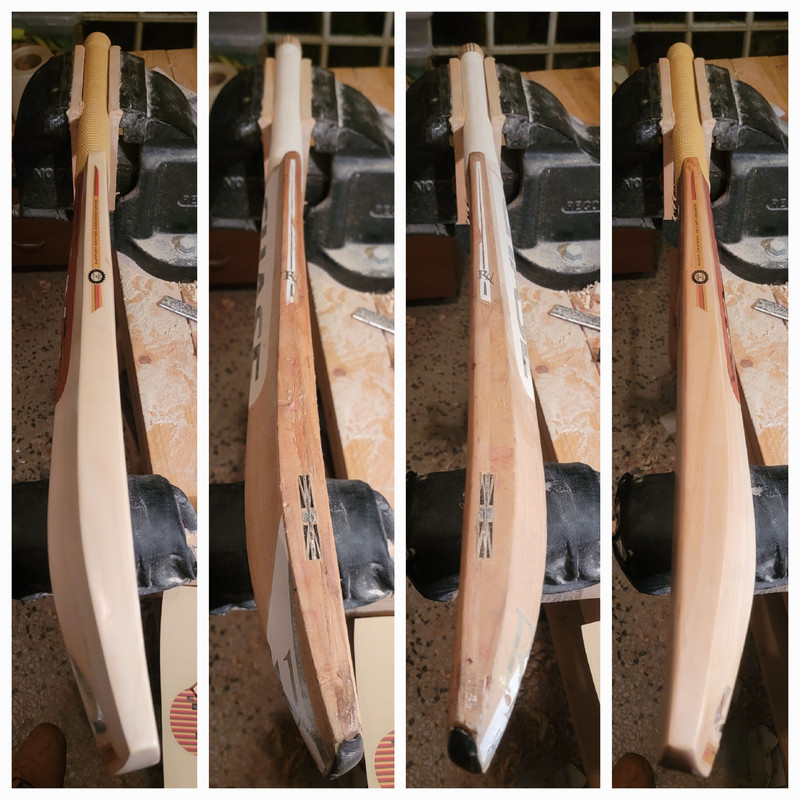

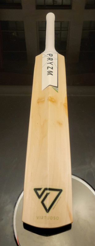

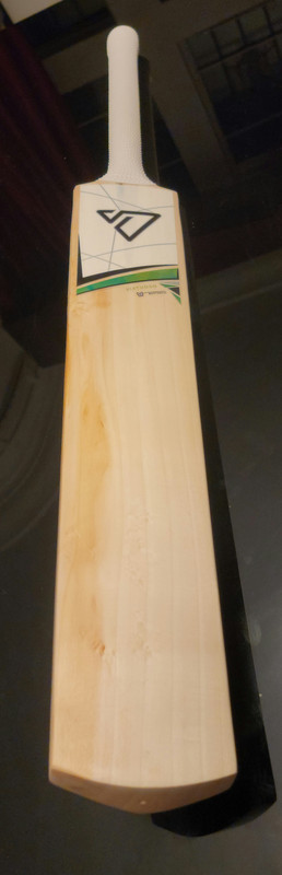

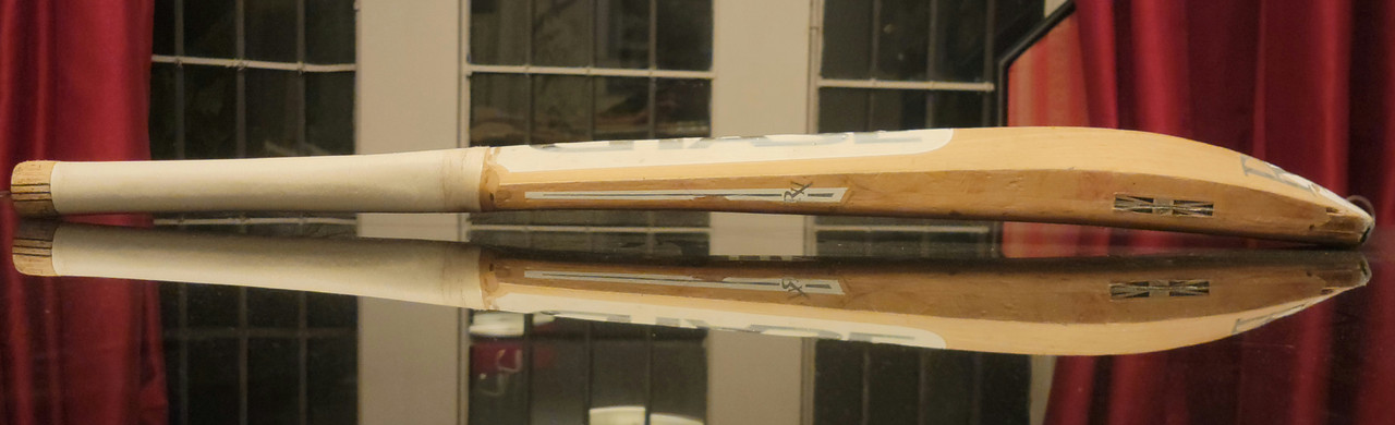

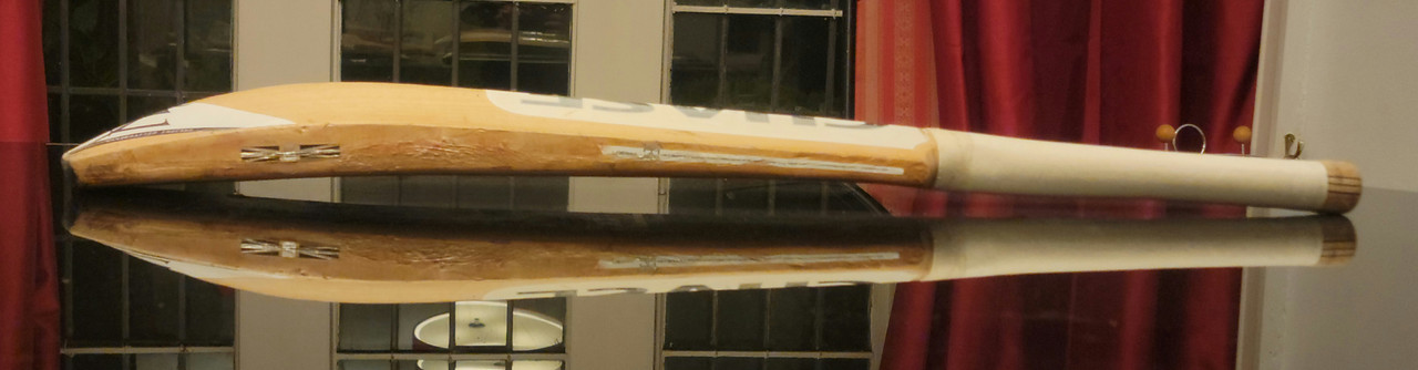

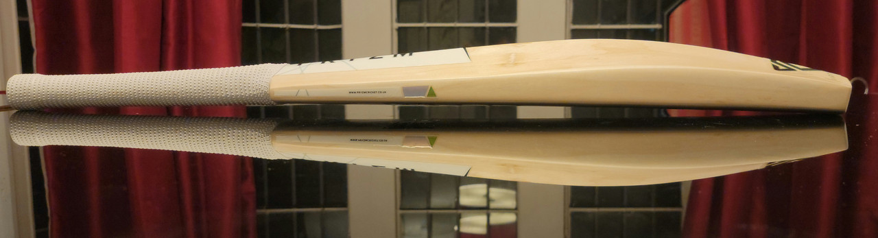

Right, so I had actually been making up 2 other bats alongside the Hades attempt. I had a repair/refurb in, and it was a bat I sold on many moons back - a Chase FLC, which really didn't appeal to me too much back then. But after seeing it back in my hands, I grew to like the profile more, and felt it made a lot of sense on the slow and low pitches we tend to play on. The pick up was also amazing for something with such a low swell - so I felt compelled to make a sort of replica to consider as a stock shape.
The assignment
Learning objectives
  • Try to make a well balanced bat with a low middle
  • Keep the spine running into the toe
  • Try not to butcher the bat
  • Try figure out what kind of weight I would get from this weight of cleft
  • I wanted to try get as close to the profile as I could as a challenge
  • Try get the bat to pick up well - this would require a bit of work in terms of shaping, and also in willow knowledge for cleft selection. I picked a cleft with butterfly stains up the top above the balance point, in hope that it was just denser higher up above the balance point, so would act as a bit of additional counterbalancing if coupled with thicker shoulders
End result (Post shape and finishing)
And of course, with the plethora of cricket bat related items I have around, I had a set of Chase Lancer stickers. (Thanks to whoever I acquired these from - I feel they really suited the profile and also the willow itself)
Personal Thoughts
I thought initially that I had done really quite well - I was really very happy with the end result of the bat, it picked up quite well for the weight (2lb 12oz) and the shape looked very similar. I managed to even have the toe thicker in the centre, and have the bat bigger overall with a more defined spine, and I felt the finish was good. I felt that maybe I had found a profile that I could practice repeating, as it wouldn't be far off what people would want to use up here.
Then, of course, I looked at it a little too long, and spotted little niggles in the finishing, such as a deeper groove than most, probably caused by 120 grit sandpaper during the hand sand. The spine into the toe didn't match the FLC, although since I was making a slightly larger version, it wouldn't have been possible without making the toe thicker at the edges, so a bit of an oversight on my part.
However, I do feel that I generally did everything to the best of my ability for now - so I am actually happy with the decisions made and the execution for this one - from the choice of profile to the selection of the cleft, from the shaping and finishing of the profile to the matching of stickers to the willow tone. It's not perfect, it's not amazing, there are blips in the shaping, but I did use a bashed up bat as a reference, and I am merely/barely a novice at this stage. (Something humbling to remember while being surrounded by the stunning pieces of craftsmanship I've had the privilege of owning, and even lucky enough to have watched some of them being made in person.)
And to round things off, a little collage just to show that I wasn't too far off in execution afterall...
