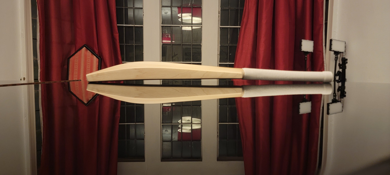

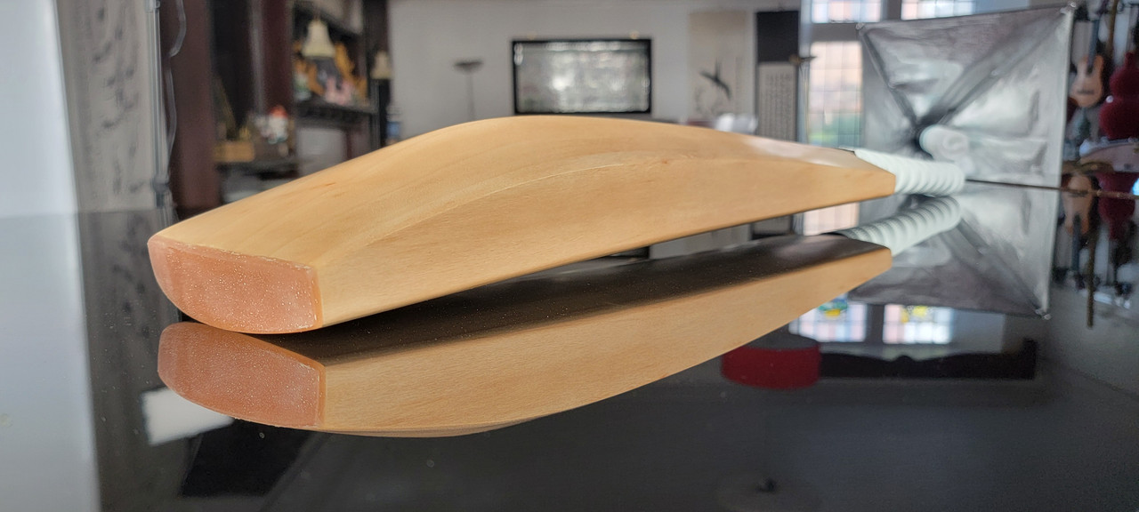

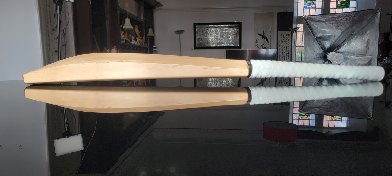

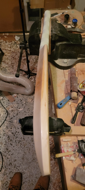

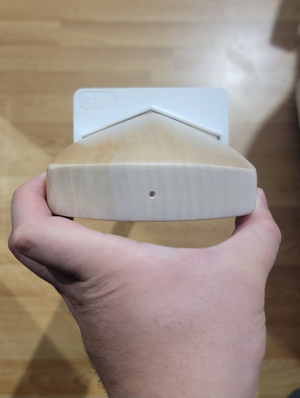

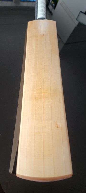

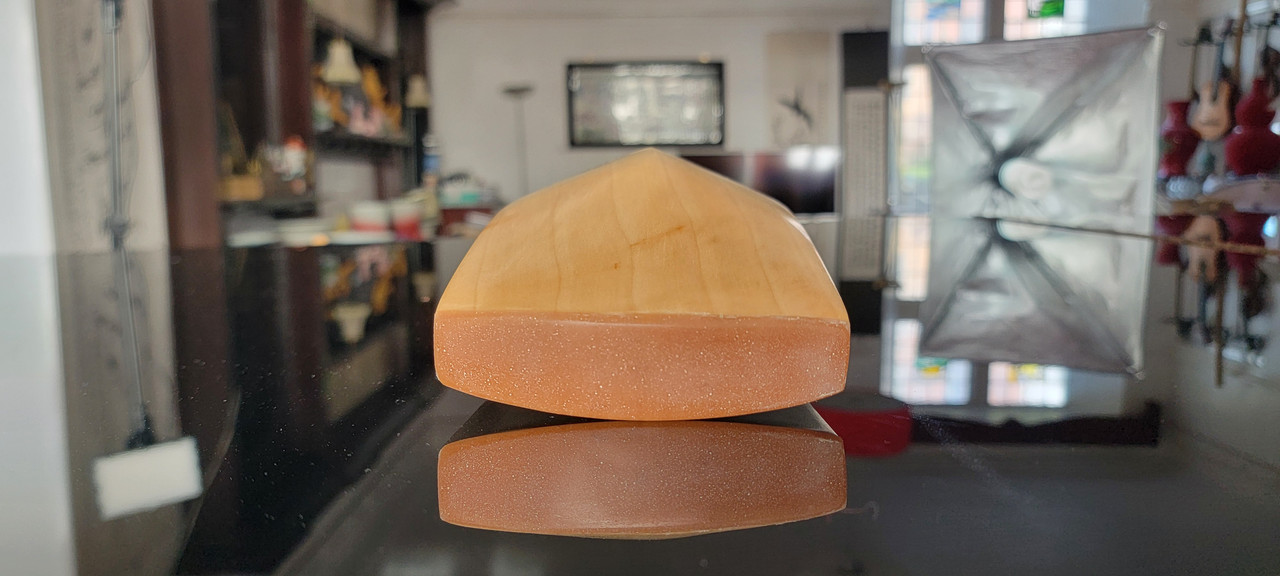

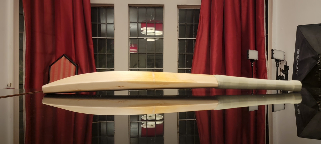

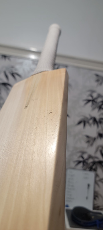

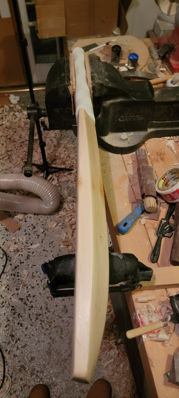

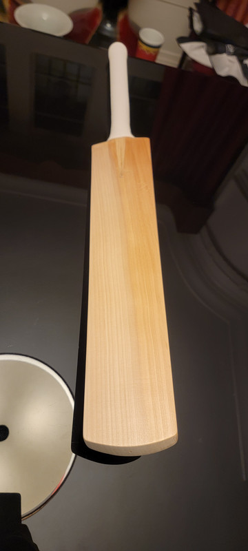

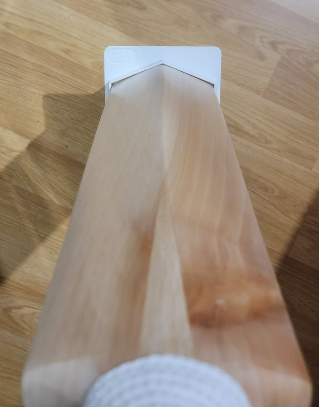

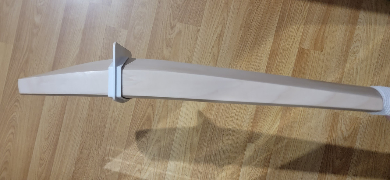

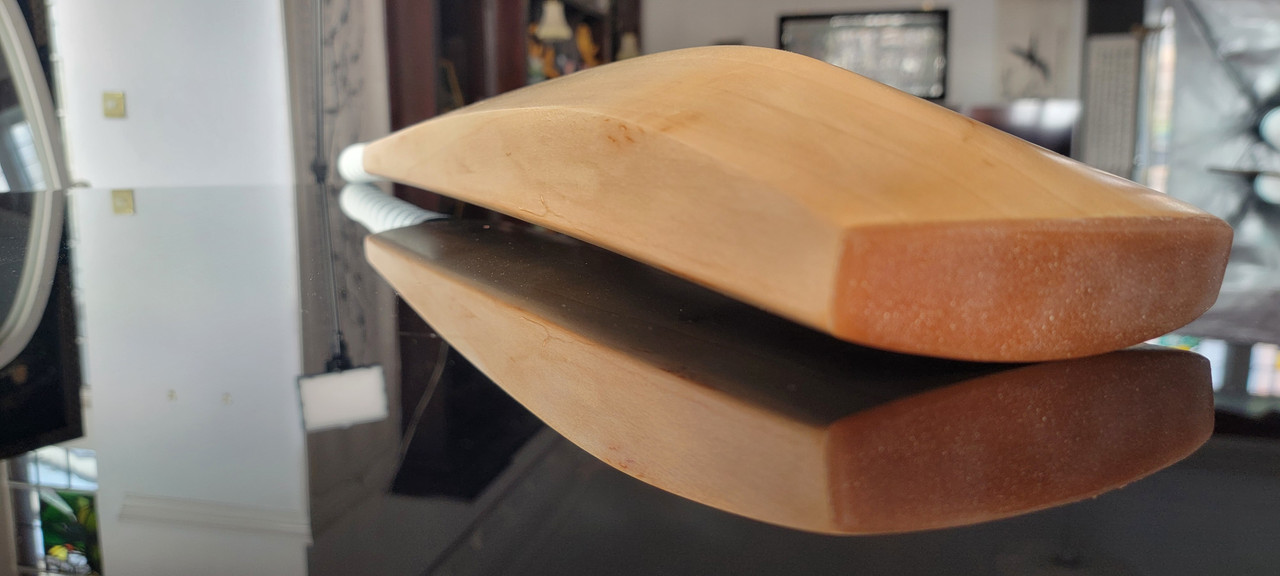

And another one - this particular G2 H4L cleft I had kept aside for a little while, and was probably one of the lightest I've had in. Decided to go with a more modern styled profile with this one, and with the Root shape being one of my favourites, I decided to attempt one.
This particular cleft was a 4mm cambered one, and had a knot up at the shoulder. Being that light, I decided to try make it into a Root inspired shape, using my H4L Root bat made by James Perkins as a reference. (For those who don't know, used to work at GM and deal with Rooty's bats)
Weight - 2lb 10.5oz
Spine - 67mm
Edge Max - 40mm
Width - 108mm
Shoulder edge - 17mm
Splice - 38mm
Toe centre - 30mm
Toe edge - 26mm
Blade length - 1 inch shorter blade
Profiling - Convex
Handle shape - slim oval
As you can see from the images - a large bat for the weight - you can just about squeeze it through the gauge! The knot up at the shoulder was actually a bit of a dead knot - and when I shaped the shoulders down, the knot pretty much crumbled. (Lucky/wise decision to go for a SBLH setup!) All in all, I'm actually very happy with my attempt - it might not be 100% accurate (as are all of my previous attempts to replicate bats), but I'm happy with the specific details I try to match. This particular bat turned out pretty near what I was wanting, and I'm glad I held it back until I was a bit more confident in my knifework/sanding.
Now unfortunately, this particular cleft was uncovered to have a bit of drying damage/brittleness - as seen in one of the pictures above. I am probably just going to try inject some thin super glue just to make sure it all holds down well enough - one of the unfortunate things of working with willow is that there's always a chance of something like this affecting your product.
I'll take some comparison photos I guess when I get the chance to dig out the Root bat I used as a template!

Got to be your best one yet. Fantastic work, really coming along.
Personally think that would be the one I’d pick up from the shop!

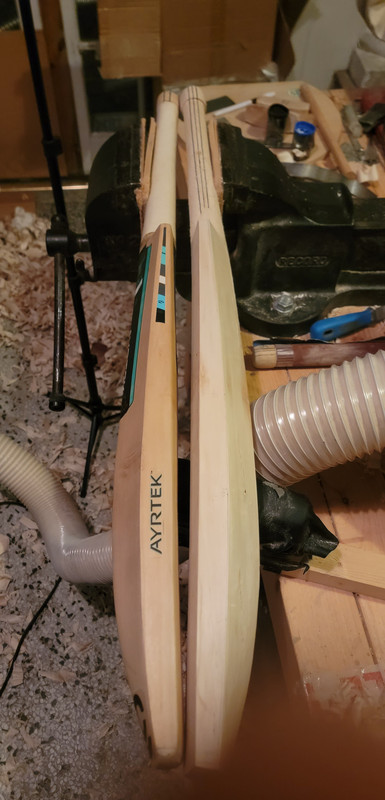

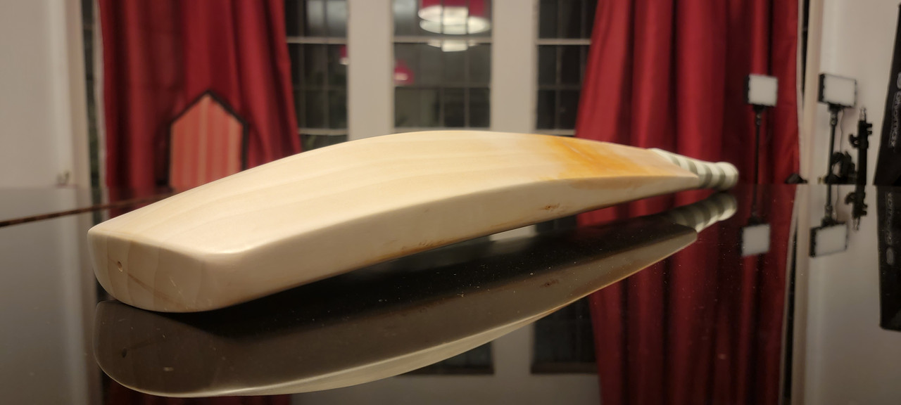

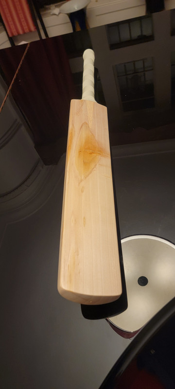

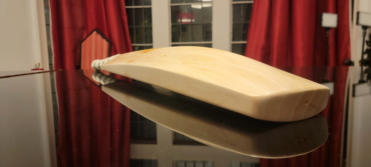

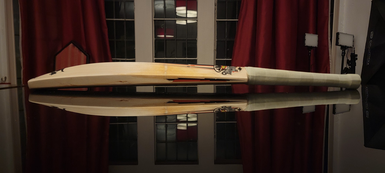

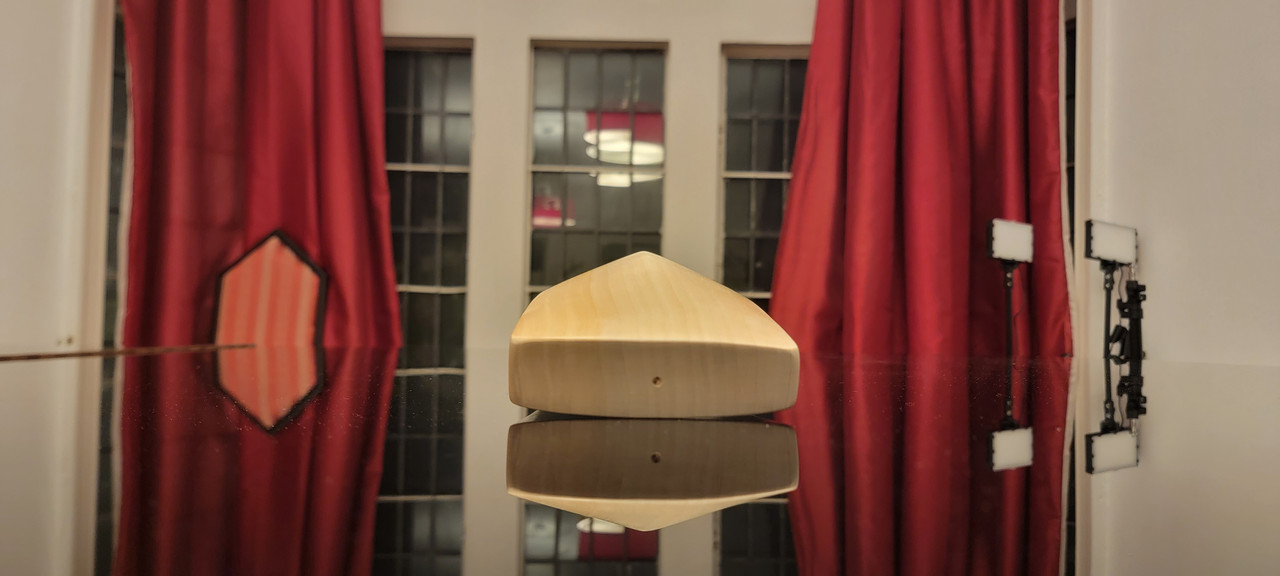

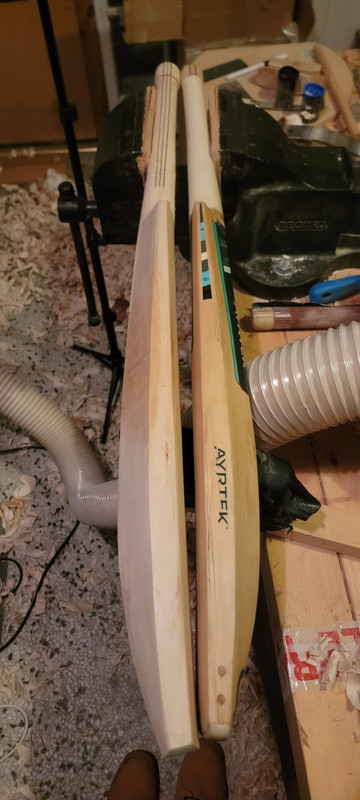

Right, so it's not quite perfect, but eh, it never will be - but here's my first attempt at replicating a JM bat with said bat with me physically.
A deceptively volumous profile - the copy ended up being around 2.14 I believe - the cleft wasn't even too heavy! Big thanks to Matt @hell4leather cricket  for sorting me out with the thick handles and round faces ‐ the attempt would look even further off without it! The bat itself belongs to @Ayrtek Cricket and has had some refurbishments etc, so is a touch shorter than standard SH. The profile itself is beautifully balanced, with the bat genuinely picking up a good chunk lighter than the dead weight suggests, and thats thanks to the wood carried up through the splice and into the handle. I think I left the swell a bit too low compared to the example, and should have probably looked to leave a little more volume higher up - however I think thanks to the position of the butterfly, the bat itself feels very nicely balanced. I was pretty happy overall with this attempt - and plan to make more attempts. Just gotta find a way to fool someone into buying bats I've made haha 😄

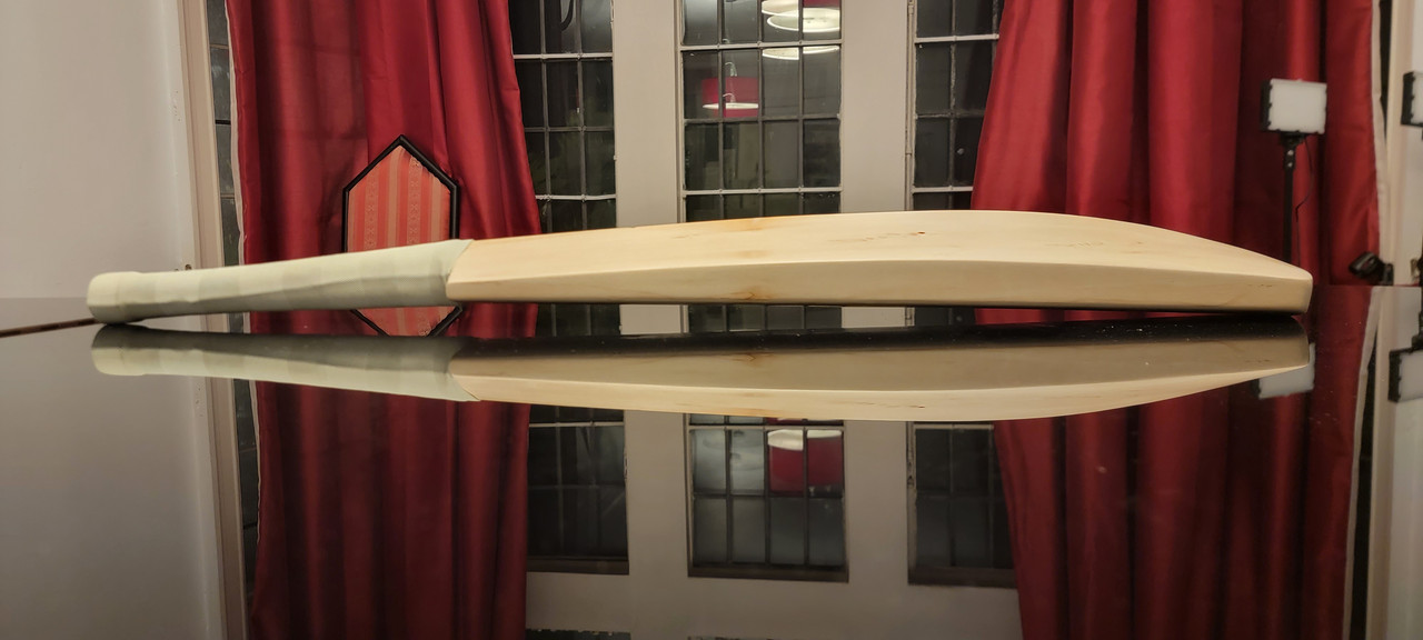

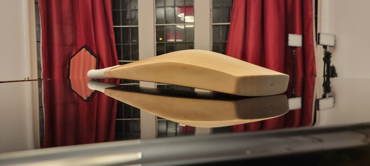

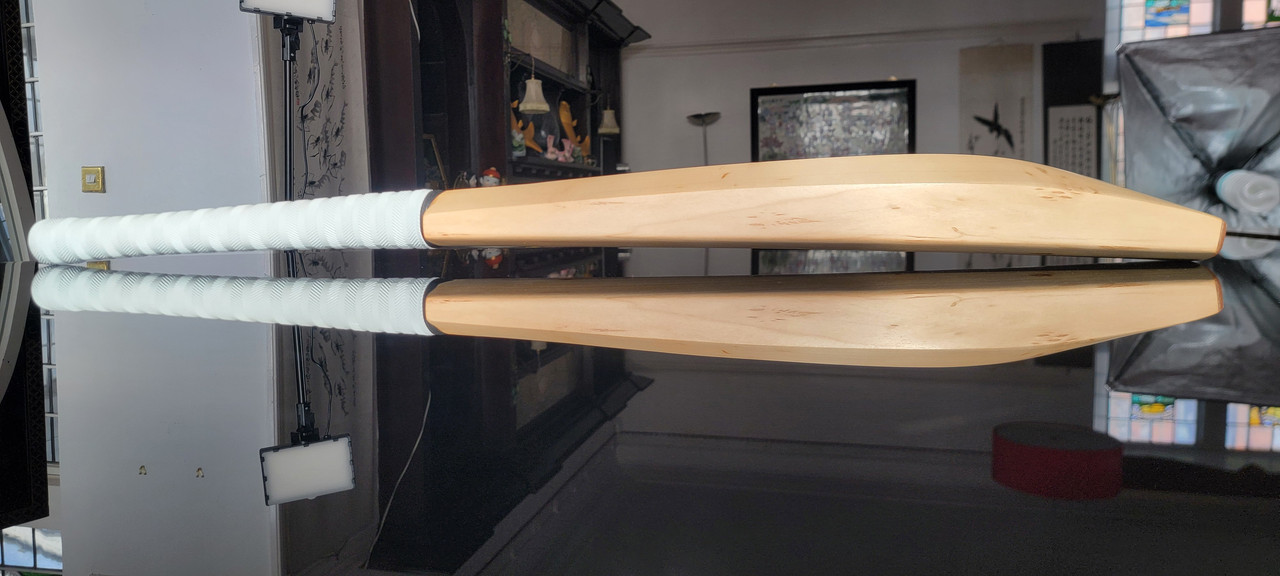

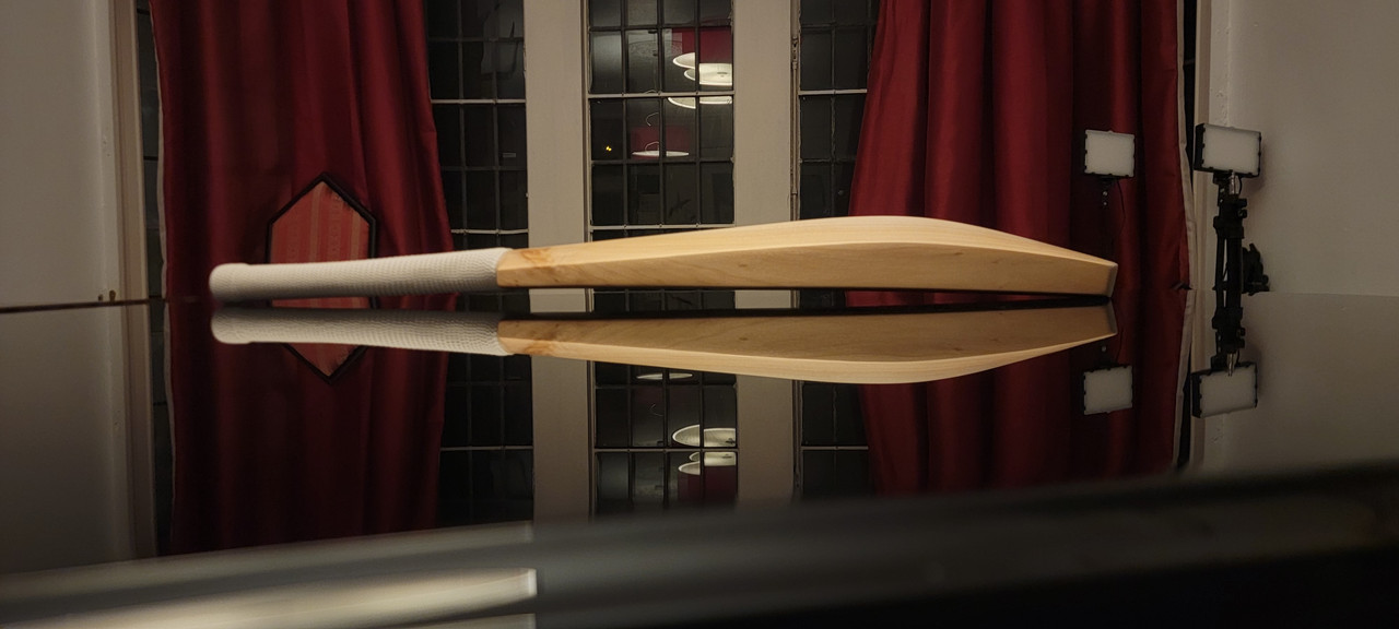

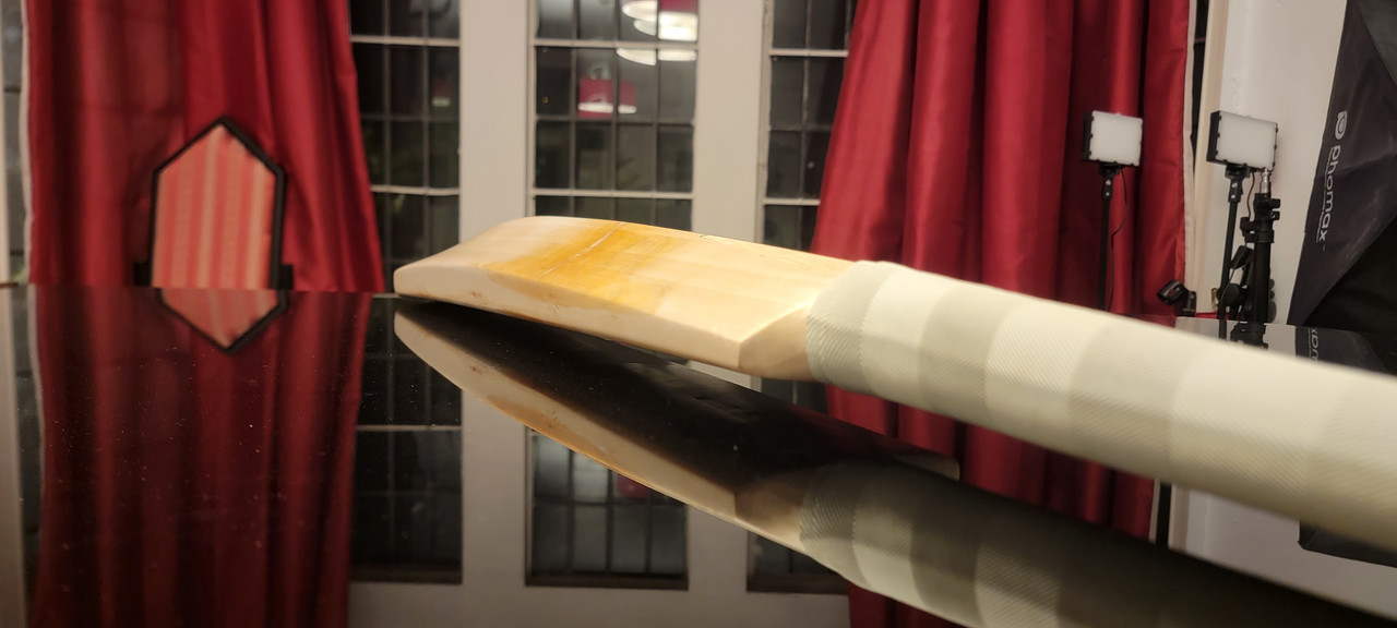

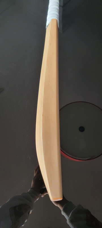

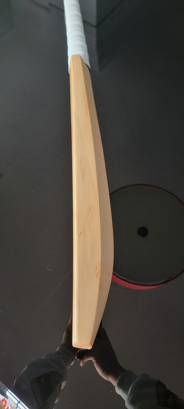

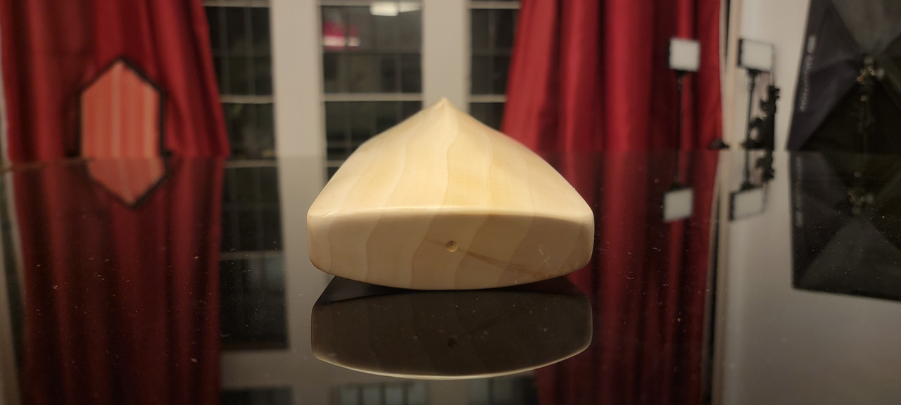

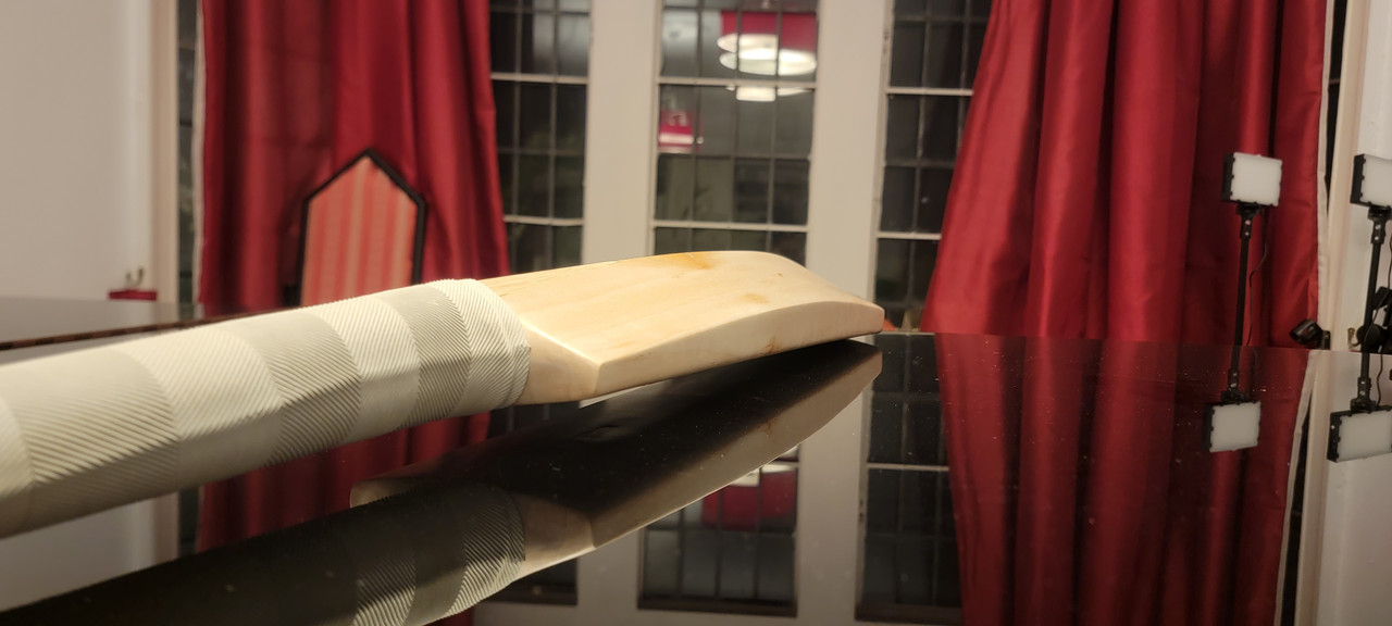

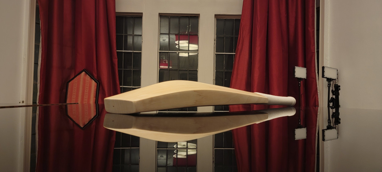

Ooft, been a wee while since I've updated this thread - got one going out which was based off the Joker copy I made a little while back. I'll miss this one, it doesn't pick up light, is an absolute brute, but having made a bat or 3 before for the chap who asked, I did try to spend as much time as I could on this making sure it was right. Given this one a lick of oil, boned and knocked the edges and also fitted with a moulded toe guard. Spine ended up being ever so slightly off centre, but spoke to the chap and he said he would rather I kept it as is to prevent any botched attempt at re-centreing. 😅
Weight - 2lb 15.6oz
Toe Edge - 19mm
Toe Centre - 29.5mm
Edge - 38mm
Spine - 67.5mm
Shoulder - 17mm
Splice - 41mm
Super Short Blade Super Long Handle setup
Camber - 7mm
« Last Edit: March 19, 2024, 11:00:18 AM by Chad »
