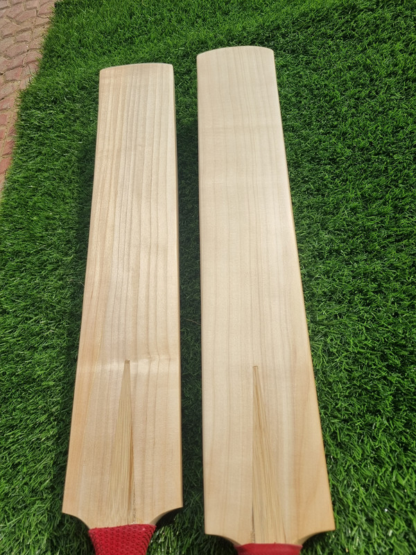

Hey all
I contacted a seller from India for 2 custom order bats. I asked for g1, 2.9, 10 grains, semi oval handle, one bat with mid middle for general strokeplay and one with low middle for slogging and low bouncing wickets.
He has sent me these photos if the willow he has picked out. I thought the grains should be straighter and the spine should be thicker. What do you guys think?

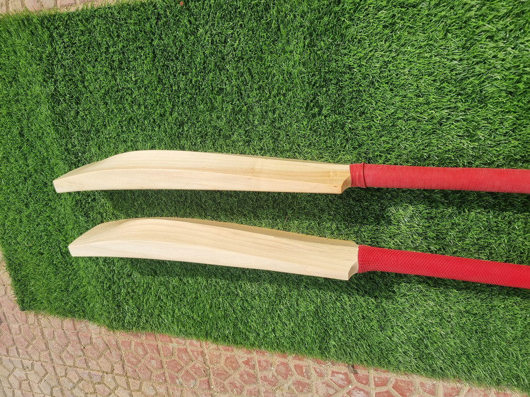

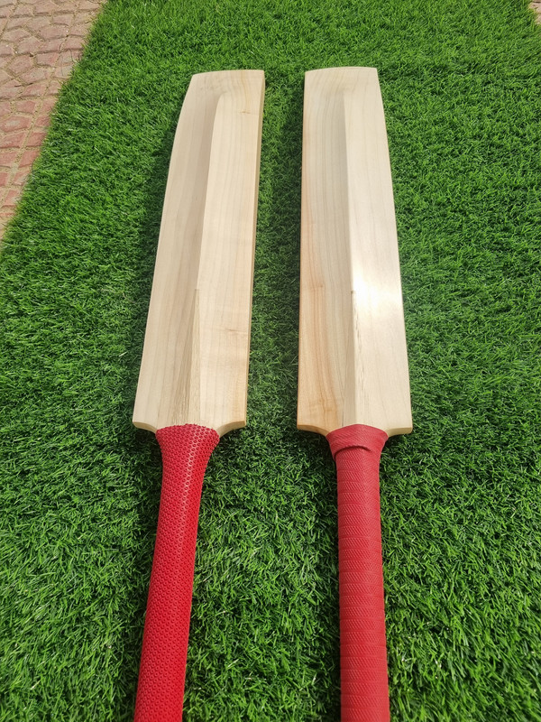

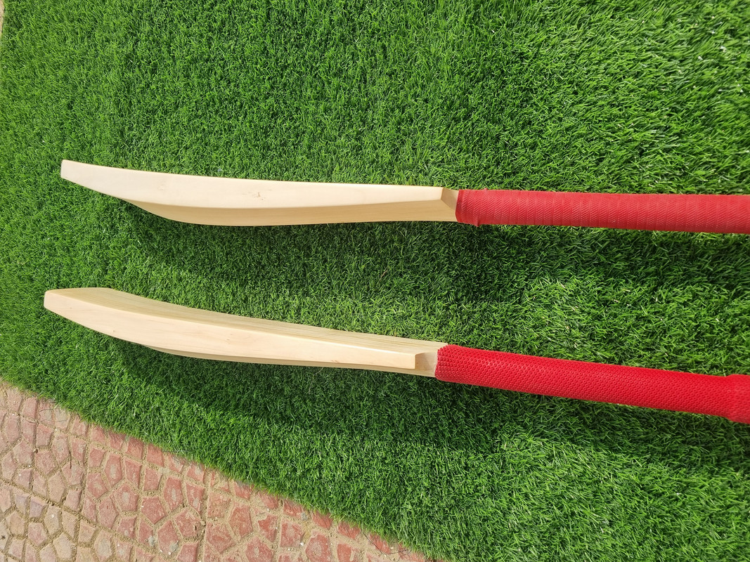

thanks a lot. here are the photos:
I am paying £500 altogether plus £20 shipping. Would like to know your opinions. TIA

My opinion would be that I wouldn't spend £500 on bats from Etsy. You could get them for the same money direct from a respected Indian batmaker, or for not much more from the UK. These don't exactly look custom, as the profiles look the same in the pics.

I am not sure about those bats, they don't look right to me.
Is there a batmaker on here who could confirm if the one on the left has storm damage too?

Hard to tell on pictures, but I can't see anything obvious in terms of storm damage from what I've experienced. It almost looks like it's for a bleached butterfly stain at the top.

The handle on the bat to the right in the picture does not look to be fitted properly hard to tell from the photos but looks like there’s a gap.
Again hard to see exactly but the bat on the right looks to have a mark that’s similar to storm damaged pattern.
Grade 1 can be subjective but if it was a UK purchase I would not say it was.
As I say thou top grade willow can be defined differently depending who you speak to

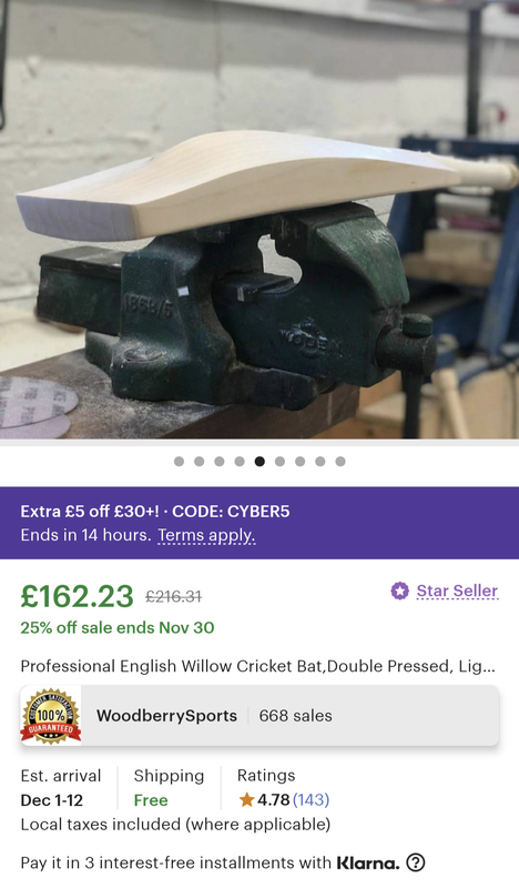

It's a very good price if it's actually G1 English Willow (grown in England and not India or Eastern Europe) and is free from defects etc. I see a lot of 'G1' bats on Instagram etc which have defects, or bark incursion etc with filled in holes which would have been bought as sub grade clefts. I know this goes on and I've heard from willows suppliers that some brands will take a lot of their sub grades and make G1s from them (stickers can hide a lot!)
Now it maybe that they're selling G1s for 200 quid, but why would you if that's my way below market value? G1 Clefts to buy in raw state aren't cheap and you have to buy a good percentage of other grades to get G1s, you can't just buy G1s alone. So, it doesn't make any sense to sell these cheap. So that doesn't add up on to me.
In terms of reviews, these can come from anywhere and be manipulated. Not saying these are, but it's not difficult so I'm always wary of online reviews such as these. They also claim a guaranteed 10-20% extra power, which is almost impossible to quantify and prove. I'd also like to know more about their lifetime guarantee for handles and also where in the MCC laws it bc states 44mm is the max edge size.
However, this is the kicker for me though.....the picture below is taken from a batmakers workshop in the UK, as is the other on showing the bat in the vice. In recognize the press, the background, vice and the sandpaper discs. i can almost say with 100% certainty, this isn't where these are made. Personally, that would be a red flag to me. Appreciate he doesn't state they are, but using someone else's pictures to promote your own work/brand etc isn't great form.
