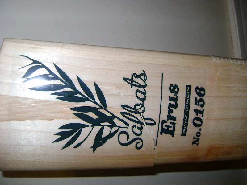

Hi,
 I bought this Academy size Vampire BAS kinghitter off Asad.Weighs around 2.9, with 9 grains.I must admit it is not what I thought it would look like.It doesn't have massive edges like other Asian bats and neither heavily concaved,But I love it.Lovely pick up and nice lowish middle.Found it quite compromising with off the middle shots as well.I bought it only because My SAF erus custom broke after two sessions of nets!.It was a lovely bat too with lowish middle 2.9 weight big edges.It was a principal willow which I haven't seen anybody post a review on.Andy has agreed on replacing it three weeks ago and that was it.Posted below are pictures of both bats.
AJmal.
My Broken SAF ERUS

Re: My Vampire BAS King Hitter and Broken Saf Erus
« Reply #1 on: June 02, 2011, 09:15:40 PM »
Is that not the second SAF we have seen break like that?
« Reply #3 on: June 03, 2011, 09:10:33 AM »
Wow - that's a pretty spectacular break!! Oh well, these things happen, and as long as Andy is prepared to replace it then your ok
« Reply #7 on: June 03, 2011, 09:38:21 AM »
You have to wonder, if two bats go like that, seemingly at the splice cut, whether they are both clefts from the same tree and whether that tree had in fact got a weakness in it.
« Reply #8 on: June 03, 2011, 09:44:55 AM »
It could be mate as the other bat that broke was no 146 and this is one is 156.Everyone at the nets liked it even our Aussie pro.
« Reply #9 on: June 03, 2011, 01:28:01 PM »
Splicing a bat means getting a small surface area to hold tight despite massive pressure on it, the way it works is that the splice is cut smaller than the handle, the force of the handle in the splice creates added strength to the bond. When it is slightly out for whatever reason the result is a big snap, remember that this is a bond between 2 organic and unpredictable pieces of wood so this will happen, I've had mine go the same way before too.
The alternative is to make the gap the same which will allow for no breaks like this but also gives a weaker handle and results in the masses of cracks along the line of bonding and through the shoulder as is common with many Asian bats. Then you see filler being used and the handle join is inferior for life span and performance wise.
You will be looked after by SAF, just focus on the point that everyone liked it, you can't say that very often with bats.
« Reply #11 on: June 03, 2011, 03:07:38 PM »
Hi Mike, yes, I get that, you are forcing the handle into the gap and essentially causing the shoulder wood to displace slightly outwards with two lines of a stress radiating from the base of the splice out to the edges slightly below the base of the splice.
Just wondered that whether, if you had a cleft with a minor fault that caused that stress line to break, if you had more than one cleft from the same tree, at the same level in the willow, there's every possibility that they might go the same way!
« Reply #12 on: June 03, 2011, 05:02:11 PM »
The pictures clearly show it to be a splicing problem, I've seen plenty like this.
Tim, yes you get stress (wind damage) lines in bats caused by the tree moving laterally in high wind which are visible to the naked eye, but the break is running through the bottom of the splice which is the give away. I have a GN here with a near 360 degree crack running round the centre, I would take it back to them but as it is an old model they would never entertain the idea of replacing it despite the fact it was only used 6/8 times and looks like new. It is storm damage and is a cleft fault.
