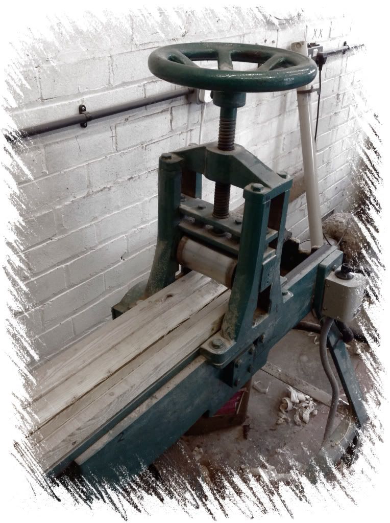

Can we see the Aldred press I asked a question and didn't get a answer
Sorry pro cricket didn't see this I can post some pics of it without a problem may have to take one tomorrow as not sure I have one to hand will have a look

Here's one I have found that I edited for some pics we did
Just a basic screw press single roller

« Reply #87 on: January 13, 2014, 11:03:25 PM »
Lovely very similar to the one in India I was shown.
