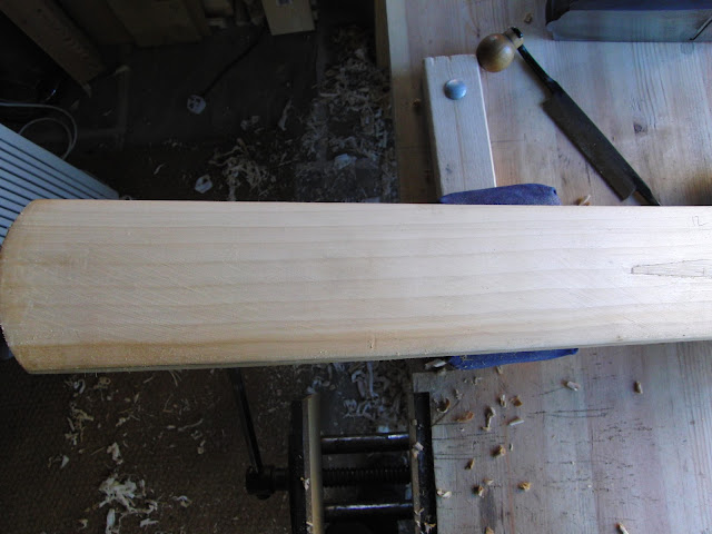

Well, the repair of my own bat has taken a back seat as I've now begun another bat for someone from Australia. After quite a few emails back and forth, we settled on a suitable cleft and today I took the first tentative strokes with the drawknife.
The cleft is beautiful, and I'm quietly confident at this stage it'll make a nice bat. Having said that, there's a long way to go, and as always there will be bumps in the road.
Not a blemish in sight
Now this cleft weighs in a 3lbs 11.4 oz. The request from the customer was for 2.11 in the shape of a Hunts County Edge copy that I'd made a good few months ago.
Now I'm always up for the challenge of making bats from heavy clefts as it's a real test of your skills and a great way to learn how to get more from less. It'd be a lot easier to shape a bat if the cleft started off at around 3 ounces above the desired weight, but life isn't that convenient.
Something important I've learnt today is that my bench moves, It's pretty substantial in weight but it's not perfect and the floor is stone. I made the bench, but as many people know, you need a bench to make a bench. As a result the joints aren't perfect and the top's not flat but adding some cross braces and sand bags should remedy this until I no doubt decide to build a super Roubo/Holtzapffel workbench (Bitten by the hand tool bug, Thanks Christopher Schwarz).
Another thing is that I'm not keen on my drawknife. It's a Arno French pattern model, that takes a good edge and cuts superbly. You'll be saying "What's the problem then?"
The bevel angle, it's too steep for my tastes. A drawknife usually requires some force to get it going, it is after all just a large knife that you're pulling through the wood, but I can't get on with the feel of this one. Perhaps someone else's cup of tea.

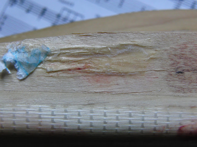

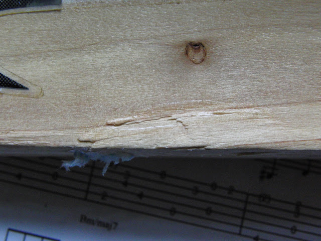

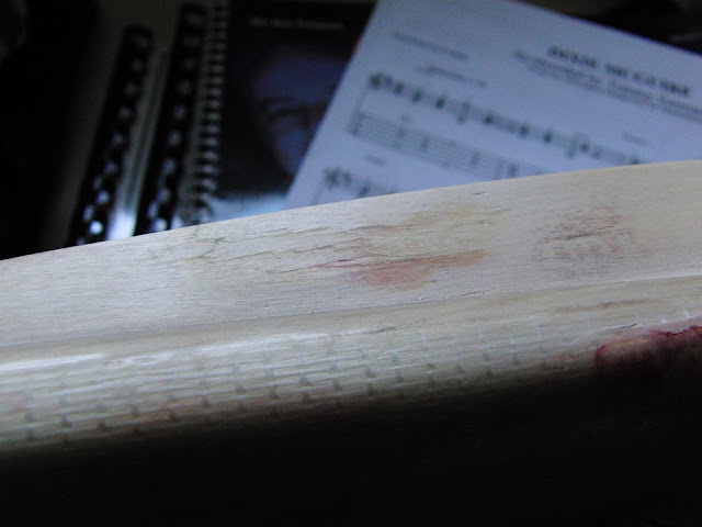

A slightly mis timed flick of the ball had smashed into the back of the edge. Now unfortunately, Willow is  a naturally soft timber and the only reason it stands up to the punishment of a cricket ball is because it's pressed using one of these...
They look a little bit more modern nowadays, but essentially they serve the same purpose
This machine compresses the fibres of the face and edges but doesn't make much difference to where this ball hit.
Please bare in mind that I forgot to take a photograph before I repaired it. All the wood that's glued down in the first two photos was blown out the back. The fibres had been crushed together quite badly and it became apparent the repair was essentially going to be cosmetic. I picked out as much wood as I could to allow the glue to have something to stick to, in the end it looks considerably better than when it came to me.
The splits show where the wood was poking out the back
Glue and sandpaper are your best friends
GONE!
