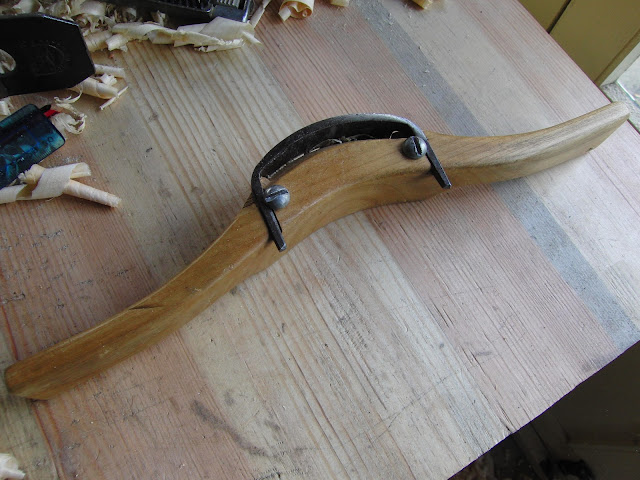

The tale of a travisher and my cricket bats
For anyone who hasn't come across a travisher, it's a woodworking tool that has seen extensive use in chair making. In recent years, the travisher and cricket bat makers have crossed paths and it now seems that they adorn every pod shavers workshop.
This is my Travisher. There are many like it, but this one is mine.
This tool has the potential to remove a great deal of wood very quickly and used in the right circumstances it can be very helpful.
Unfortunately I don't share the enthusiasm for this tool. The one I own has the most bizarre mouth design. The blade is bevel up, but you have to lean the tool so far forward to get the front and mouth to make contact with the surface that instead of the blade being presented at roughly 30º it ends up being closer to 55º or 60º. You then a scraping action rather than a slice. Even with a razor sharp blade it takes some force to use. More Force = Less control.
If it was bevel down it might be better suited to this mouth design but it seems my only option is to make a new mouth or leave it in the tool box.
I'd recommend a round bottom plane instead, far easier to use.

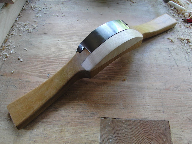

The tale of a Travisher 2: This time it's personal
The courier arrived mid morning and picked up the bat destined for Australia. I was happy to see the package leave as it'd been sitting in the hallway bugging me, but quite sad at the same time to see it go. It seems every bat I make ends up being the "best one I've made so far", whether it is or not is up for debate but in my eyes it becomes the new favourite.
With my views on the travisher committed in writing, I thought this morning to myself "Why don't I make a new front mouth for it?"
I've been in the process of making a bat width gauge for someone, for weeks. They wanted something similar to one I made a month or so ago...
I've had 3 attempts at making another and 3 failures. I therefore have some scrap bits of maple needing to be used. So I set about rejuvenating a tool destined for the "big toolbox in the sky".

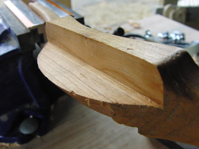

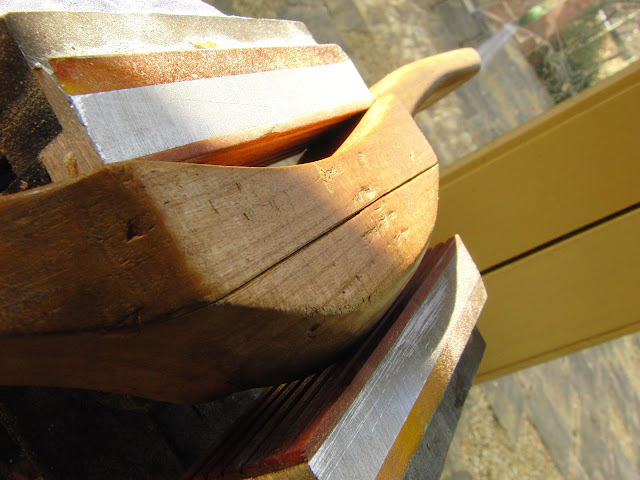

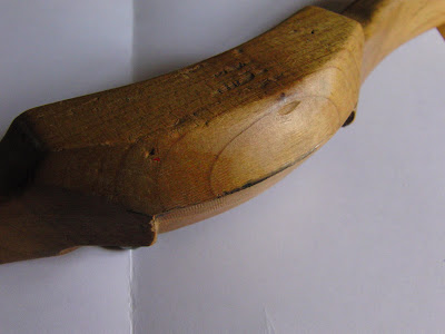

In my last post I mentioned that the bevel up blade presentation and the angle that you have to present the tool makes for an awkward cutting action.

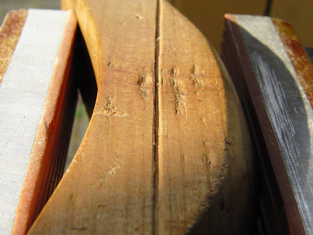

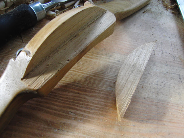

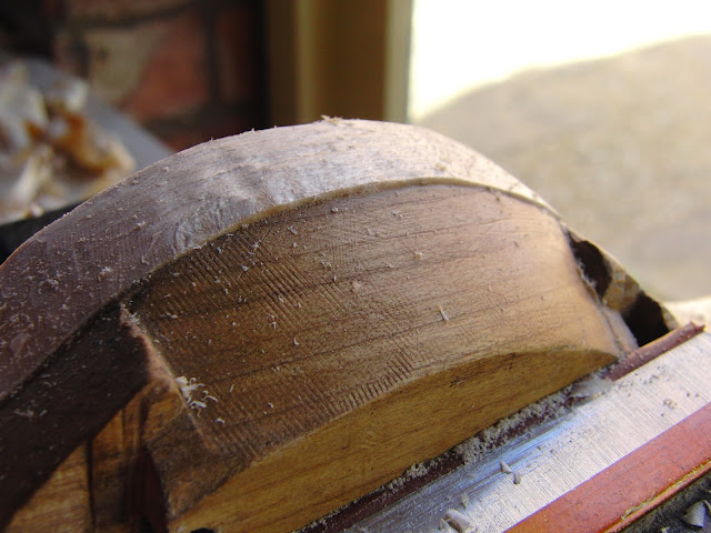

Firstly I had to mark out what I was going to remove. In hindsight, chopping off the whole front would have been easier to do than cutting out a strip but you live and learn.

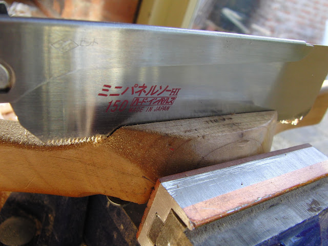

I make a pencil line and then use a chisel to chop into that line all the way across.
Paring out a small bit of wood lets your saw fall into place and makes it easier to make an accurate cut
Not turning back...
Needs some cleaning up with a chisel.
Slowly looking better.

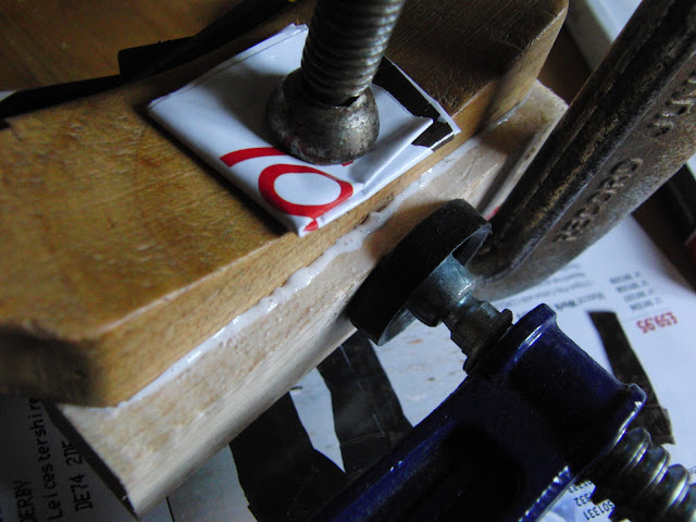

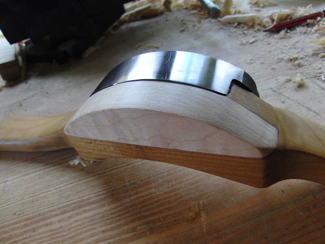

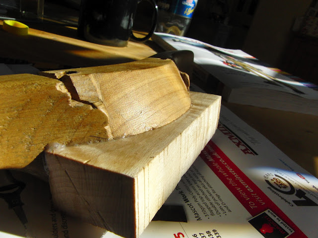

Getting the joint right was quite difficult, which is why I probably should have chopped the whole front off. Eventually I get there and it was a nice little project for the afternoon. I'm currently trying to find some suitable wood for a mallet so I thought I have a go at this in the meantime. I almost got stuck into a wooden plane I'd made as I'll be converting that into a round bottom plane.
All glued up, we'll see how it looks in the morning.
Beachcricket
  • Posts: 855
Re: Beach's Bat Making
« Reply #111 on: March 21, 2012, 10:42:53 AM »

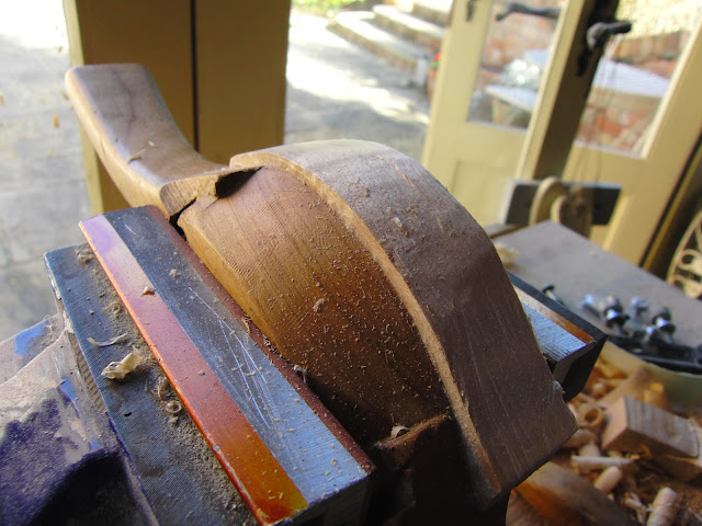

Back in favour?

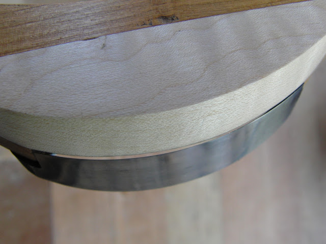

Got up this morning and checked how well the gluing had gone.

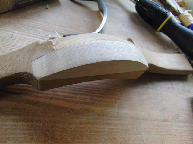

After taking off the clamps it looked okay, the glue had dried and all that was left was to shape it down.
This part took a while, perhaps 3 or 4 hours. Whilst this was an experiment since I had nothing to lose, I didn't want to ruin it with a stray chisel stroke. I removed most of the bulk with a saw just save time.
I bought some amazing Narex Chisels last year from Workshop Heaven. If you're considering your first set of chisels or looking to upgrade you can't go far wrong. They are superb quality and cheap, it seems too good to be true but it's not. They sharpen beautifully, slice through the hardest of woods with ease and are a pleasure to use. Matt at Workshop Heaven is incredibly helpful and the service they provide is superb.
Getting there slowly

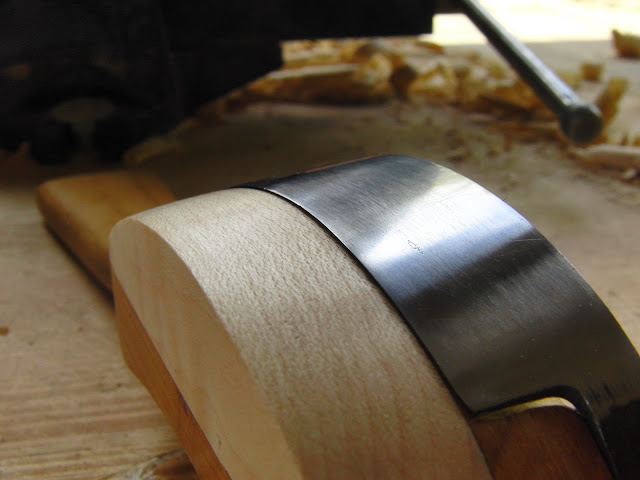

Just after I took the above photo I put the blade in for a quick test fit and realised I needed to take off a lot more wood to present the blade. The good thing was I'd left enough on to give me chance to fine tune the front. Which after a bit of chisel work and sandpaper looked like this...
I quickly refinished it and put the blade in.
The front edge is screaming out for a bevel or curve.

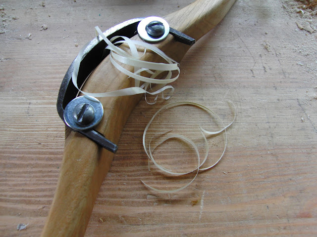

A few simple shavings illustrate the difference it's made.
It's like a different tool. My travisher actually takes shavings rather than scrapings. The true test will be when I'm making a cricket bat but right now I pleased as Punch.
