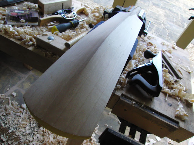

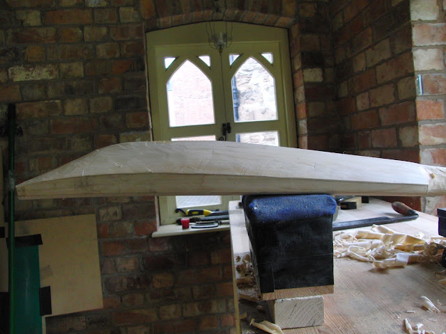

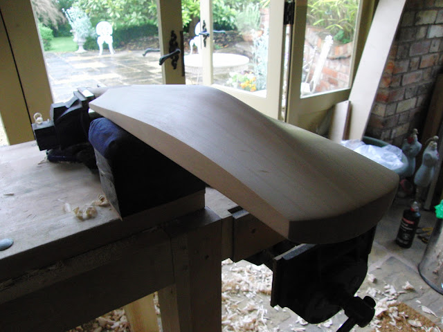

Back to the cricket bat though. It was another request for a bat in the style of the Hunts County Edge, it's a popular shape it would seem. The cleft weighed 3lbs 10.1oz and I was looking to get it down to 2lbs 10oz to give myself a good chance of meeting the ceiling weight of 2.12. So with all that willow to be removed it was time to unleash the new drawknife on the cleft. The difference is significant but it has both positives and negatives at this point. Yes the cut is cleaner and it's faster at removing wood but it's difficult to control. We've gone back to the start almost in terms of technique, it's a new learning curve and a couple of times the cut was getting away from me...

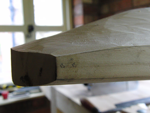

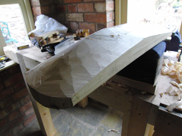

We went just a little bit too deep, I quickly measured the edge to check what was left.
As you can see from the marks, we have a constant battle between Man and Drawknife.

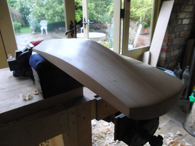

It wasn't long before the hand plane got in on the action to clean things up.

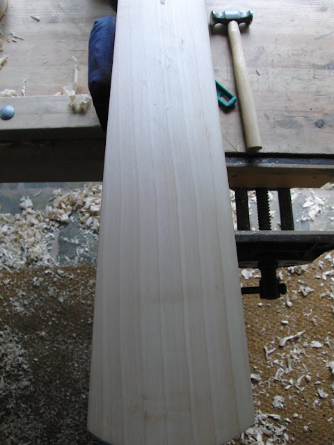

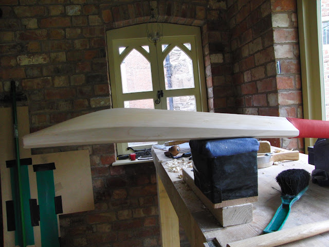

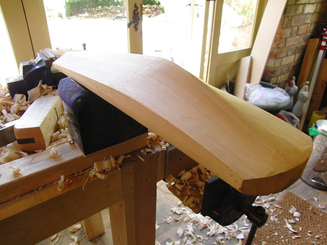

I left the rough sawn timber again, I like to use it as a guide for shaping.
Starting to look almost like a cricket bat.

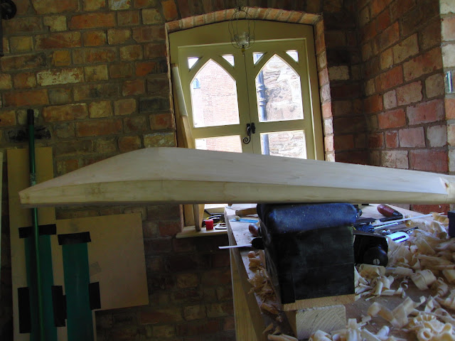

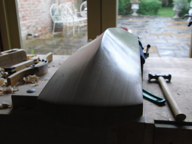

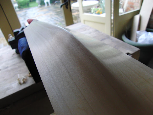

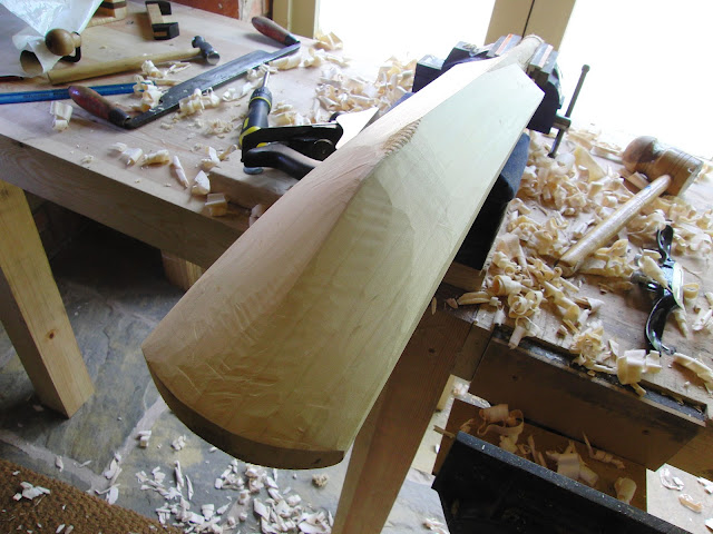

At this point, I think it's worth noting the difference in shape between the above photo and the one below.

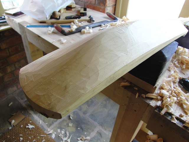

I've mentioned a couple of times that each willow cleft is unique and making copies is always tough because you have to accommodate the qualities of the willow and not compromise the cleft by forcing it into a shape. I could get the ruler out and make as close a copy as is humanly possible but that wouldn't benefit the bat and therefore the customer. The dramatic difference in shape you see in the two pictures above not only represents the need to remove weight but more importantly the change in shape I've had to make to accommodate the willow cleft.

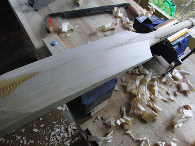

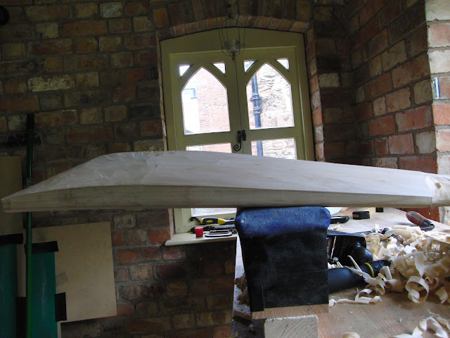

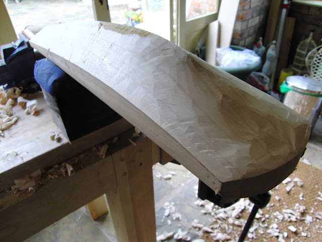

Rough sawn willow still there and some round bottom plane action had begun.

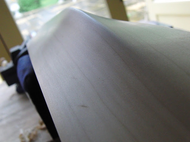

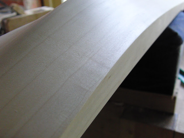

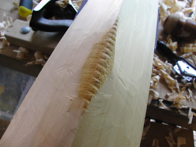

You can see the chatter marks my spokeshave is leaving, needs a sharpen and some tool TLC.
These marks are fantastic, they catch the light at different angles and give the wood character.

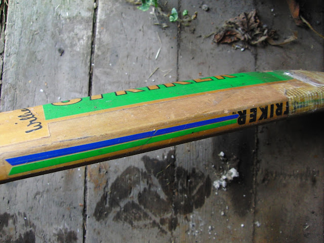

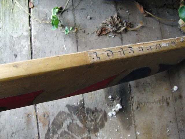

Concaving is a tool I use to balance a bat, to allow me to leave the most mass in the swell. Simple as that. If you're focused on finding the biggest bat rather than the best bat then you may as well be comparing your manhood in the shower.
12 or 15mm edges on a 2lbs 5oz Gray Nicolls Powerspot.
Look at those MONSTER Edges, I need to sit down.
I'll leave you with this...
Ask yourself if some of the wood in those 40mm edges could be put to use more efficiently elsewhere?
