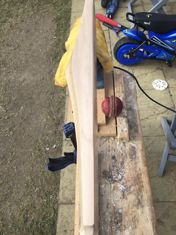

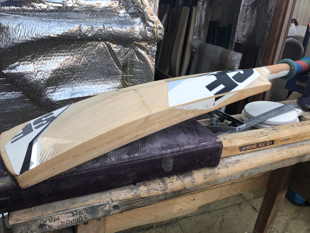

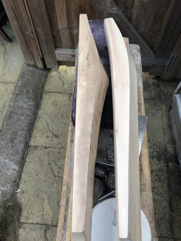

Big cleft I had sitting around,,,made a change to fit my own handle etc
Always liked the pre rule change Aussie gn,s, so that’s the first of a few I’ll make during this lockdown

Interesting, to say the least. I'd like to know how's is it's response higher on the blade?

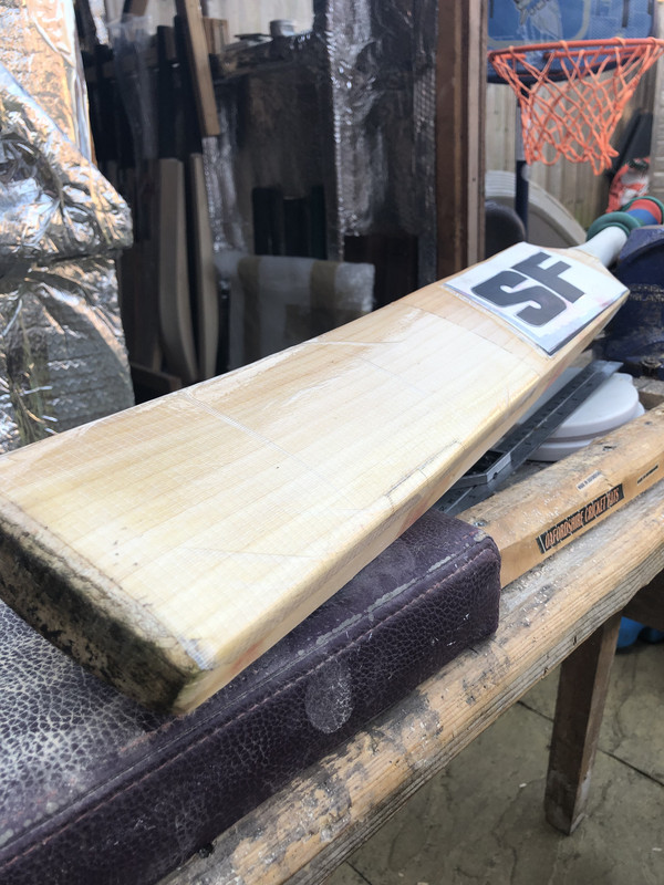

Any more information or pics in the Denly bat?

Touch of the GN Nemesis shape going on there, looks a belter.

Upper part of bat dimensions are same as this 2.10 bat,, shoulder edges are slightly bigger
The response up there is pretty much the same as as any other bat,,, must admit I don’t usually hit a ball up there that often on our wickets
And this bat has 50mm edges and a 73mm spine, which kinda alters proportions

That Denly bat looks a big chunk of willow from toe to shoulder, what are the specs on that?

Denly's looks a beast, I've got a couple of H4L's similar size and shape but they'll be heavier that that!!
