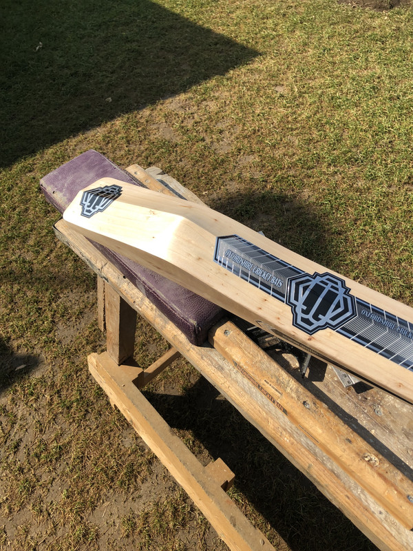

That Denly bat looks a big chunk of willow from toe to shoulder, what are the specs on that?
Re: Northern monkey batmaking
« Reply #661 on: April 09, 2020, 08:12:54 AM »
Very very little concaving
Rounded face on it
Square toe
Picks up its weight
But the ping, like I’ve said before is very very good
It does look well used tho,

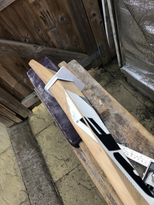

« Reply #662 on: April 09, 2020, 08:15:16 AM »
That probably shows it better

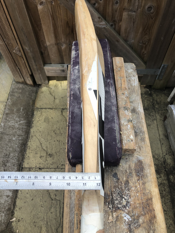

« Reply #663 on: April 09, 2020, 08:15:47 AM »
Not as big as it looks from the toe up really

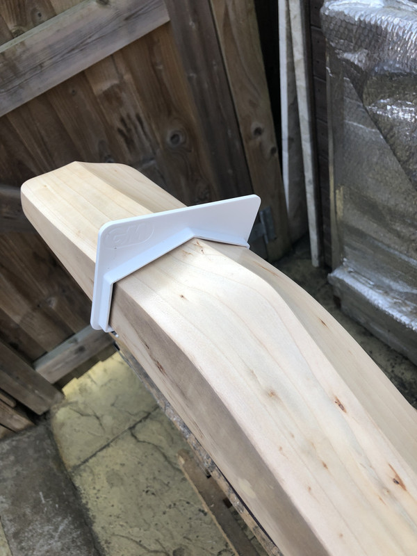

And one picture for a little context
Both bats similar weight
No mate, and the width is down a bit too

Interesting bat mate. Top effort!
This shows how difficult it is to know by looking at pictures what weight, size a bat is and how sizes to me are almost irrelevant. If a bat pings, it pings. Whether its maxing out a gauge or not won't really make any difference to me.

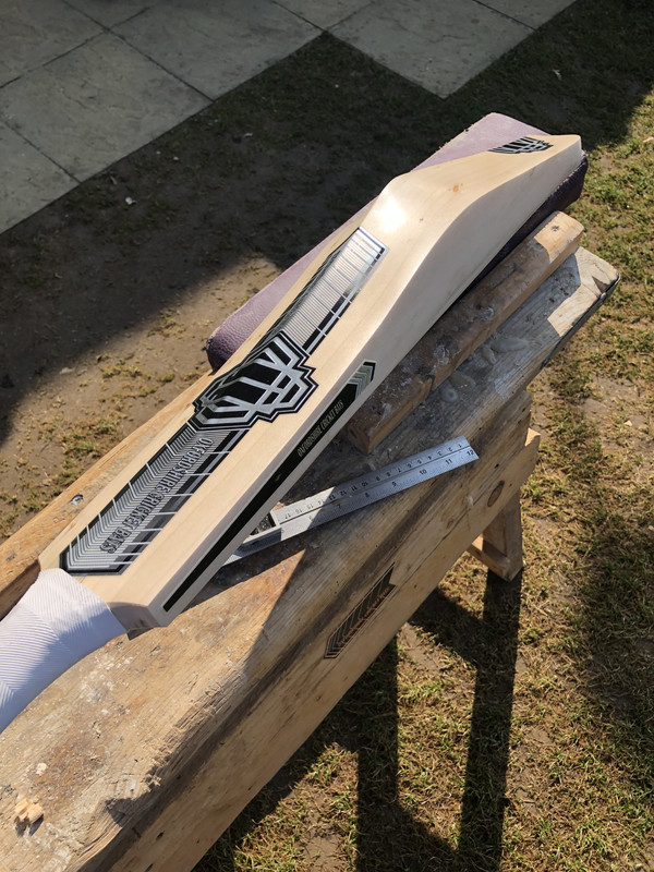

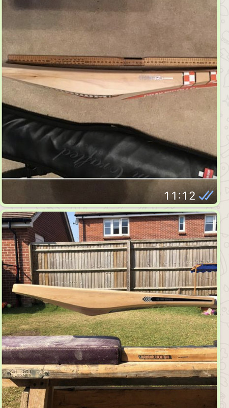

Wow!!  Quite a departure from your usual shapes, but looks great.
Those XP80's were a radical shape, and your spine height isn't far from matching it.
Is that done to customer's specs, or just because you had a cleft that would allow it?
« Reply #670 on: April 09, 2020, 10:20:46 AM »
Cheers
Nah it was just cos I love those shapes,,, I have a few oversized clefts, and now I have some free time it makes sense to chuck some handles in em an max out the specs

Man that is massive
« Reply #673 on: April 09, 2020, 10:56:01 AM »
If you look at the edge stickers,(they look tiny) it gives an idea of size
« Reply #674 on: April 09, 2020, 11:32:08 AM »
I love the look of that one. Whoever ends up with it will surely get some comments as they walk out to the middle.
Random question - how do you find those long stickers on the back with a more extreme shape? I’ve got stickers of similar length, but I’m having an issue getting them to stick properly. Can’t work out if it’s due to the fact that I’ve not kept things straight/equal,  stickers aren’t ‘proper’ bat stickers or if it’s all down to the geometry!
