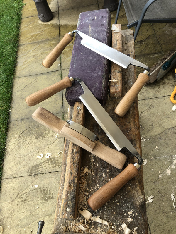

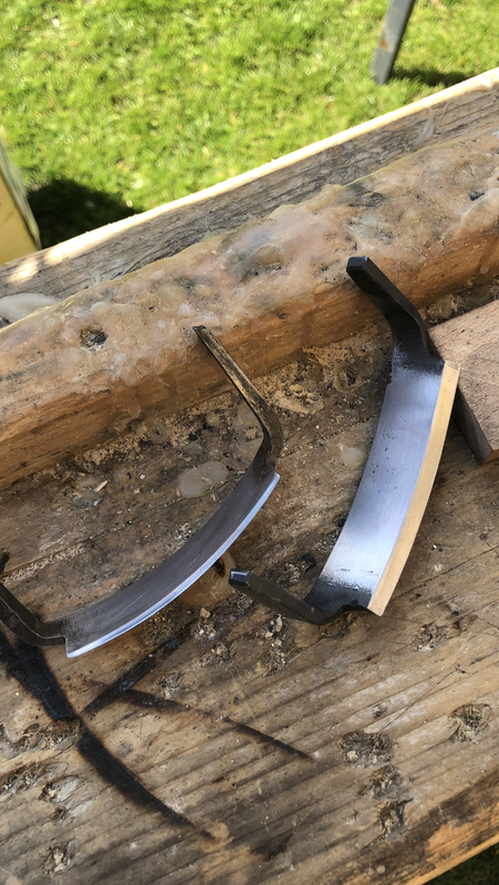

Managed to forge a travisher blade and another drawknife

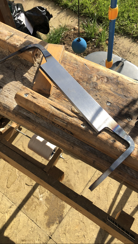

« Reply #797 on: August 14, 2020, 12:56:54 PM »

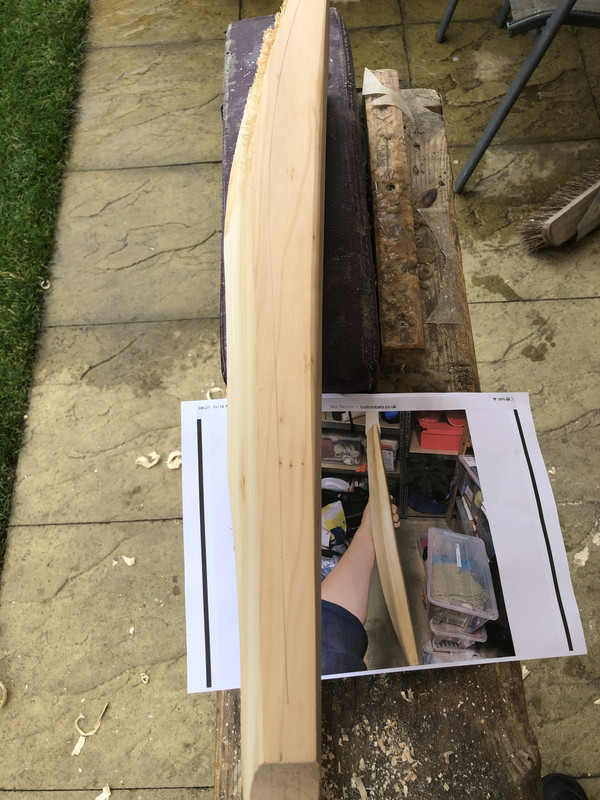

Just got this to finish off before I start on a scat copy,, (unfortunately back to the day job this week,)

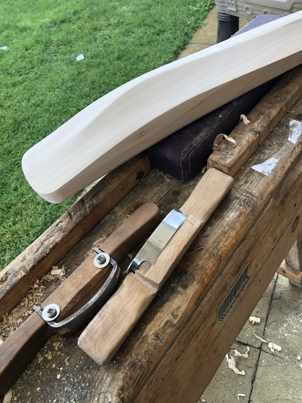

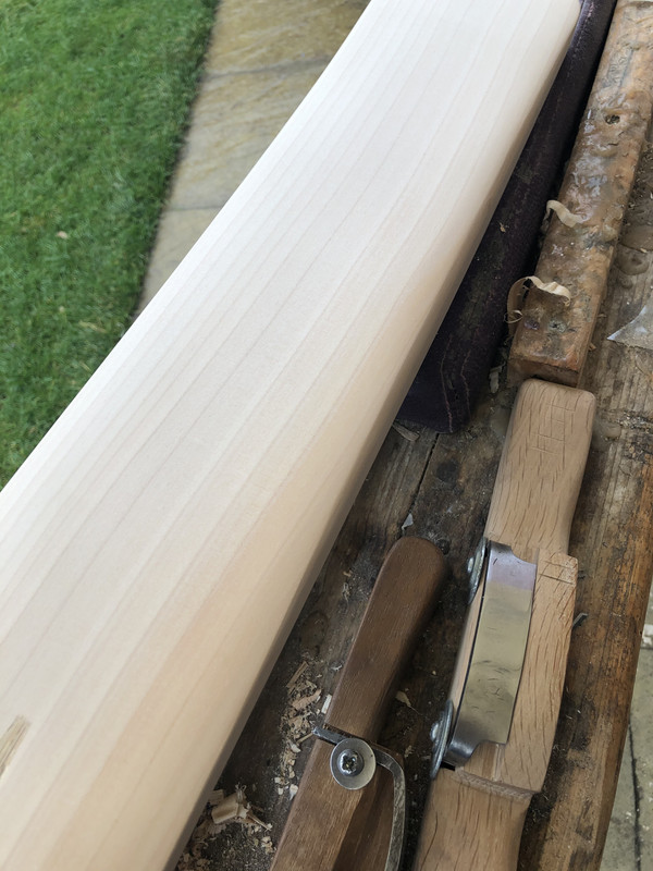

And nice to be using my newly forged travisher

I’ll be making a few more of the travishers, as I get time
And possibly a small run of drawknives

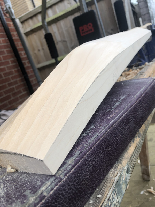

Cleft chosen, edges and spine drawn on
