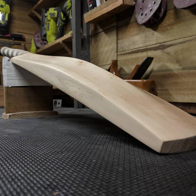

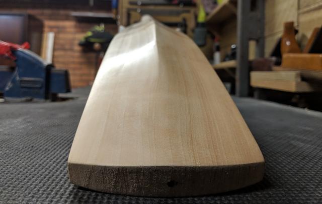

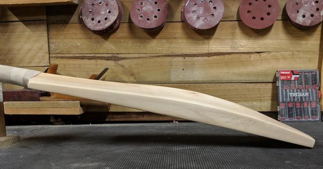

Thanks all!, really appreciate the kind words and support.
I seriously can't get enough of this process. My fingers and hands are blistered and I've got willow dust my eyes ears and nose, but it's all worth it for the sense of satisfaction and pride when a bat is finished.
If anybody has Instagram and is vaguely interested in another cricket tragic's bat making and repairing antics, please feel free to follow me @ omega_cricket_australia
anywho!, Here is #3
I wanted to play around with a bit of a higher middle and more pronounced spine. I wanted to also experiment with offsetting the middle and the edge.
This came out at 2.9 and picks up really nicely.

What does offset middle/edge do?

Changes the pickup I guess? Remember SAF used to do that a lot.

The theory behind it from what I gather is that it extends the sweet spot without sacrificing the pick up. Whether it works or not is up for debate.
I chose to go higher middle will a lower edge peak purely because the person who this bat is made for plays on synthetic pitches, wanted big edges and not too much concaving, but didn't want anything too heavy so I wanted to distribute the weight as evenly as I could in the mid to high region.
