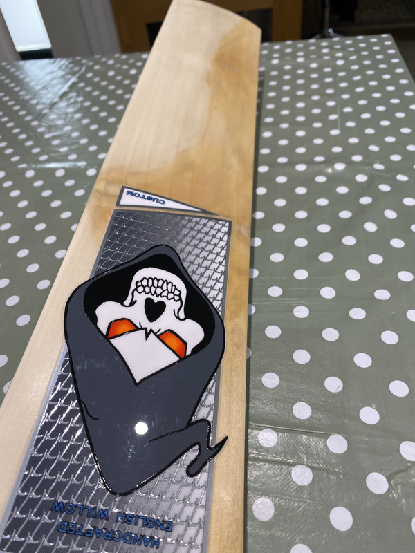

« Reply #138 on: March 24, 2021, 08:07:52 PM »
Debut of one of our new sticker designs for this year on the butterfly.
« Last Edit: March 24, 2021, 08:20:01 PM by LEACHY48 »

« Reply #139 on: March 25, 2021, 09:21:02 AM »
Looks really lovely mate! Good face and enjoying the sticker too.
