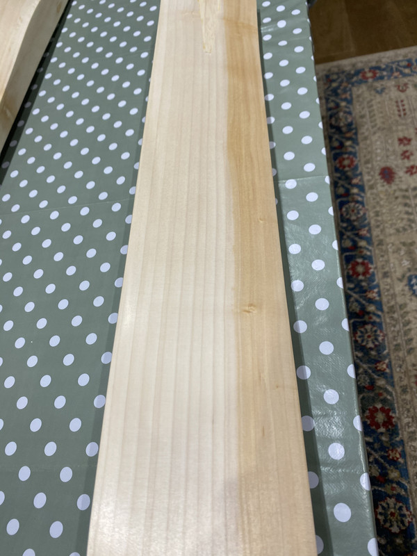

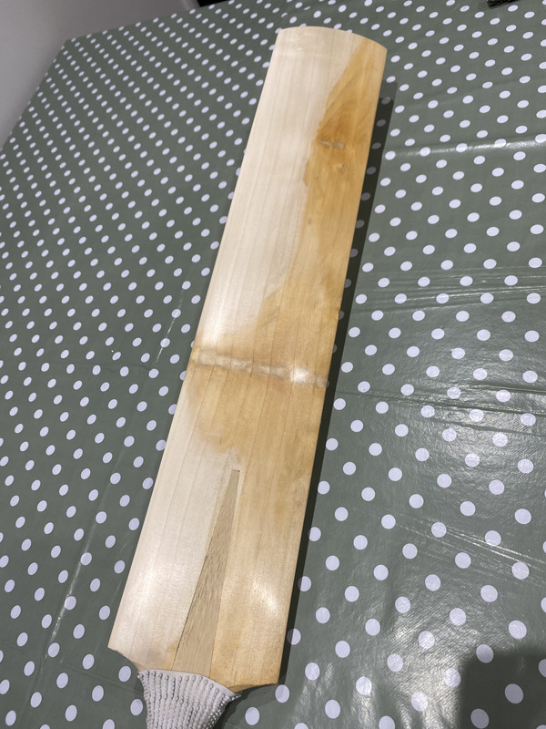

Sensible question alert - personally I would have liked the handle to be at the other end so the butterfly stain is in the middle. Did you consciously choose to have the stain away from the middle and if so do you think it makes a difference?
Thanks
« Reply #121 on: March 22, 2021, 07:54:44 PM »
Thanks
I have had a couple of people ask this. - the short answer is this was a part made, but some reasoning in my mind:
For me, I prefer the big stain out of the playing area, this particular cleft has a small stain lower down which adds playability, so I think you get the best of both worlds with it as it is, a cleaner face while still having the hardness of a stain in the swell to add performance.
Also, the grains run fairly nice and straight through the toe, but tail off a little towards the shoulders. So I would have done the same thing had I had the choice.

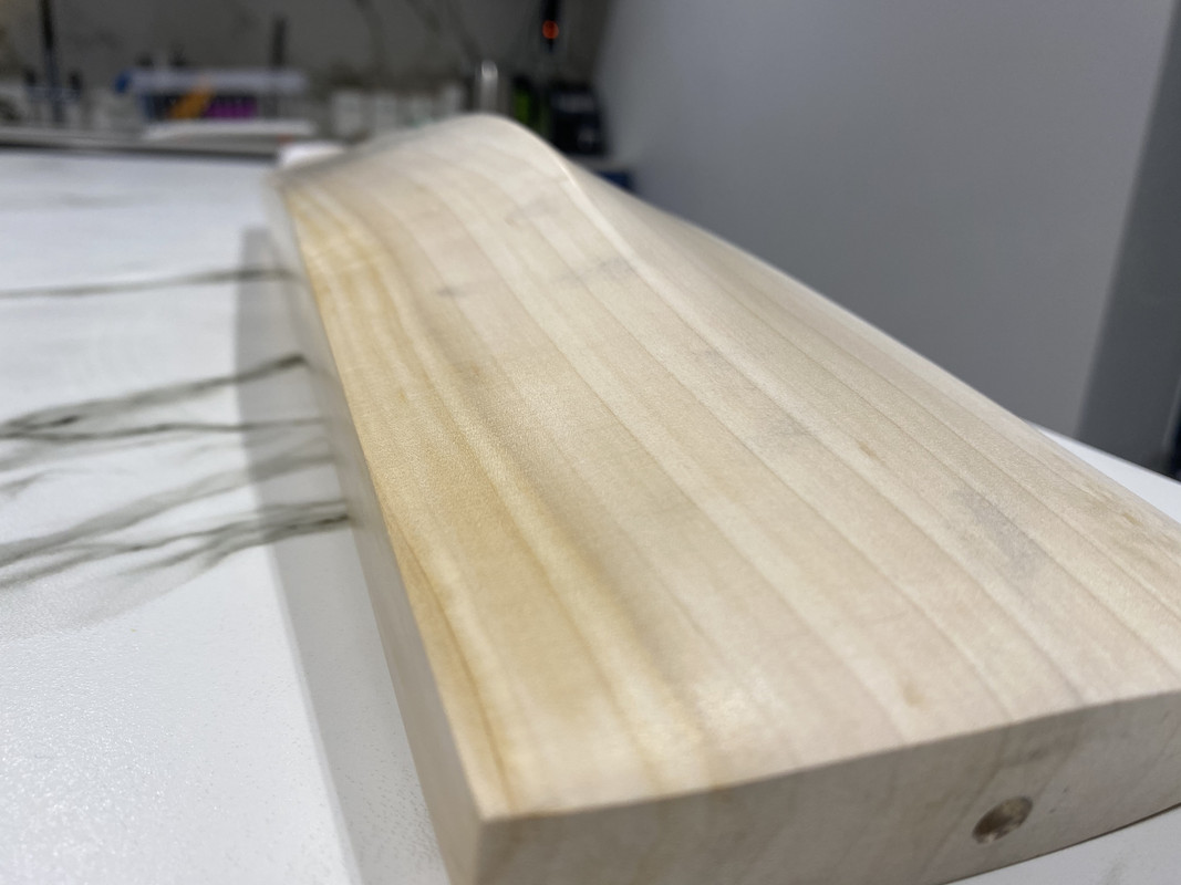

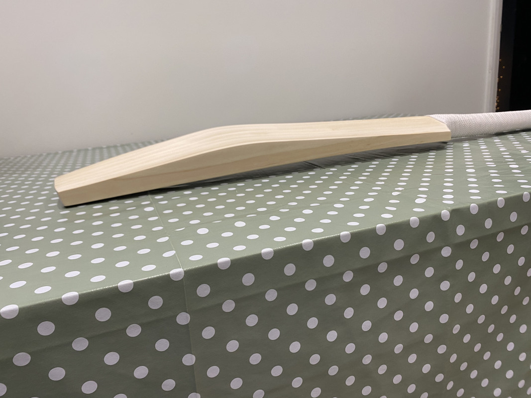

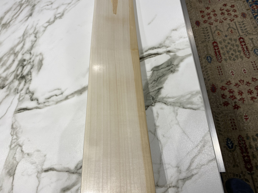

Three finished up today.
One is the butterfly that is still for sale - it is 2.9.2 in its current state and just needs stickers and a sheet, so will be easily under 2.10
Huge bat for the weight and totally full.
Then the keeley superior shaped bat for the owner of a brand I’ve done some work for: This was 2.7.1 before a grip.

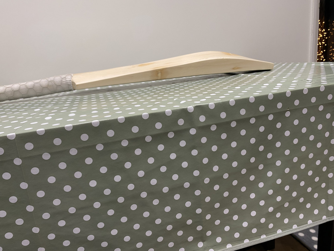

Then finally a G1 that is a copy of an Old BDM that the customer loved. This was 2.8.2 before a grip
These have all turned out really nice in my opinion and are all big bats for the weight!

Quality and finishing looks superb. The BDM copy is  :o
« Reply #132 on: March 23, 2021, 11:23:29 PM »
@LEACHY48 that BDM copy is a thing of beauty, stunning shape mate top work again.
« Reply #133 on: March 24, 2021, 08:21:09 AM »
Second this, must be very good for driving as well, got loads of willow mid low
Kai
  • Posts: 150
« Reply #134 on: March 24, 2021, 08:22:00 AM »
Amazing copy mate, looks like a beast!
