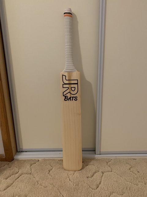

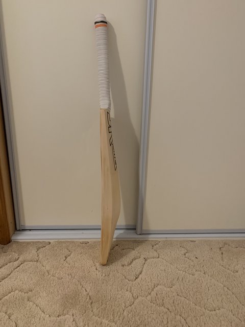

This is the first bat I ever attempted. Massive shape, mainly due to my unwillingness to mess it up. Spent a while on it getting used to the tools. Came in at 2.14. I wish I had more photos of it.

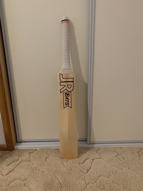

This is my match bat. I just finished giving it a sand in prep for the new season (if we are able to)
Specs:
Mid-low middle
38mm Edge
64mm Spine
14mm Shoulders
22mm Toe
Very full shape
2lbs 10.5oz
This is a bat I just made up for a friend. Very full shape. Duckbill toe with what I think is a longish middle.

Good job, well done. Putting photos on here is a bit of a nightmare though there are guides if you search for them.
I use postimages.org them just copy the ‘thumbnail for forums’ and paste it into the forum post.

Very nice, particularly for early efforts.

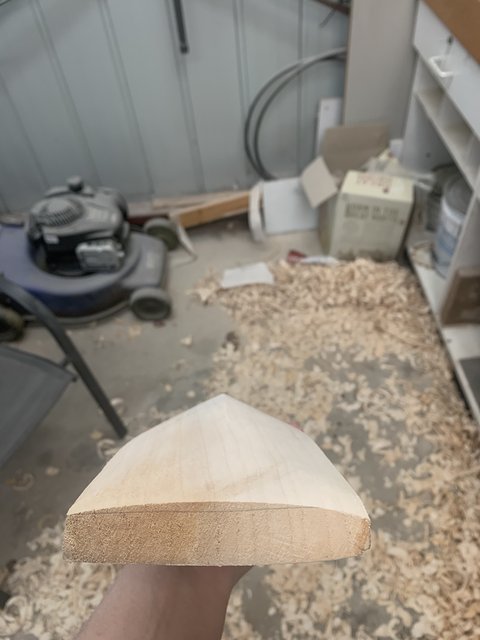

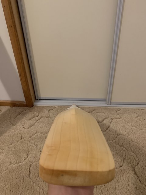

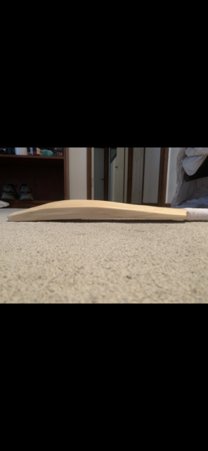

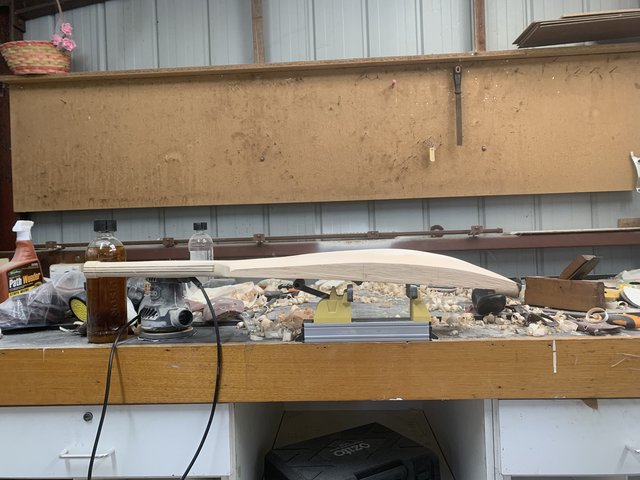

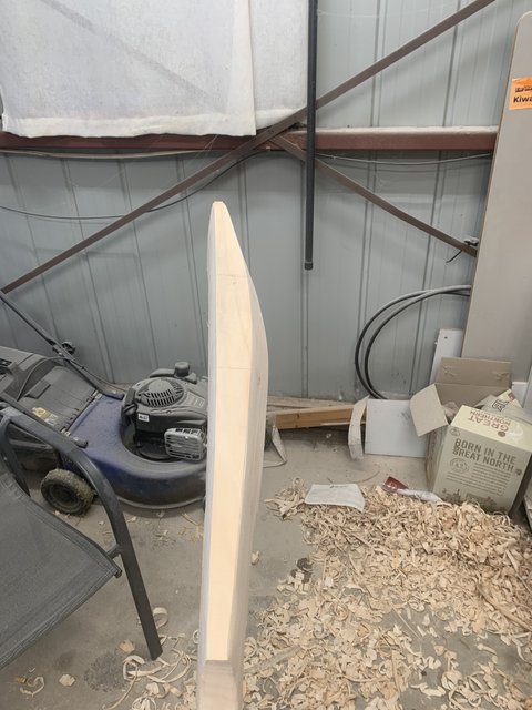

I had another two up on the bench earlier today.
The top one (with 3 photos) is a G1, 38mm edge and a 65mm spine. Spine runs nearly all the way through the toe. Current state is 2.11.
The bottom ones players, 40mm edge and 71mm spine it was finished at 2.13. Bit of an odd shape, the inspiration was the b3 beluga. We had to tinker with the shape abit, but the customer is stoked on the outcome.

Top work mate, glad you're enjoying it.

Tidy, strong hint of Kookaburra Menace on that one.

Good efforts mate,
Couple of tips that have helped me, if you draw a straight line across the toe from the top corner to the other top corner, that will make sure your edges are level at the toe.
Then the other suggestion would be to draw on the rough shape of the edges you want either using a template bat, or by placing lots of dots and then joining them up, will allow you to keep the edges nice and even too.

@scholzee - both profiles look good.

Been awhile since I’ve posted. Been lurking but haven’t had the opportunity to shape anything. Had some sticks come in over the past week and had the opportunity to shape these ones up. I feel as tho I’m slowly getting alittle more fluent with my shapes. All in good fun tho. Both feel amazing in the hands and seem to be a absolute weapons.
2lbs 12oz
Double grip for thicker handle
38mm Edge
68mm Spine
15mm Shoulder
20mm Toe
Full profile
Slight duckbill

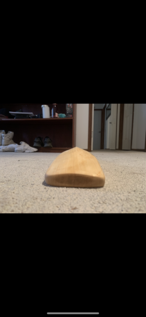

Had another one up on the bench this afternoon.
39mm Edge
69mm Spine
22mm Toe
2.10-2.11
Mid to low middle
Isn’t completely finished, only gone through one sanding stage but this bat looks and feels amazing.
