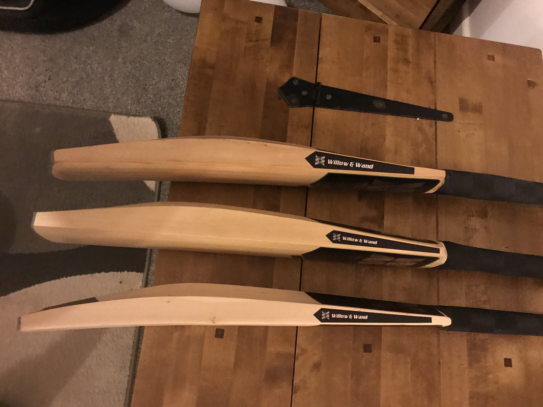

A few more pics of the most recent one Iv shapes up before I applied the stickers and grip.
This is available should anyone be interested.

Nice looking shape that!
Re: Soulman’s sticks
« Reply #81 on: December 04, 2020, 07:40:51 AM »
Thanks mate allows to make a slightly lighter bat with a little wider removed but still maintains a fairly full shape

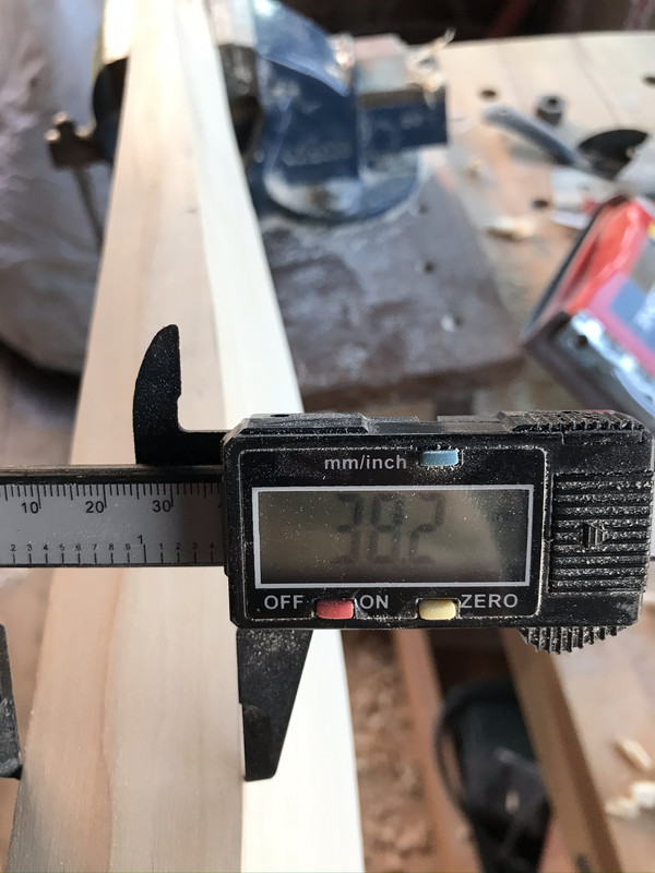

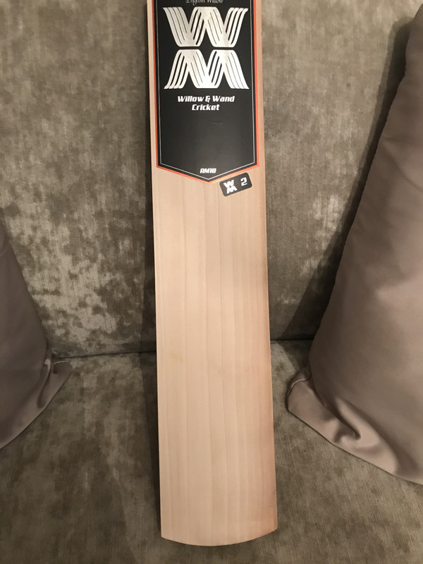

Finally finished this one off last night. AM18 shape 1/2 inch shorter blade.
Specs
Grade 2 English Willow all sapwood
38.2mm edge
20mm toe edge with 28mm centre of toe
14mm shoulder edge
Totally full profile
Oval handle medium thickness with GM Dynamic grips I use on this model as colour goes with sticker design.
Not the best at pictures but overall very pleased with this one and the performance is superb. If anyone is interested in this particular bat drop me a PM.
As always any comments or feedback welcome.

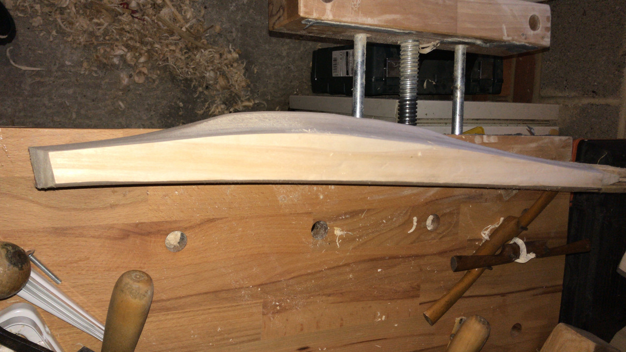

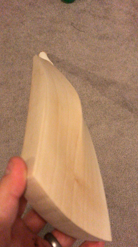

Have had a little break from the forum of late whilst I was moving house and a few others bits and pieces going on but thought I’d share my first bat of 2021. Been playing around a little with the shapes to get some more distinction within the 3 stock shapes I make.
This is the SL06 which Iv amended slightly to remove some weight from the top third of the blade a bit like the LW ultra to help keep the size of bats that people are always asking for and also to stand out a little from the MH85 which is the other full length blade option.
Currently also building the new workshop in the garage with a partition wall and benches the length of back wall and down the side of the section Iv allowed myself for the workshop.
As always any fen back appreciated
Grade 1
Requested weight of 2.10 and this is after the first initial shaping.

Very nice Chris, looks a good shape that, plenty of meat in the toe as well by the looks of it :-)

Good work mate. Shoulders definitely there now! 👍
Thank you for the feedback and yes i do try and leave as much wood as possible in the toe of the bat as possible to allow as much protection as possible. Still the area that i see the most damage to a bat on my own and also refurbs etc.
Glad you like the new amended shape as well
