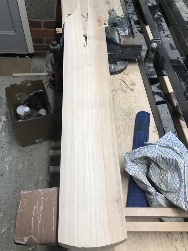

Firstly finished off this G1 for a lad at our club who is skipper of our first team this season. 2lb 10oz once I add the grip. This is a SL06 but he isn’t a fan of a large duckbill so this is more of a hybrid with a small duckbill and the spine subtly dropping into the toe.
Thin shoulders and the bulk of the swell in the middle of the bat. Copied the bulk area from his old GN Select.

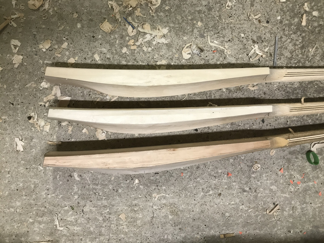

Next up this evening was the initial shaping of these 3 SL06 profile shapes all from orders in the past week. Two of these are G2 and one is a G3. I’ll share more of these in the coming days.

Hi Chris, how does that above G1 differ from the G3 you made for yourself? The above cleft has heartwood and spec but is a grade 1? I would be a little disappointed to receive that as a G1

Hi @e4sby this is a G1 on the basis of multiple straight grains and overall blemish free blade. This is a G1 as bought directly as a G1 cleft.
The one I made for myself has 5/6 grains from memory, cats paws or mable effect in the playing area and multiple specs and pin knots. Either way both are superb performing sticks

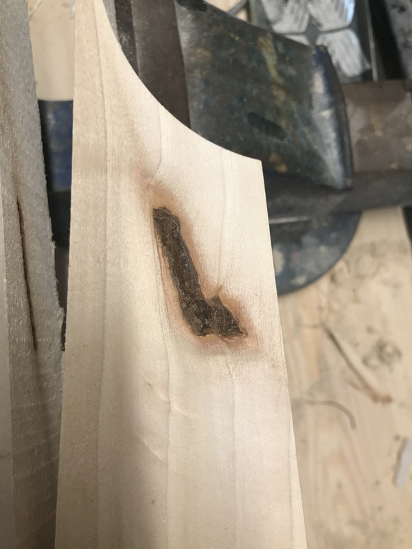

This is a G1 Cleft that unfortunately when it was machines revealed a nasty knot on the rear of the bat. It will be fully covered by the stickers but is unfortunate on a lovely piece of timber.
It’s also not the lightest cleft at 3lb 2oz before any shaping but if someone wants a me down weight bat I’m happy to offer in my SL06 profile for £150 delivered in the U.K.

Very generous offer that I'm sure someone will snap up. But could you not drop the shoulders and remove the knot that way. LH SB set up?

@Kez I possibly could but it would be a very big drop and in my opinion these shaped bats don’t sell very well so I’d rather just stick to offering a stock shape to be honest.

Such a shame and I guess it must be a bit like opening a Kinder surprise egg once you start machining a cleft! You can't get much further away from the playing area that's for sure.

That’s very honest of you. Some would have put stickers over it and sold it as a G1.
